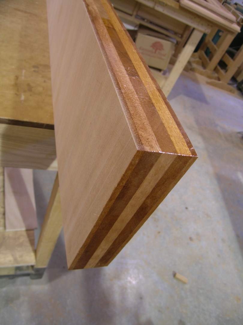

I have some 42" doors that will have full width panels about 30" wide. I am going to make them with a center core of 1/4" solid with grain running 90 degrees to two 3/4" plies running vertically. Then a cross band of 1/16" veneer running horizontally. Then faces of 1/16" veneer vertically. A 7 ply panel that is stable. Probably use plastic resin for the veneers, or polyurethane. The panels will raise to fit into a 3/4" plow.

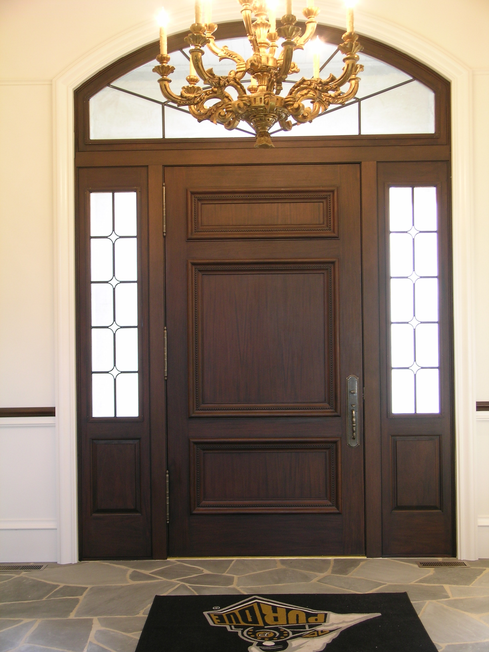

Photos here are of a 5 ply 36" wide flat panel that went into a 3" x 48" x 120" thick door. After 7 years, they look fine. Glue joints are all tight, but I can see them on the exterior side. South facing, not as diligent in maintenance of the Sikkens as I would like.

The panel in the photo is sealed with West epoxy on all the edges. It sits in a frame with large bolection moldings on both sides, and was not glued in place, but was sealed with RTV silicone. A stable panel could be glued in place, but never removed if there were serious problems. This one was given an 1/8" all around.
When doing the 7 ply panels, there are face veneers and crossbands, all 1/16" thick, and the center ply is solid wood, same species, about 1/2" thick. No solid rim mitered around. The panels get a 3/4" tongue into the frame plow, so the raise shows nothing much except a slight line at the panel face from the cross bands.

I used to do a three ply panel with a center core of 1/4" ply, and thick faces - 1/2" to 3/4". Some of the exterior side glue joints tried to open, but there were never any call backs. Not quite by the rules, but they worked - I think. I got away from them during a purist phase when I reasoned that solid wood was fine. Once the panels split, the purist in me is driven back into the shadows.
I would say that more plies are more stable - look at commercial ply.
I know the Gorilla glue for veneer faces is not the first choice for many, but I like the penetration, the spreading, the adhesion and the workability. It is a 'solvent based' glue, so little to no water. It also presses well. Plastic resin must have 70 plus temps, and I like things about 62. Epoxy is good for lots of things, but back when we were making wood tops every day with epoxy, we found out that it must have a thick glue line and low clamp pressure or the joints can starve and open. Hard to do with all those strips of wood. I used to use Resorcinol in the 70's, and keep threatening to get back into it. It is probably the best choice on characteristics, but it also must have higher temps, likes pressure - that a vacuum bag may not deliver - and has that purple line.
