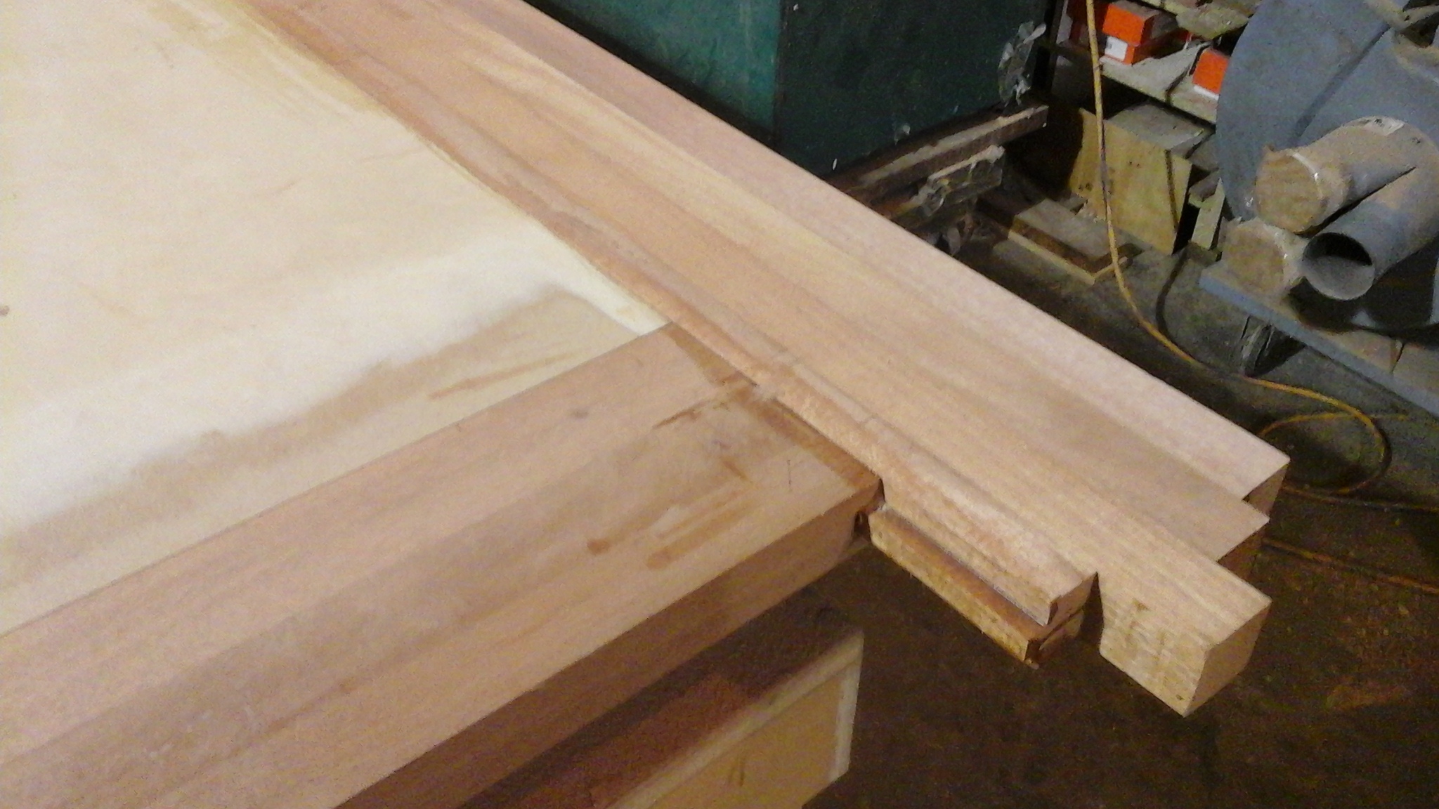

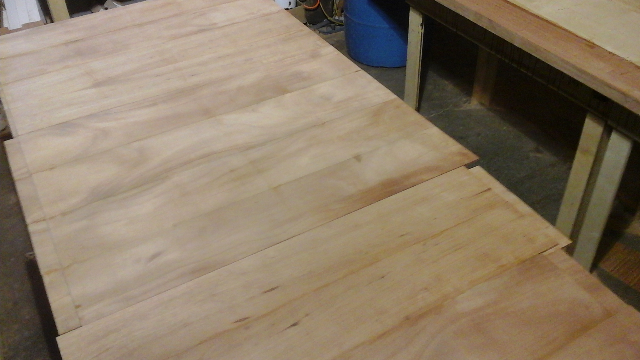

my latest series of door's have been engineered slab cores with a stave 1 3/4 x 6 frame tongue and grooved into slab.

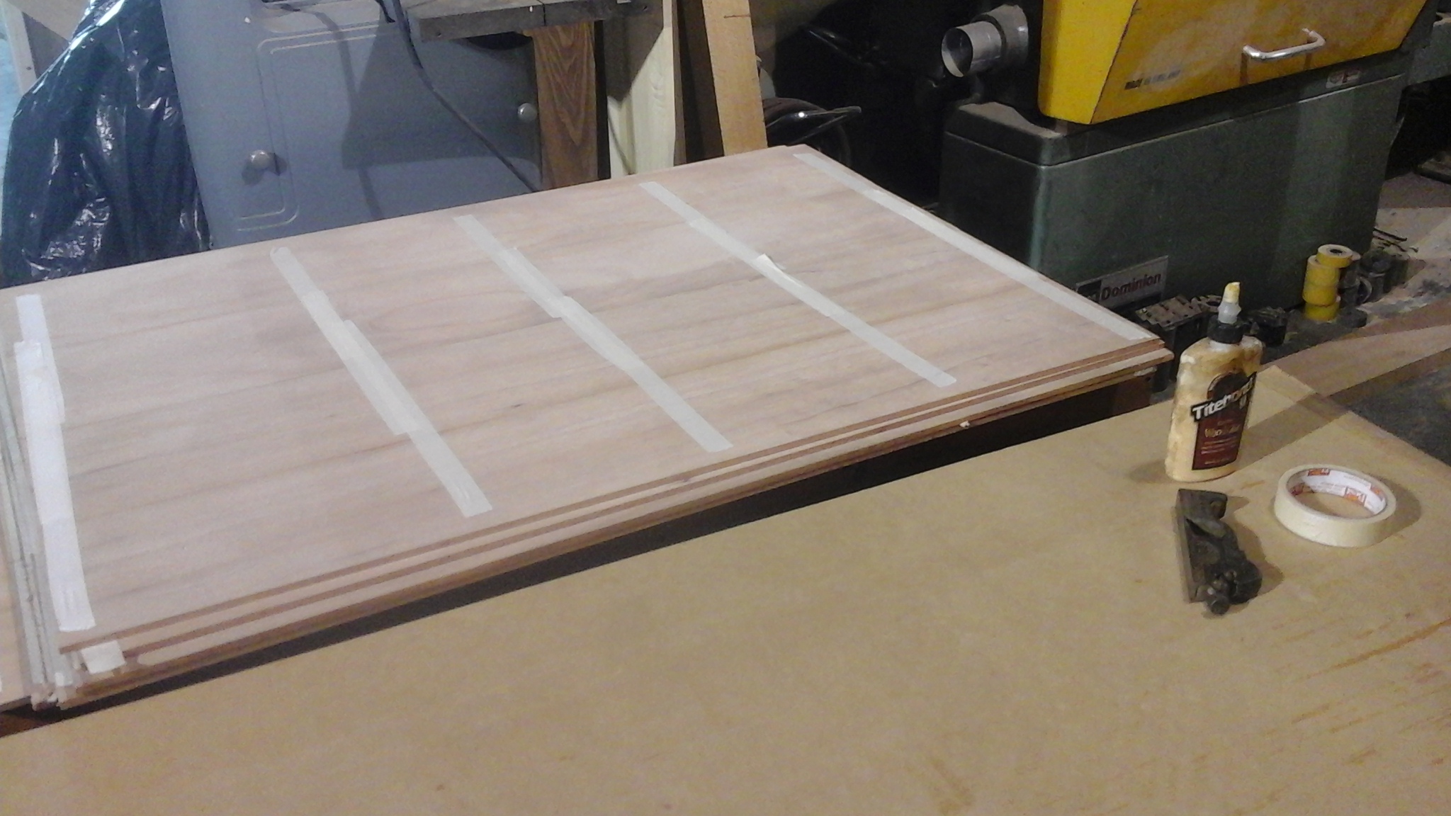

i remain afraid of delamination of factory substrates and my customers like the look so i continue to use shop sawn 1/4 veneers. i rip the veneer planks to more or less 8 inches and use off falls for my 1 3/4 frame around slab. i can slice the 8/4 planks in 4 1/2 - planks. i joint ,plane, stack, cover and let sit. being careful to mark .
when ready to veneer, i plane to 5/16 slowly, then drum sand 80, 100 g.
sequenced,matched, jointed, shot by hand on gluing bench , and glued at more or less 32 inch wide with tb2.
i continue to use moisture cured urethane flooring cement for the veneers, but not edge gluing the panels. and pressing.
after a few years in the field my contractors seem to prefer this method and look .
have had no splits or cracks on veneered panels but the panel joints do open and close with humidity which is dramatic here in sw fl. they tell me no more than could be filled with a crayon. the panels move but the bond seems to hold and doors havent warped.
i have been tempted to bond veneers with tb3,plastic resin, or epoxy but I'm afraid that with adhesive rigid somrthing will give. warp,crack,delam etc. same thing with trying medite or doorskin substrate and taking veneers to 1/8. again I'm not saying this is the right way and i welcome any and all input. always trying to make a better door .
