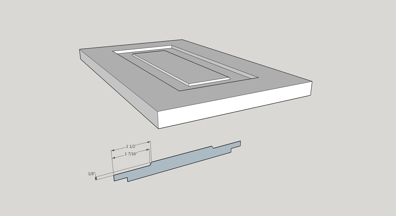

I've asked this in the solid wood machining forum, but thought the pattern might be familiar to someone here. Does anyone know where I can find this panel cutter in stock with or without back cutter? It used to be a very common profile in this part of the country (midwest)100+ years ago, you see it in all the old houses on passage doors. I'm building cabinets for an old home and we want to use it for our cabinet door panels to match the passage doors. I had a response in the other forum to use the table saw, but the multiple cuts, huge amount of sanding and inability to do the curved panels make that unworkable. Thanks--Alex

There is always the table saw and a routertable with a vbit and a guide method
depending on how many and the value you could have the cutter made and that is not difficult.

Alex:
See if this helps.
TonyF
http://www.infinitytools.com/raised-panel-door-shaper-cutters-5673

Steve Member
Check out Amana SC506
http://www.amanatool.com/sc506-carbide-tipped-3-wing-traditional-with-radius-raise
d-panel-13-deg-x-13-64-radius-x-5-1-2-dia-x-5-8-x-1-1-1-4-bore-for-3-4-material.h
tml

door shop guy
Neither the tablesaw, infinity cutter or the Amana cutter is an exact match. It all depends on how particular your customer is. I always get small differences in profiles like this approved by sample and in writing by the customer. For exact matches i always have Freeborn make a custom cutter. I have found Freeborn is the highest quality for me.

door shop guy
Just remembered a company called Nordic Saw and Tool...a LOT of profiles. Check their panel profile #1018. I believe from what i can see that it is exact match.

Steve
Not to be overlooked depending on your location, is a good carbide shop. I happen to be in the middle of a major metro area and have the good fortune of having an A#1 carbide shop. They offer the best kept local secret of being able to grind anything you might need; perhaps you might have one with a little local search. Good luck.

door shop guy
Actually that Nordic cutter i listed goes up at a bevel and Alex's drawing shows it as a straight cut.
