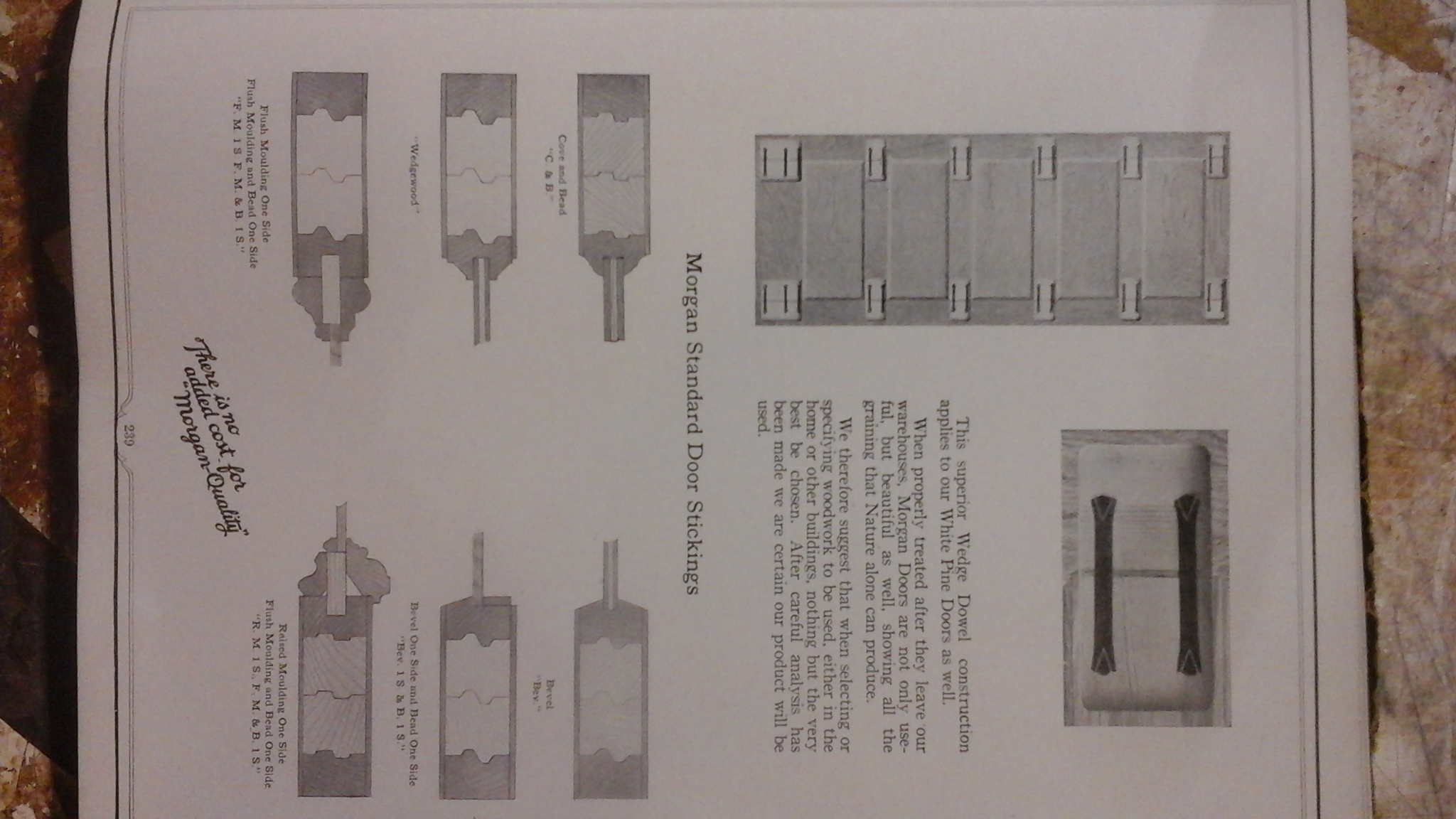

this from my grandmothers wish book circa 1923. morgan milkwork chicago ,oshkosh, and baltimore
11/1/16       #2: doors in 1923 ...
TonyF
Looks like the applied bead molding on the bottom of the panel on the bottom right door on page 239 is asking for trouble.
