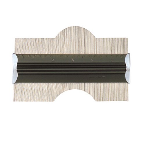

2/1/17       #4: How to copy a museum molding? ...
Ken Member
What about a profile contour gauge?

2/1/17       #7: How to copy a museum molding? ...
Chuck Rankin
I have both 6" and 12" long contour guages available.

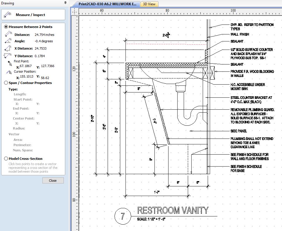

2/3/17       #10: How to copy a museum molding? ...
james e mcgrew Member
You can see the accuracy in this pic using my cad measure tool, i cut radius and odd parts real quick this way and the fit is perfect
