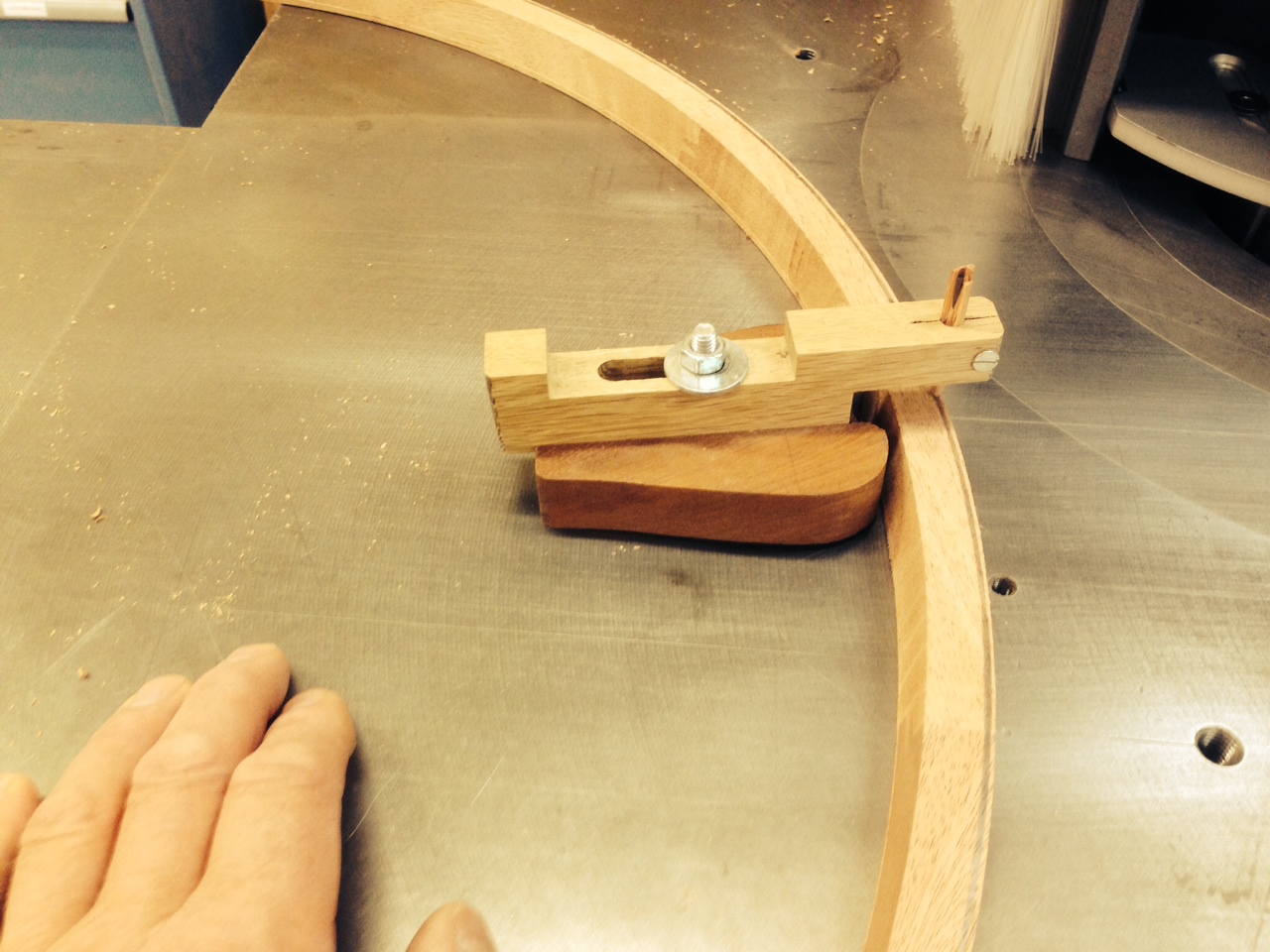

Years ago we built a lot of doors with oval glass held by a narrow 1 1/2" or so wide raised moulding in a panel. The jigs were made with a router trammel with X and Y grooves cut into the jig blank. We discovered this non parallel issue even on the narrow moulding.
Our solution was to do the inside jig with the trammel for inside shaping. Outside curves are easy and accurate with the bandsaw and edge sanding to a line. We made this marking device in the picture and still do the outsides of our curve moldings this way. If additional shaping for rebates needs to be done we just use a dead collar or bearing.
The panel, usually 1 3/4" or so thick also needed a inside cut. To make this parallel we would use the same jig as the inside moulding only with a smaller diameter bearing for the required distance. We now have a adjustable dead collar for this but have not made a oval door in years.
