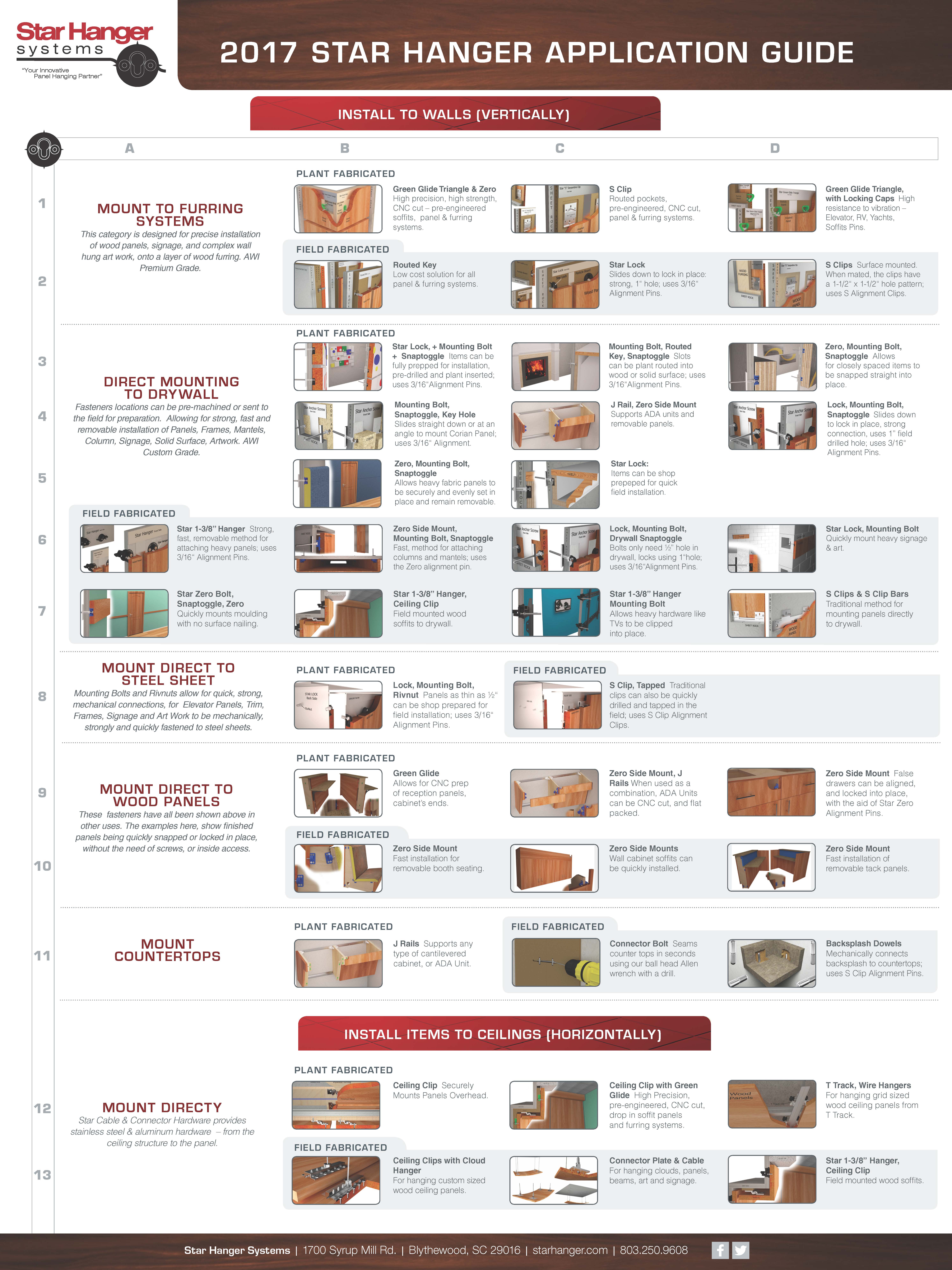

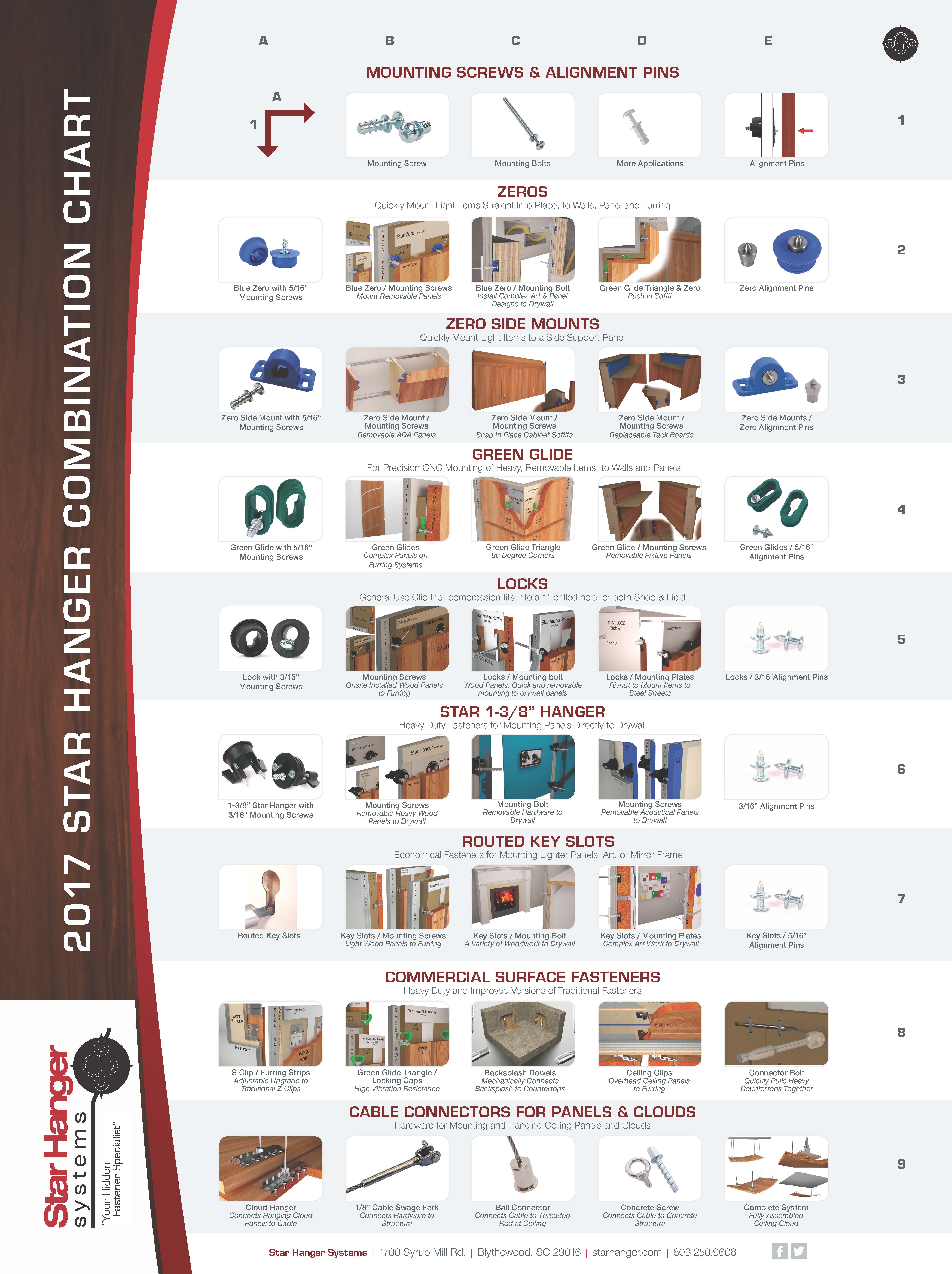

james e mcgrew Member
We use the heck out of them
View higher quality, full size image (5400 X 7224)
View higher quality, full size image (5976 X 7968)
