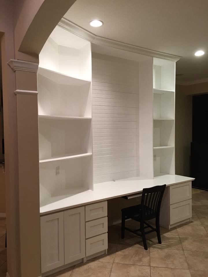

I bid this job $1600.00 how much would you charge for this?

First off I hope your number of $ 1,600 was a typo.
Secondly , with the risk of sounding reckless....You should be able to answer this question your self. Are you a hobbyist and this is your first job?
-How many hours did it take you? Did you get your hourly rate?
-How much was material
Did your labor costs and material come in at or under $1,600?
That unit if your really priced it was grossly under priced no mater what region you are in.
6/29/17       #4: How much did I under bid ...
Around $8,000, but I get underbid by half all the time.
How did you come up with $1600.00?
6/29/17       #6: How much did I under bid ...
Leo G
About $5500.00

Mark B Member
Ton of hardware and detail variables but Im with everyone else, if you built and installed this for 1600.00 you lost your shirt.

Michael Greco  Member
Website: http://www.michaelgrecocabinetmaker.com/
$1600 has got to be pretty close to the material cost, unless you built it from cardboard.
That is Ikea pricing.
I see in-cabinet lighting, which could be an easy $300 add on. As others have said, lots of variables.
Did you provide design or drawing services? Samples? Hardware selection?
How much did you underbid? Maybe 300-400%.
Take it as a lesson well learned and paid for.
Up your game on the next project.

BTW, it looks like nice clean work. Great effort, regardless of the price. And you should know that.

Was $1,600 for the install? As mentioned, if the job is done, you know how much money you lost. You need to attend a small business class so you understand overhead and expenses in relation to estimating. If you are fishing for estimating help, you already got that.

When pricing jobs we must consider the geographic area that the job is in. I operate a shop in north east Georgia and my brother operates a business on the coast of SC near Myrtle Beach. We build very similar cabinets but he will get at least 3 times the price of what I would get on the same type job. His overhead in that area is much greater than mine. The overall profit will be very similar. In my area, the estimated cost of materials to build your project would be around $900 - $1000. I would have priced in the area of $2500 - $2750.

The only problem with this job is it looks very well done and will lead to lots of referrals with the expectation of a similar price.
It might be nice to explain to the owner that you enjoyed working with them but you are just starting out and underpriced the project and would appreciate referrals but won't be able to give future customers as good of a deal as you gave them.

Without all the details, it is hard to price this, but it appears to be around $4,500 plus installation. I would bid installation for two guys a full day and one day for one person to put on handles, adjust doors etc. We bid $10 per ft to install crown. It appears that you have about 12' of crown.
We bid our installation at $45 per hour per person. Installation would be $1,080.
Another way I look at bidding a job like this is I try to estimate my materials and I do not want my materials to exceed 28%. If I calculate my material costs, I divide my materials by .28 and I compare that number to my bid.
Items like the valance over the center desk area, I bid at $300. I also see you have a keyboard. I double my cost for the keyboard. Painted finishes are usually bid about 15% higher than either a stain or natural finish.

including the finishing? i wouldn't finish that piece for $1600, much less build it for that. in my area, i wouldn't touch that for much less than $7500.

We would be around $8000 , with 1" frames and doors solid maple drawers , paint and installation . I'm in lower Fairfield county Ct. I don't think $1600 covers material.

P.S. The image in the OP looks (to me) like a render rather than an actual photo.

I agree with you after taking a look. I still believe the OP is BS

After looking closely @ the photo, I don't think it is a rendering. Notice the door margins and the miss-alignment of the tiles. I find it hard to believe that even a garage shop would price at that level, so something is amiss!

Customer had this made and is arguing with the "cabinetmaker" over price, so though they would post his work here to get it valued.
I have to question the support the OP received for quality of work those look like 1/2 gaps between doors and drawer fronts
I think they are worth no more than was paid for them, if not a little less
