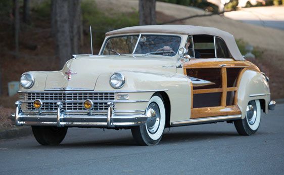

Not my woody, but a customer's. 1948 Chrysler Town & Country, convertible, just like the photo.
His car has Di Noc panels (3M product) instead of Mahogany, within the Ash frames. The older, better cars have wood, but Chrysler changed to plastic on some of their cars. A preview of the future.
My customer would like me to replace the plastic with wood. I do know this is basic frame and panel work (or I am really naive), but with curves in 3 dimensions. The trunk panels have a slight 3-D curve, convex, that should be able to be pressed.
One problem is how to manage the near crease in the upper door panels. Probably a 1" inside radius where it meets the ash. Some photos of the same model do show a 90 degree square joint there. I suspect this is for the wood paneled cars. However, the Ash frame is radiused, and I don't want to have to modify the Ash frames if I don't have to.
I will have others open things up from the other side, but will need to make forms, male and female.
Does anyone here have any experience with woody frame and panel work?
Will softening the veneers with glycerin et al help get them to bend as needed?
View higher quality, full size image (562 X 346)

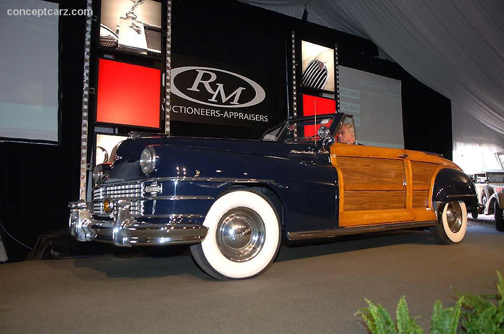

Nice car, is that the actual car in question? I am not enough of a car buff, but some of the 1948 Town and Country photos show that the upper front door panel is not quite as sharply delineated as the one in your photo, which makes me wonder if that is a difference between the wood panels and the plastic panels. The point at which the crease starts to flare out from the flat curved portion of the panel would give me pause, as I would fear buckling of the veneers, in trying to produce in veneers what it more easily done with something as formable as plastic.
My experience with glycerin only is to flatten previously non-flattened burls to make them usable in a vacuum press. It certainly makes them pliable, and I suppose that you could dry-form the veneers prior to pressing, but that crease.......
I will try to post a photo, but may not meet with success. I think I would research an actual wood paneled model and see what the actual differences are, if any, and if you can use a frame made for plastic panels on the wooden panels.
