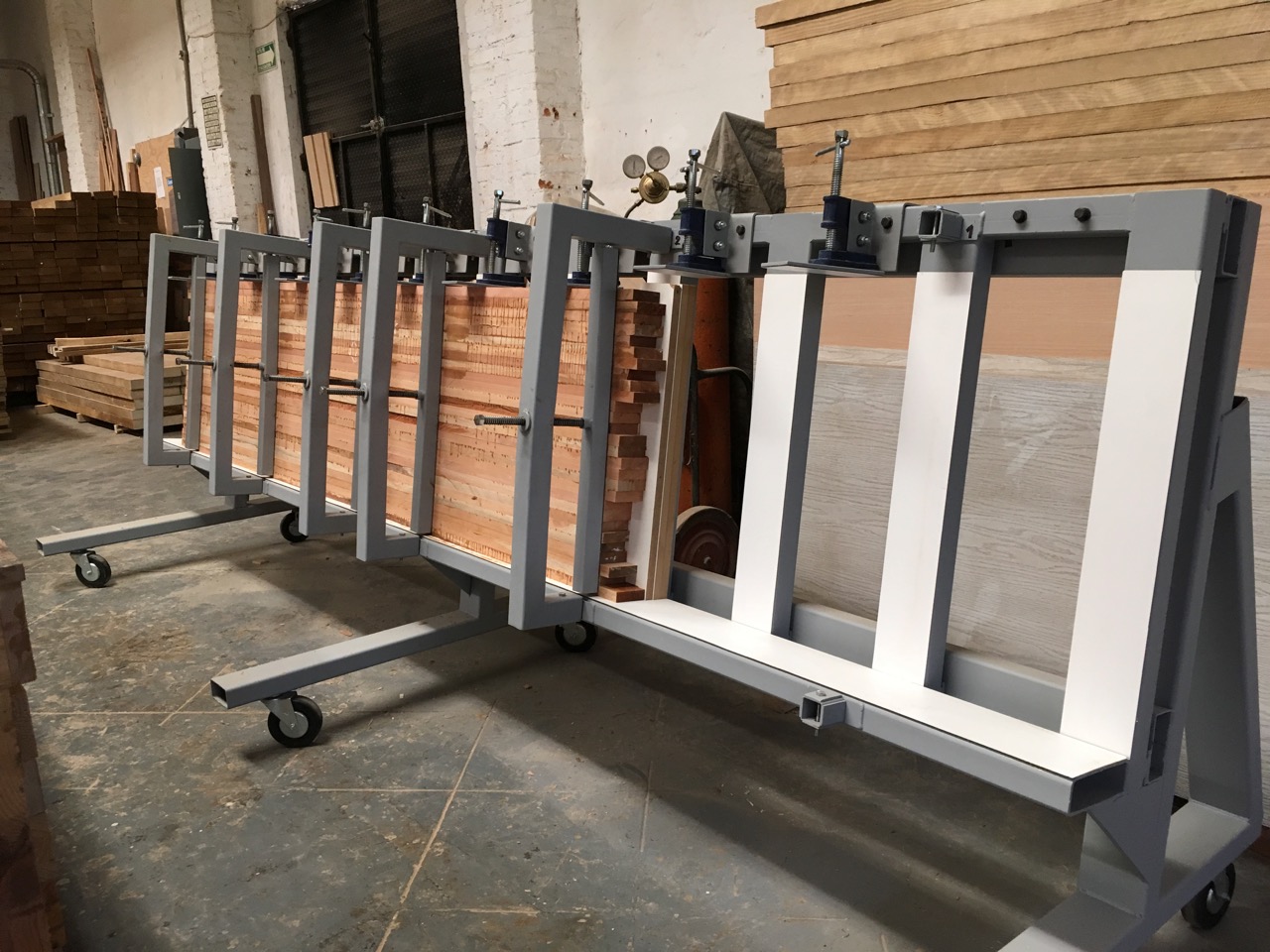

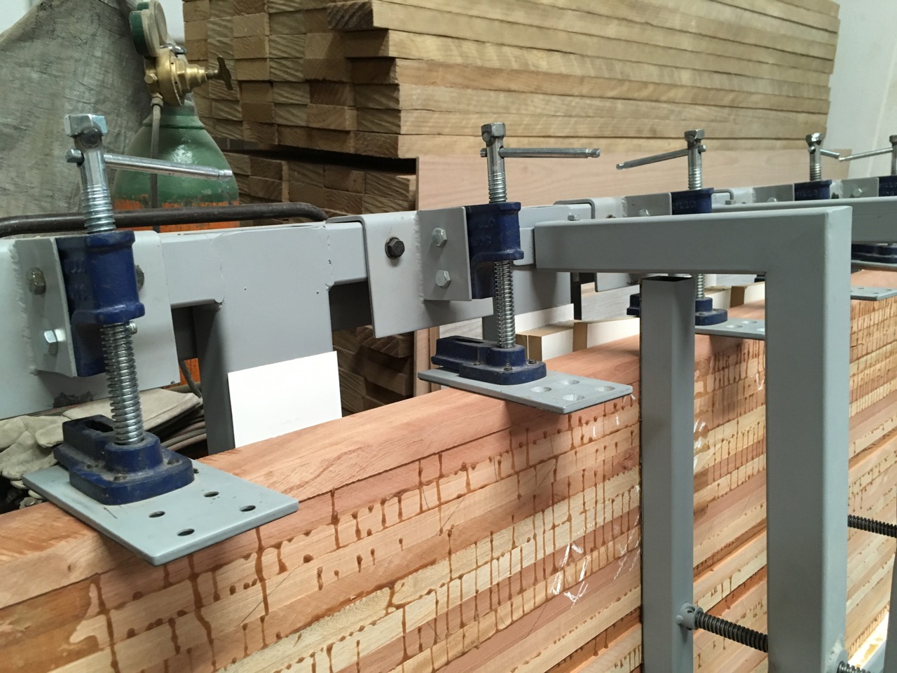

I thought I'd followup on my search for ideas on a press to laminate boards by showing what I've done so far.
It's a work in progress. We can laminate up to 12' long sticks. Wanting consistency, we're using a torque wrench at 25 ft lbs, probably about a full turn more than what you would do with a hand clamp.
As you can see, we have to beef up the tube steel clamps on the 'X' axis. It might be better to have two-points rather than a single in the middle, but a factor in the decision to keep it in the middle was reducing the open time of the Tite Bond III.
There are other changes that need to be made; it's not the end result of what we need, but it's a good starting point.
