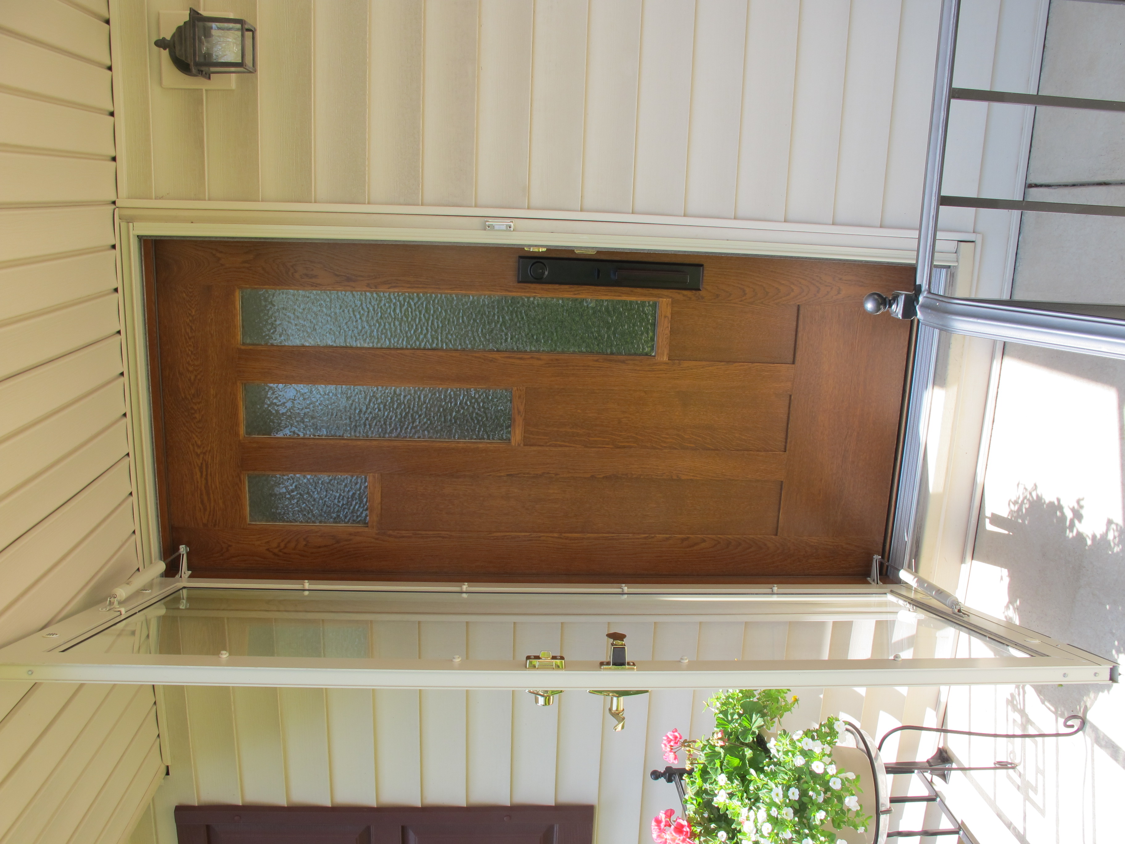

Last year I posted about a house door I had built/installed where the panels had cracked. There were more comments questioning my competence, which I tried to ignore, than ones trying to understand the root of the problem and how to resolve them. But in hopes of helping someone down the road faced with a similar situation I thought I'd post what I did to fix the problem.
The storm door is still on, but earlier this Spring I installed vents in it to let air pass between it and the house door. When that was done, I removed the house door and replaced the composite panels with separate solid rift/QS ones, WO on the outside, ash inside. I had to cut out and replace the lower rail in order to do that as the panels were captured in the frame. Not fun but the new one fits and looks perfect.
Finally, we are adding one of 3M's window films to the glass in the storm door to cut the solar heat gain and UV. Short of removing the storm door I've done all I can.

John Member
The updated door.

MarkB Member
Looks like a great recovery. Love the hardware. Nice work.

Thanks for the update. I think you have addressed it adequately, and the customer should be pleased. I like to use integral sticking when possible to allow easy rework if needed.
And.....now we wait. Find a reason to go back periodically to see how things age. None of us has too much trouble getting things right in 3 dimensions. It is that fourth dimension - time - that can trip us up and make for intense head scratching.
Thanks again.

David, I don't understand how integral sticking allows for easy rework. Please explain. Photos or sketches are always good, too, for those of us who are visual learners. Thanks.
