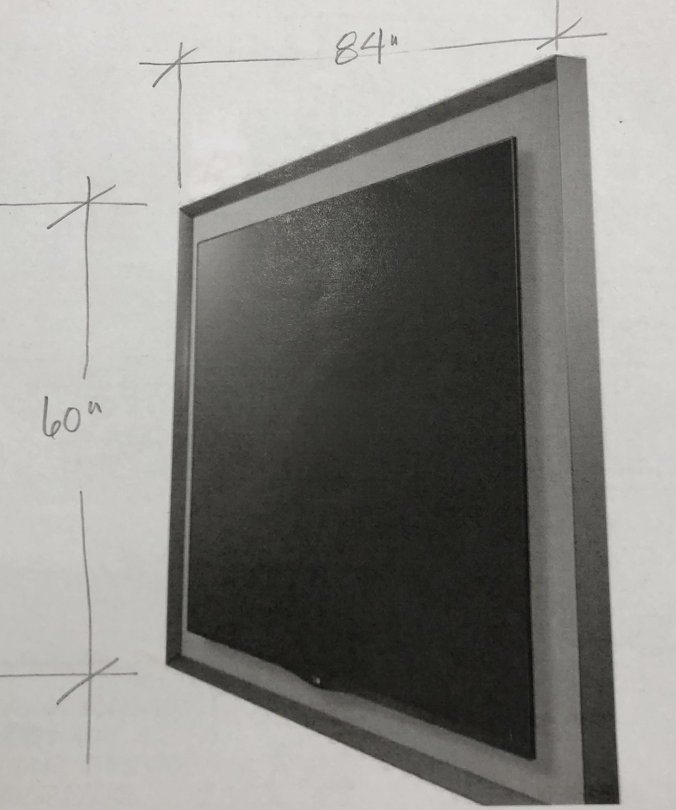

Not sure if this is the right forum but I thought this was the most likely place for this to happen.
I have a job that requires quartersawn W Oak plywood at 58" x 82". Neither one of my suppliers carries it. One says they could make it, but I only need one sheet...
So I am thinking about edge gluing. My thought was to use biscuits; re-dress the factory edges and maybe one biscuit per foot or so. I did think about T-G, but we don't have a "glue-joint" quality T-G set, ours are for flooring. However I would consider buying a set if necessary for this project.
This will not be structural, it's going to be part of a frame for a TV. The plywood will be attached to the wall, and the TV will be mounted in the center of it. There is a 1-1/2"w x 4"d D4S piece with rabbet at back for plywood that makes the "frame" around the TV.
However, I am concerned with the strength of the joint while handling it in-house, as well as during shipment (it will be going by LTL from VT to FL). I was thinking of screwing some 1x4 or so cross-wise to the joint on the back, maybe 4 or 5 of them.
Does this all seem reasonable? Any better ideas?
Pic from customer:

I think you are making it too complicated. The TV is going to cover most or all of the joint so cut a small chamfer on each side of the joint and use biscuits or a spline. Simple, fast and effective.

I do things like this often. I use what are called "Tite joint dog bone fasteners." I have a CNC router so it is easy for me to route into the back of the plywood. But, you can make a jig and use a router with a template guide. On TV cabinets like this, I do not put the joint in the center. They will probably need to cut holes in the center for cables.

After giving the customer a quote for the full plywood back they decided that a 5" wide strip around the edge made of solid wood would be fine...
It's what I would have recommended in the first place, as not only does it save that huge plywood panel, but now we can ship it knocked down by UPS and save them about $500 in crating/freight costs. But of course they wanted what they wanted. Until they found out how much it was going to cost.
