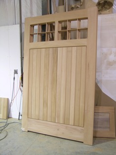

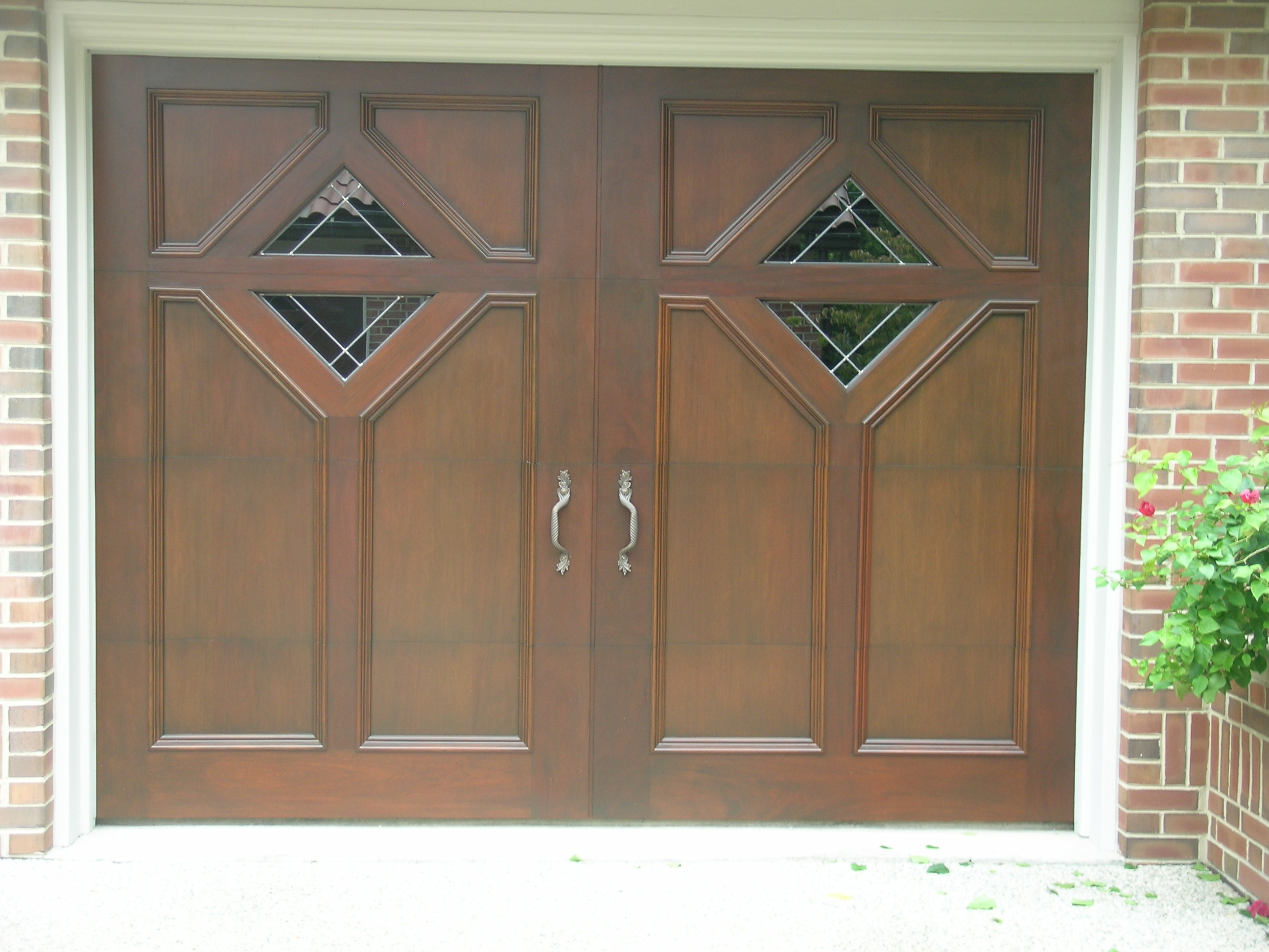

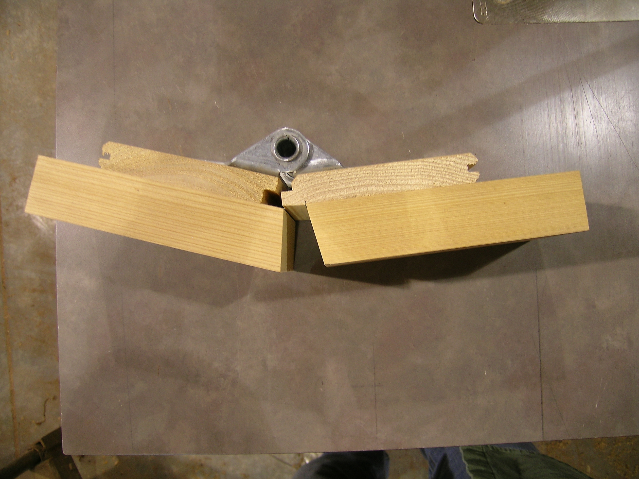

David R Sochar  Member
Overhead or 'carriage house'? Overhead requires different guidelines than side hinged, but no matter what - Why not make your doors frame and panel, like all the other doors out there?
Frame and panel with the ply panel (single, or double with foam in between) is as versatile as ever. Worst comes to worse - the preferred design does not align with the necessary joint - and you will have to have the Main frame there for that part, with the secondary - the visual frame- out front, showing what it looks like.
7/19/18       #3: Garage doors?? ...
And some photos.......
