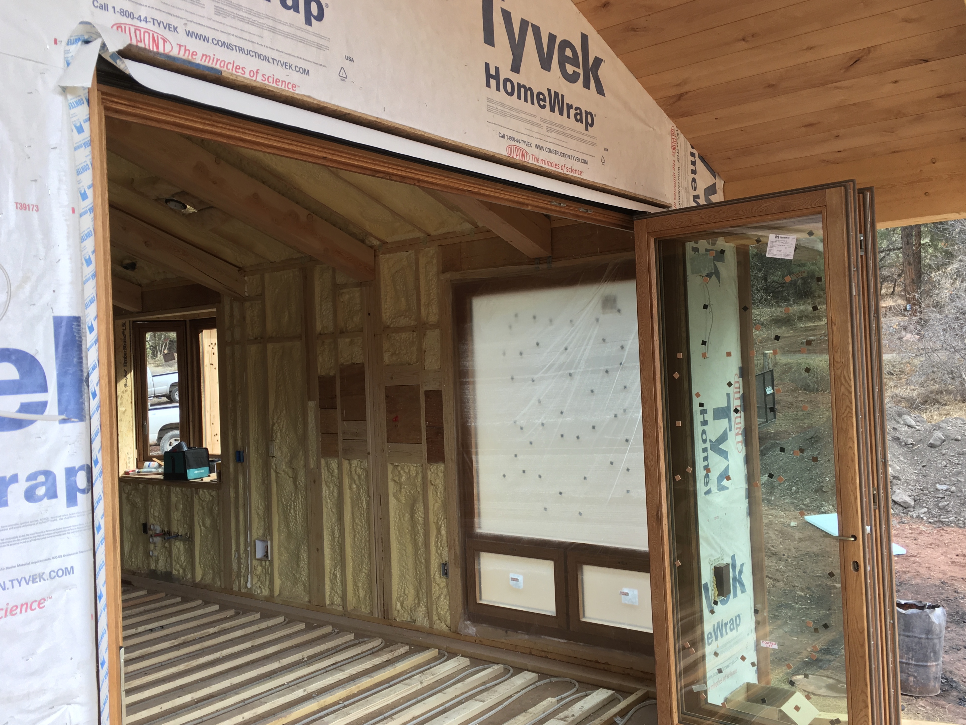

Pictures are AGB multipoints in a fold slide Euro door.

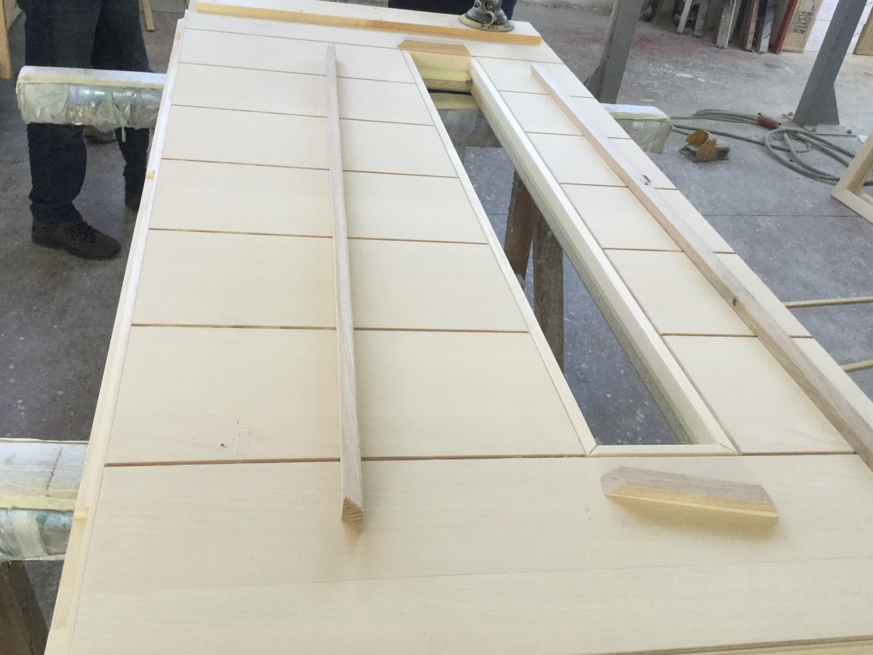

We usually are doing stile and rail doors and use the same 3 layer solid construction as our windows. The Europeans do not favor stile and rail construction for entrance doors and have a lot of unique core material at their disposal to make built up doors. Most every shop even the smallest has a hot press also.

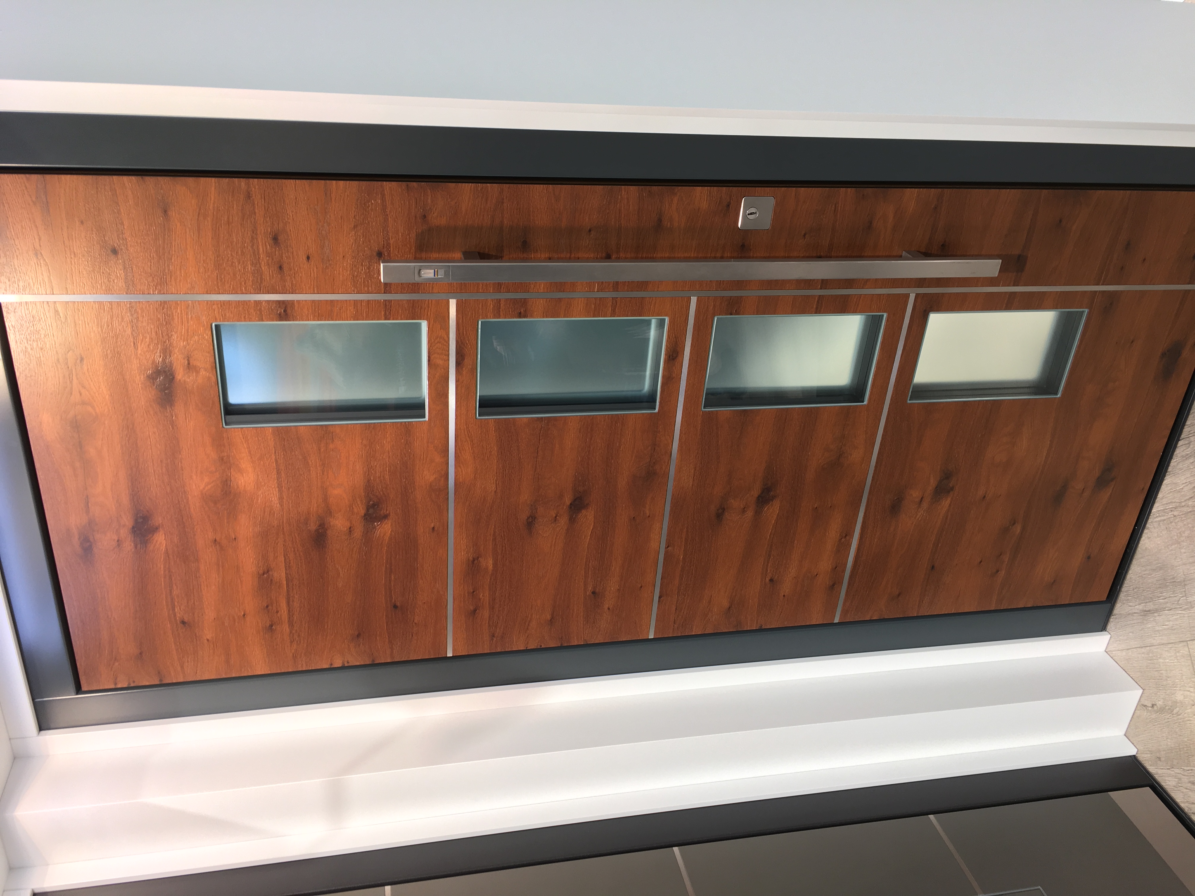

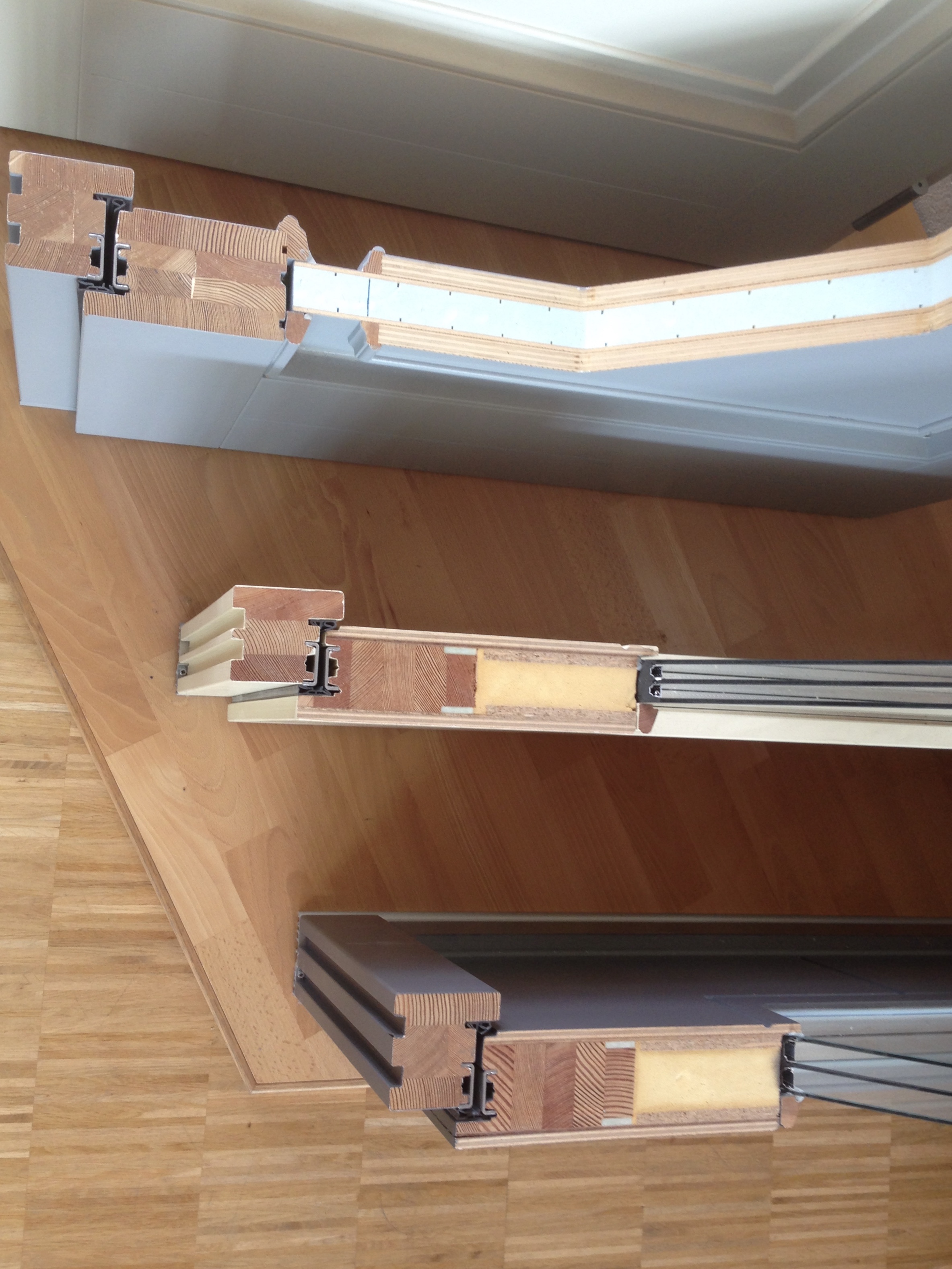

Here are some pictures from European shops showing core samples, door in progress and a finished door. Notice the door frame is the standard 3 layer solid construction.

Some of those stiles look like those made by Holz Hogger. I scratched my head for a long time trying to understand how those thin pieces of aluminum would help keep the stiles stable. It finally occurred to me that they must act like a torsion box - if a stile tries to bow the outside layer of aluminum will go in tension and help resist any movement. Seems to make sense from that perspective though I have no clue if it actually works in practice. In any case, I doubt I will be trying that idea any time soon. I'm hoping the laminated construction combined with a multipoint lock will keep everything straight and true.

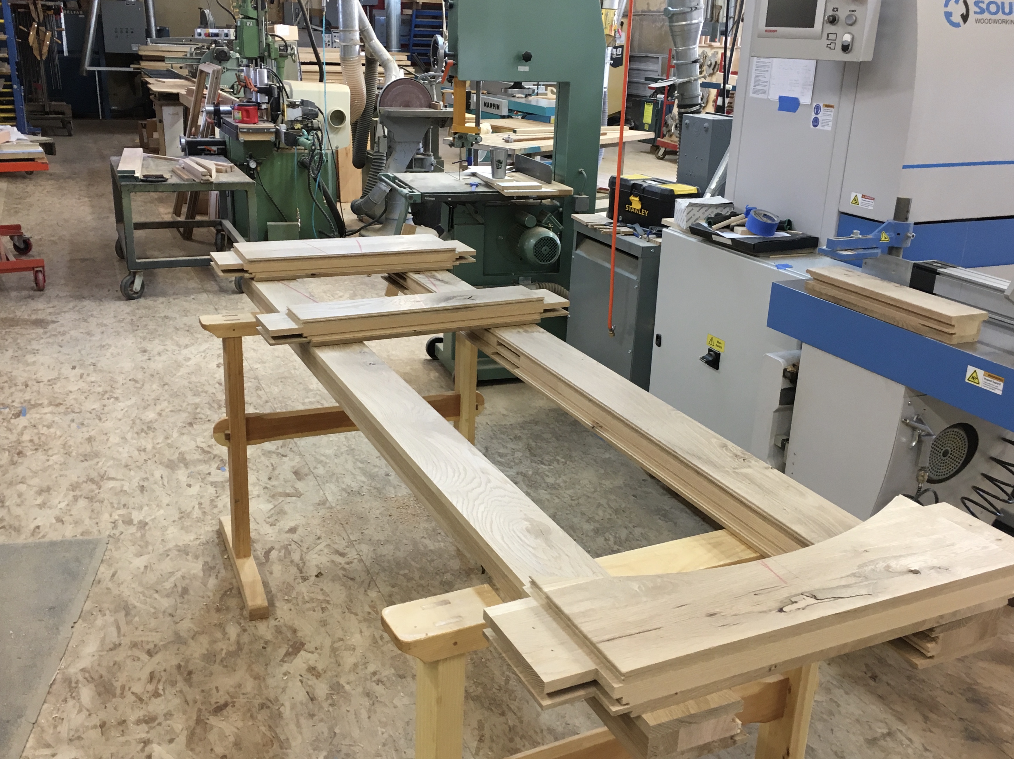

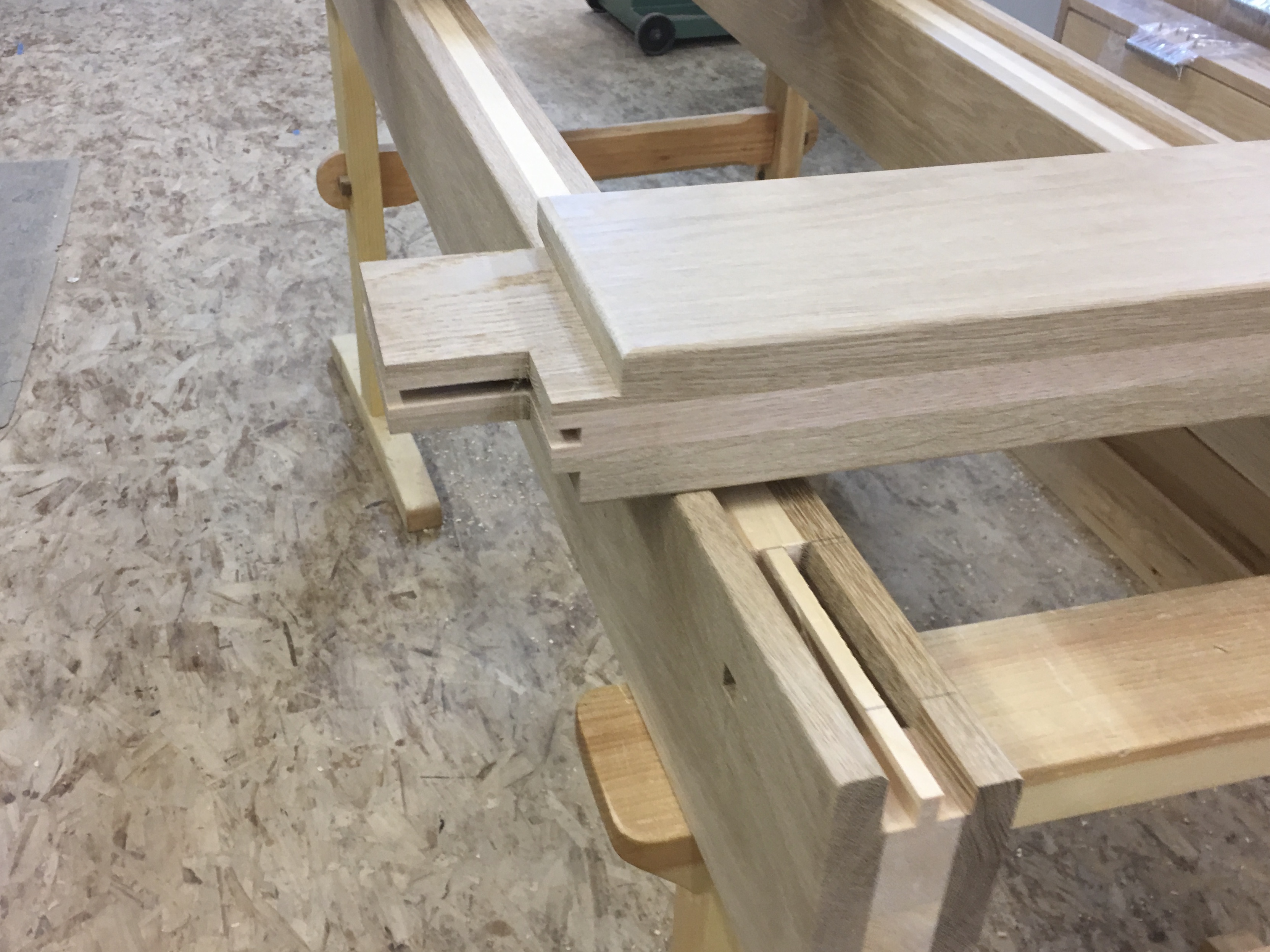

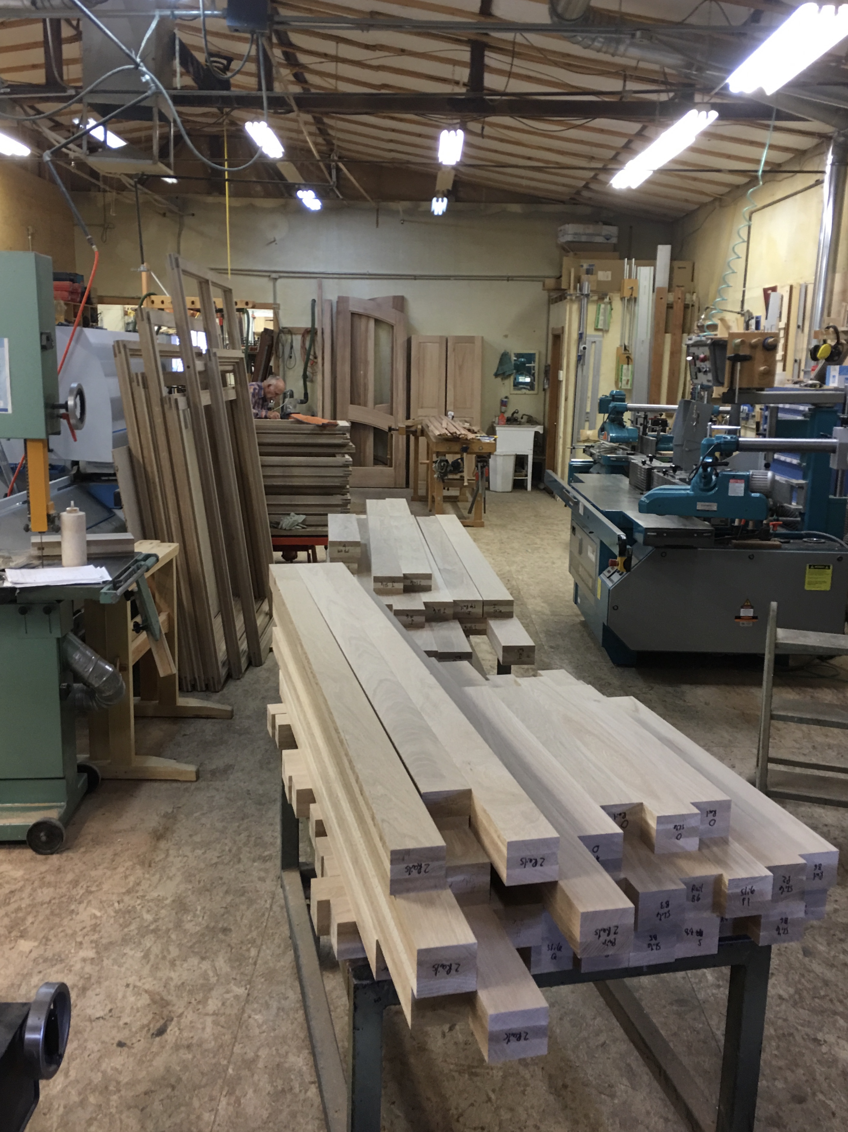

There are several companies in Europe making these cores. I talked to a couple at length this year at Fenester Bau. I was more interested in how the thick veneers they apply to slab doors hold up. Different companies had their own method of constructing these but they all said thick veneer is not recommended if the door gets much sun or weather.
The 68 mm thick cores we make for entry doors are usually so straight it is hard to determine crown. These are usually 5 to 6” wide and that helps. Narrow stiles 4” or less in width that are typical for folding, sliding and French doors are more prone to a little bow. Good wood helps - white oak is good, we are doing a quartered white oak window and door job right now and it is super stable. Plain sawn oak and VG fir also. Some African Mahoganies you have to be careful.
The pictures show typical frame and window scantlings with grain opposed 3 layer construction, rustic white oak with a thicker core made of 6/4 oak ripped and turned. Made this way because the rustic only available in 4/4. And another white oak with a pine core. An effort to keep weight down.
