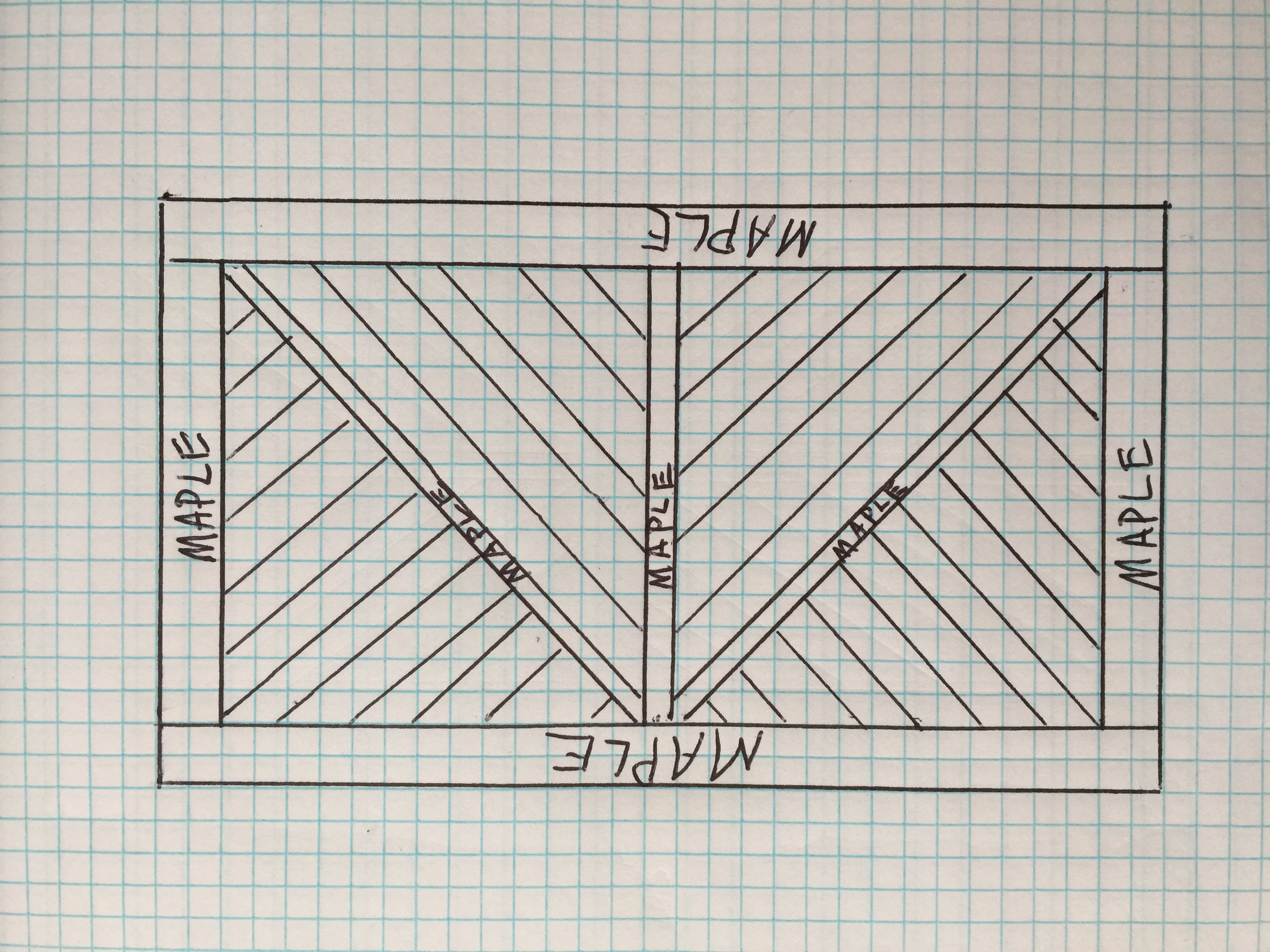

Would like experienced advice about the possibility of making a barn style door , that customer does not want rustic , but wants chevron style pattern, with mixed hardwoods that can be seen from back side ...
My thought, because of variety of grains and directions, would be to tongue & groove pattern boards and make them floating within separate panels ... similar to an exterior door with solid wood panels ...
Any advice ?

These "Barn Style Doors" that are so popular almost all mimic the most basic door joinery from the last 600 years of door making.
They are frame and panel doors, with a rigid joined frame that holds the size and shape. Mortise and tenon is the favored way to join these doors together. The panels are an infill of boards, usually tongue and grooved together. They can be set vertically, horizontally diagonally or mixed. The one thing they have in common is they fit into a plow in the stiles and rails, and are often glued on the ends to keep them in place.
If the T&G boards are 3/4" thick, they will fit nicely in a 1-3/4" stile or rail. Inner edges of the stiles and rails can be stop chamfered. If the doors go outside, there are methods that can be used to keep the ploughs from admitting rain water into the panel groove.
This means the multi-species extravaganza will be easily visible both sides.
Quick and dirty would be a nail gun, and no joinery. Just boards nailed to other boards.
