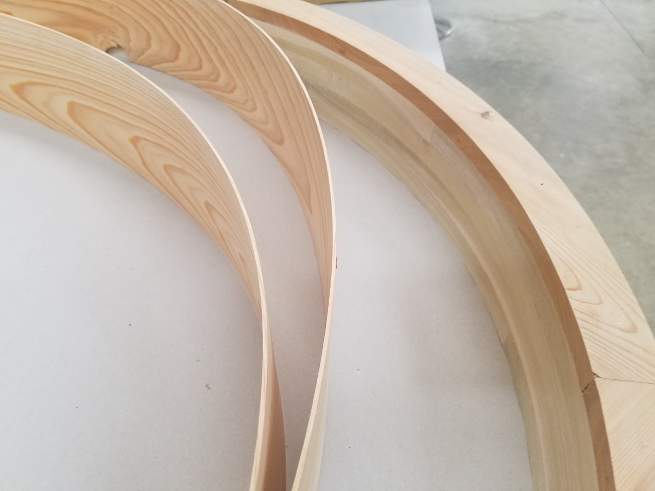

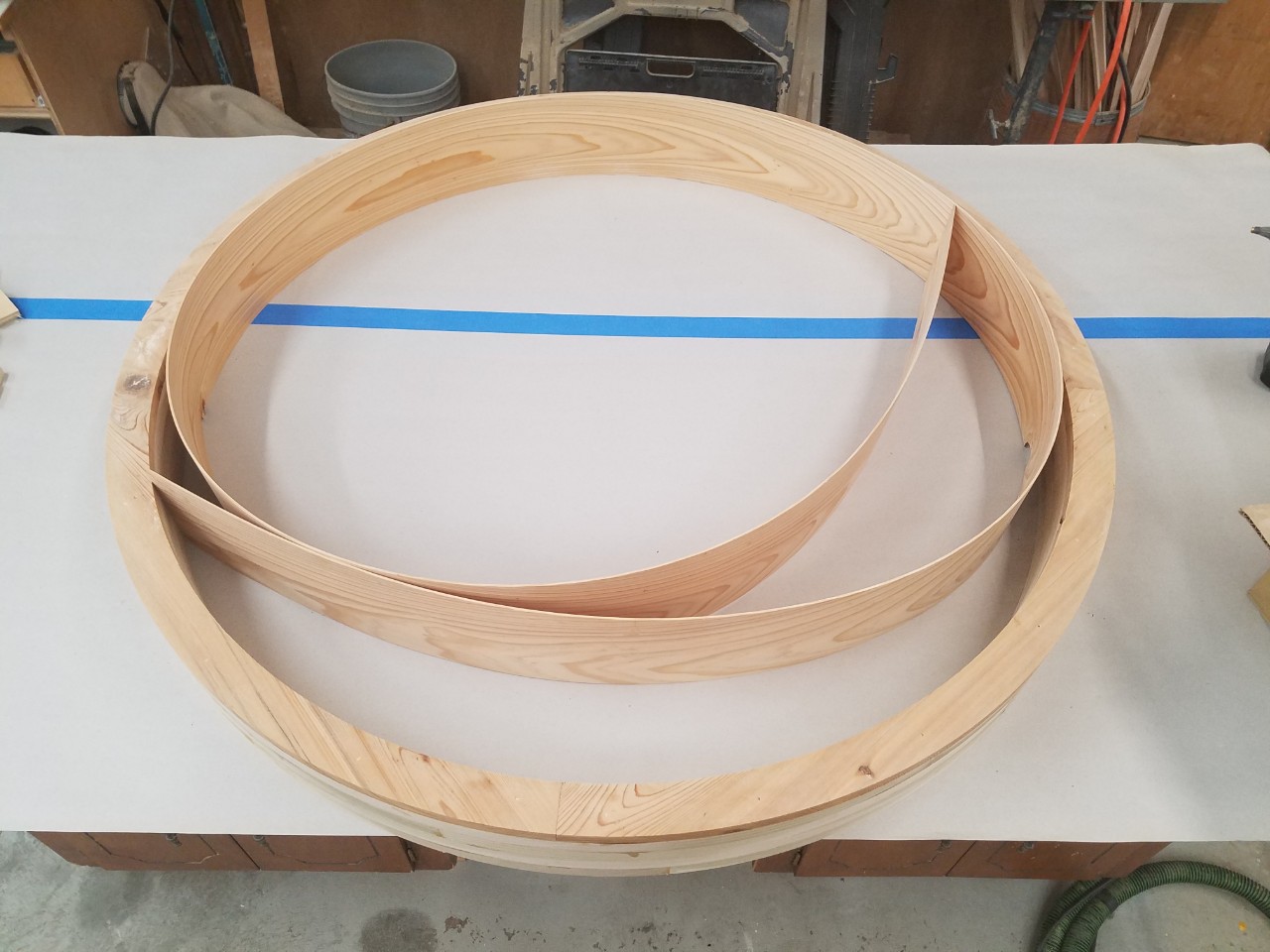

I have a round window frame a built from poplar staves. I need to laminate the inside with the cypress veneer (1/16"+) to the inside of that. The window will be stained glass in a church. Heat from sunlight will be a slight issue. This is the interior side of the jamb. Glass is between interior and exterior jamb. Room is conditioned space.
What glue do you suggest? PVA? Epoxy? Poly?

In the end, I chose the epoxy. Used formed cauls made of stacked mdf to clamp against the inside of the veneer and the frame. Had four layers of veneer. Clamped all at once. Dry fitted first to make and cut the veneers to length. Made sure to mark them so they would go back in the same way.
Used every clamp I had. Worked very well. A little nasty, but nothing like the urethane would have been. I feel confident that the epoxy will keep everything tight and tidy. Thanks to all who responded.
