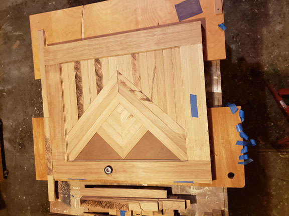

Hello, this is a follow up question to a post i uploaded month or 2 ago. Got some great help and have progressed up to the point of attaching the 1/10 th inch thick parquet or veneer pattern to the extira core. the core is floating in a M&T frame glued with west systems. I am glueing the oak pattern with west systems 206. the concern i have is how to adequatly apply enough epoxy to hold the piece long term and not have epoxy excess push through to the face a/o the overlay bracing i place on top to clamp it all down. the 2 solutions ive pondered are if push out epoxy is minimal apply wax paper before clamping and sand off the exposed epoxy since i have to sand a bit anyways due to the burns or instead use a pin gun and hold each piece individually and clean as i go. the finish will be semi transparent but allows for some filling. maybe bad ideas but thought it better include. any help would be greatly appreciated or perhaps i missed an earlier post that is similar. heres 2 images showing most of the pattern installed

Control the amount of epoxy applied to the underside and edges of the parts by rolling it on. You want some squeezeout. Without it, you don't have enough adhesive. Sanding is unavoidable. You don't need much clamp pressure with epoxy.
