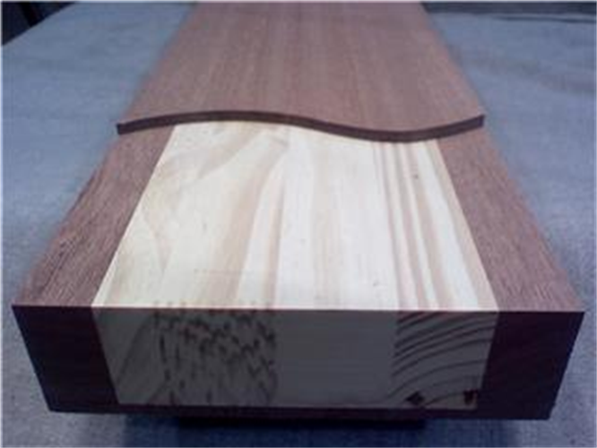

We are making 20 interior Shaker doors for a customer in Red Grandis and plan to make Stave Core Stiles also in Red Grandis. Size 84" x 36" x 1 3/4"
Rather than using finger joints in the make up of the core [which seems to be the most common method] we plan to use 4 or 5 solid lengths of Red Grandis. My question - is this a bad idea? Would it make any difference in terms of stability not having finger joints in the core?

Probably not. What is the core species? Within the core, are you just butting for length?
If your sticks that make up the core are narrow enough, you can safely butt them. I would not allow any more than 25% of the width be butted sticks. Be sure to make them clean butts, with glue. They can telegraph their presence if the faces are thin. The photo seems to have them at 1/4” or so. Plenty thick enough to avoid telegraphing.

David the core species is also Red Grandis in 84" lengths there will be no joins in the lengths at all [no butt or finger joints] The reason we are thinking of doing the stiles this way instead of just solid wood stiles is for stability. Solid wood stiles have a much higher chance of warping as I understand it. The sticks which make up the core will be 84" lengths, each length approx 1/2" thick. Glued together along the lengths with Titebond 3.

I have bought hundreds of door stiles from Wolf Lumber in PA. The two outer pieces are full length (obviously) and the core is butt jointed random length pieces, I see no reason to use TBIII for interior doors,

Ross do you think using one piece lengths in the core is as stable as using short lengths butt jointed together in the core?

Conventional wisdom is that if a shorter piece warped it would be less likely to effect the stile then a full length piece. I think a more truthful reason is you can use up short pieces and therefore have less waste. Also you can also take a full length piece that is bowed and cut it into shorter lengths and still use it. Either way, any core material that is twisted or significantly bowed should not be used.

Thanks Ross yes I tend to agree with you - "I think a more truthful reason is you can use up short pieces and therefore have less waste" We are not set up to do allot of finger jointing efficiently so I'm going to go ahead and use 84" lengths for the cores. I doubt there will be much difference in terms of stability.

Nothing wrong with using solid vs finger jointed staves. The finger jointed probably adds to the stability but difficult for the smaller shop to produce economically.
One thing we do when making these is to reverse the grain of each piece when gluing up the staves and make sure the skins are the same m.c. Every time I have seen these bow it is because the grain is not reversed. We also carefully face the staves before gluing the skins and also reverse the grain of the skins.
