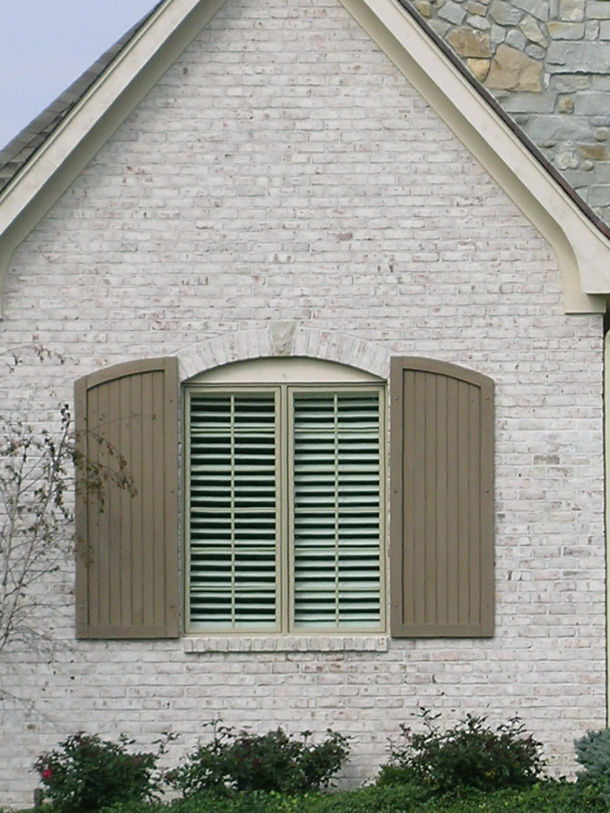

David Sochar: Nice photo, it captures the essence of the decline of architectural detailing. Would it have been better or worse if they had used fake rectangular shutters?

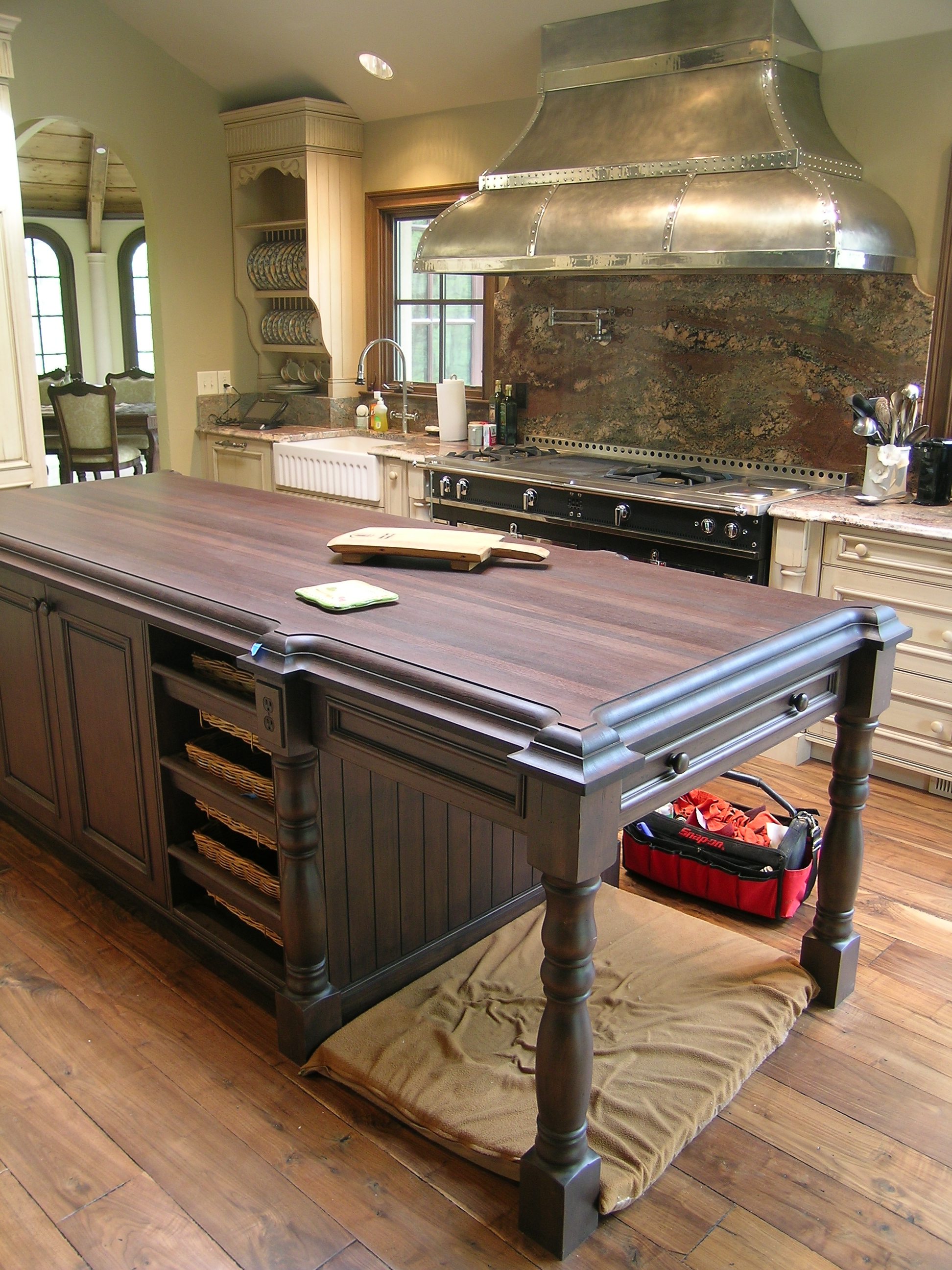

Some of the pricier kitchens we see have two large islands, often with sinks and beverage coolers and warming drawers, large range hoods of fine material and craft, lots of brackets and cubbies. Usually 2 -4 different woods and finishes, with plenty of stones and metals.

David,
That is a very nice kitchen, but that range hood is sweet, probably $399 at Richelieu. Haha.
