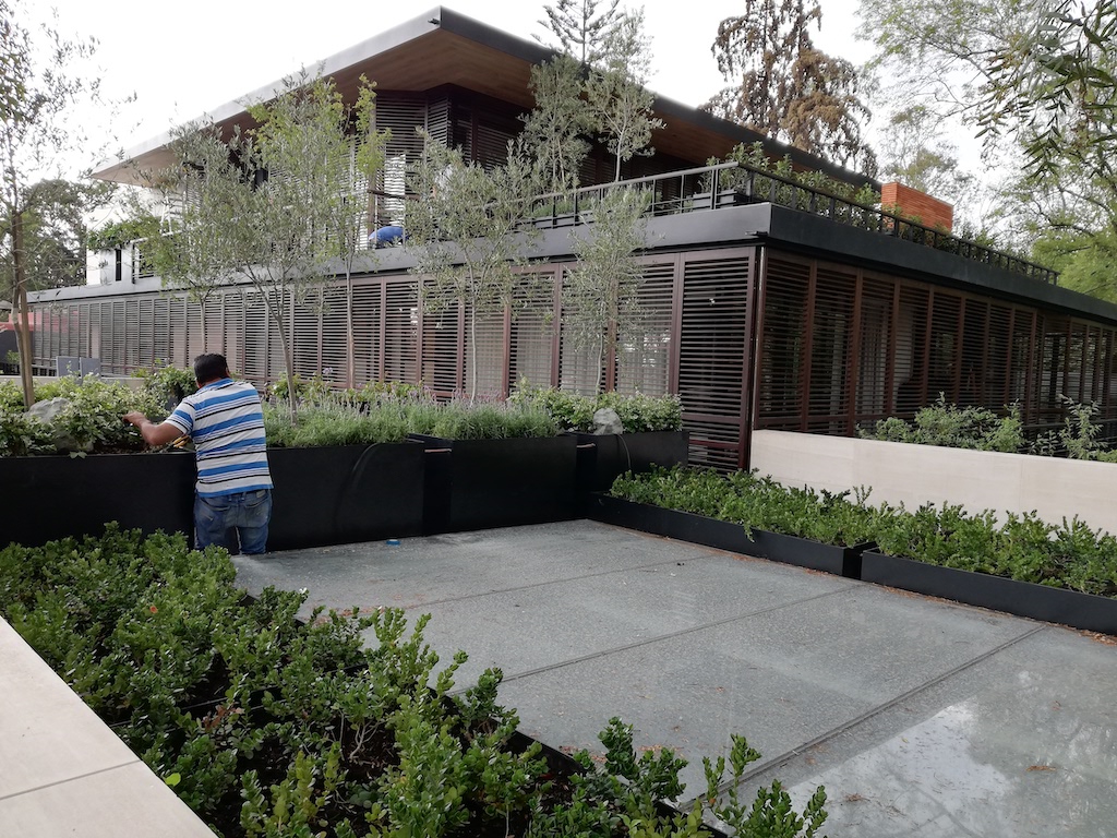

Craig Caughlan Member
Website: wetimber.mx
The times we've used Accoya for exterior door/facade applications, we've never applied a face ply. We laminate, mill and use Klima or Milesi for tinting and top-coating.
The attached photo is a job we completed about nine months ago: 150 folding doors, 1m wide x 3m tall. The stiles were of three laminations, finished to 60x90mm. Adhesive was Aerodux resorcinol.
Re adhesive, we've since gone to a Franklin product: Advantage EP-950A as it's more user friendly.
