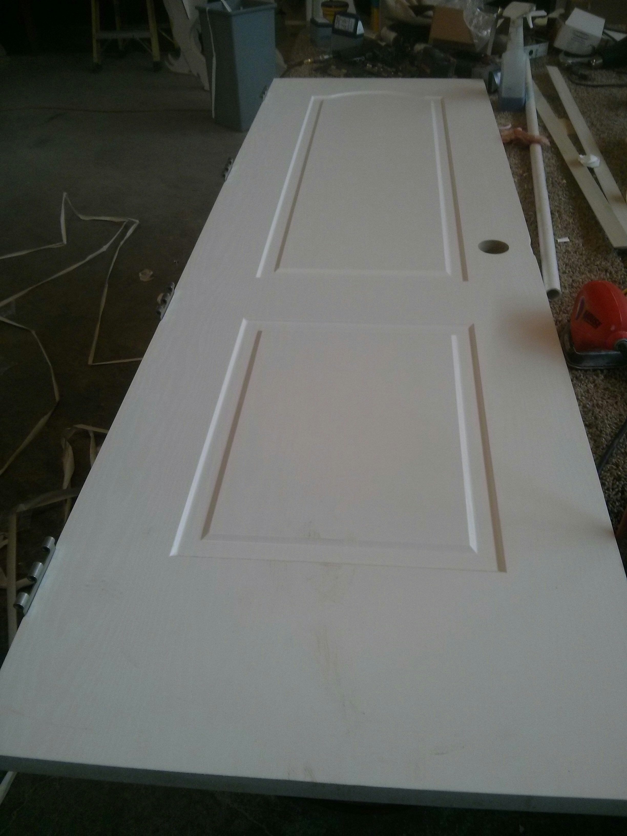

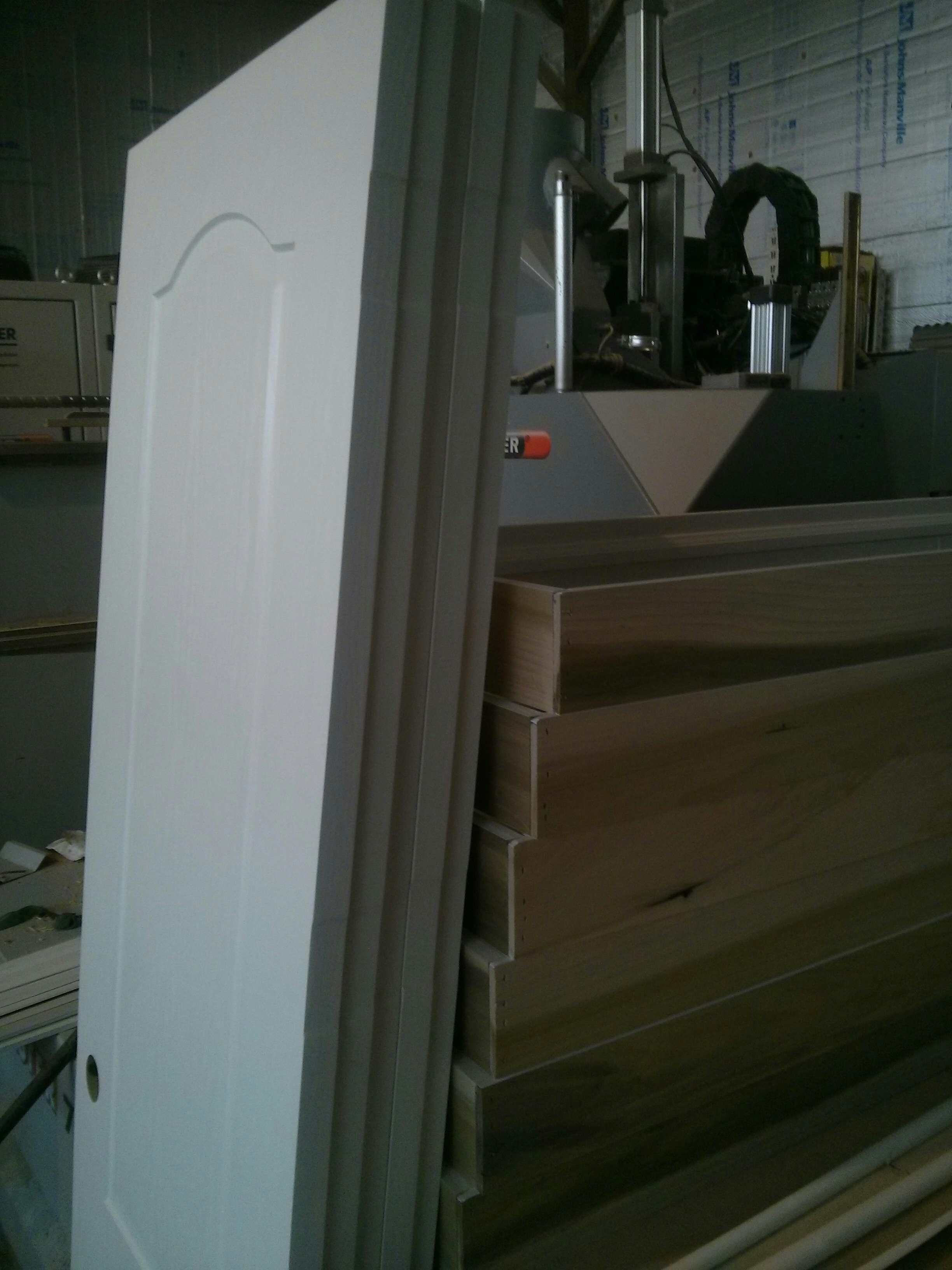

I have done what you are asking about. We just completed an order for 30 prehung doors. We used 1 1/4" LDF machined on both sides. We used 2" flat head sheet metal screws for the hinges. I then 3D laminated them with a white woodgrain. (thermal-foil) We tested these doors by saoking them for 3 1/2 days in a tub of water and surprisingly had only a very slight swelling in the one edge.
