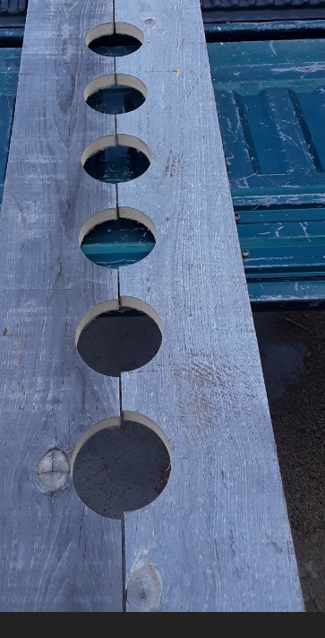

Any ideas on how can I cut this?
4/3/20
pat gilbert
I need to cut a bunch of these out of reclaimed fir uniform thickness about 15/16"
I think the peaks will split on a router?
Any ideas would be appreciated.

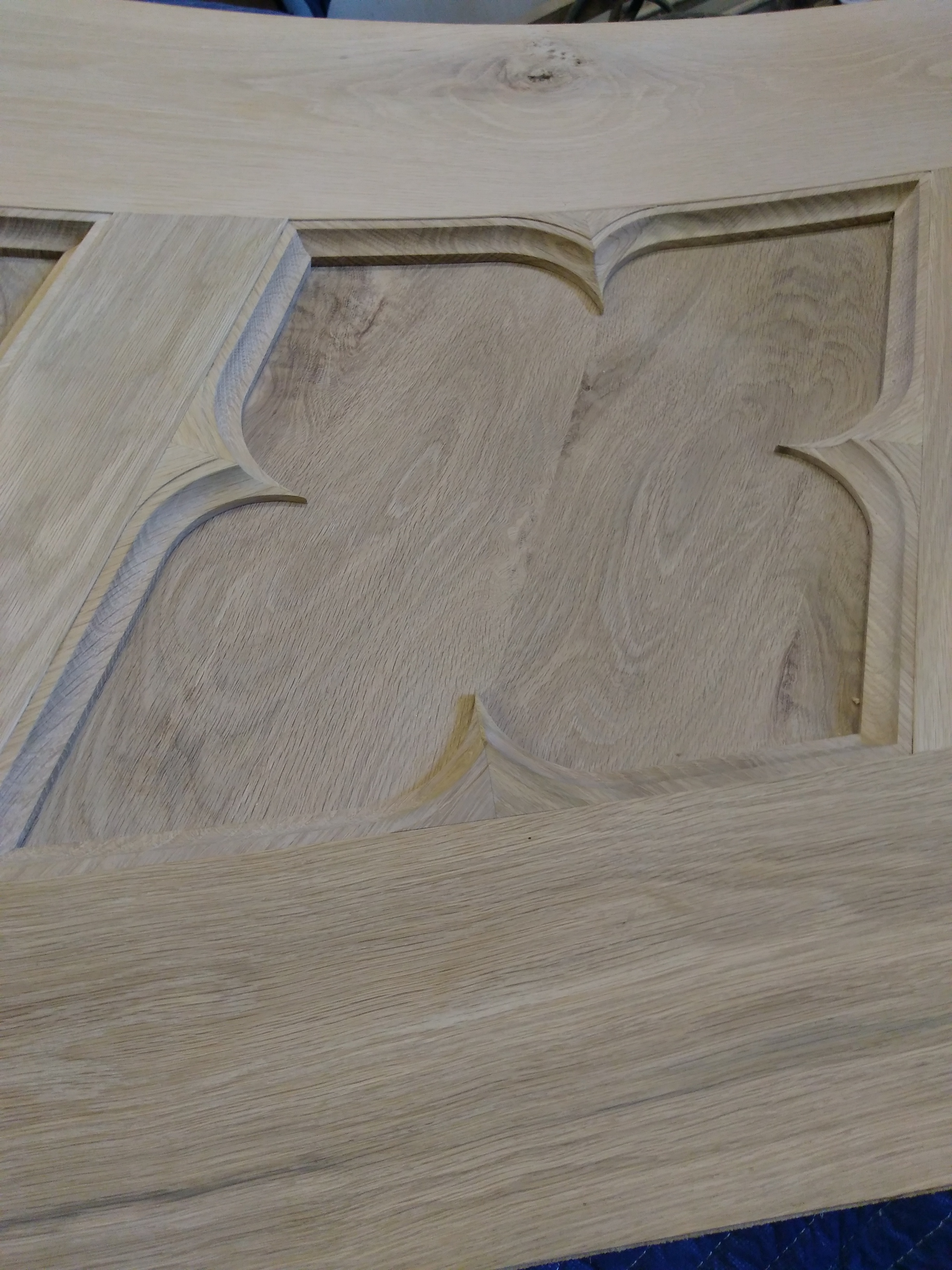

I have spent the last two weeks cutting white oak with a LH rotation, chipbreaker down spiral - it is necessary to use an M04, rather than M03, but I'm quite sure it works.
These twisted mouldings were made with both a 1" ball end and .375" down spiral, both in LH rotation on the left side, and RH on the right side. Loss was nearly 100% on the left side using RH rotation, no matter how carefully it was programmed using climb cutting. The parts were made by gluing up at a 45, so the grain is converging toward the center, making the direction completely predictable.
We made several hundred both for this circular wainscot and flat version for walls, so we got very good at the process, but it would not have been possible w/o LH rotation.

I think you are all overthinking this.
Make a jig that clamps two widths together and then cut circles. When you take the parts out of the jig you will have 2 sections.
Or you can glue two boards together and cut a slight oval instead of a circle with the straight part of the oval equaling the kerf of the saw blade that you will cut them apart after the with after milling.

Run them as 2 side by side so you cut a full diameter hole. Elongated for a saw kerf if necessary, then rip to width for two parts. No peaks, no chip out.

what rich said, router holes in full width board + thickness of blade then rip sucker in half

I will try the circle technique first as it seems like easiest

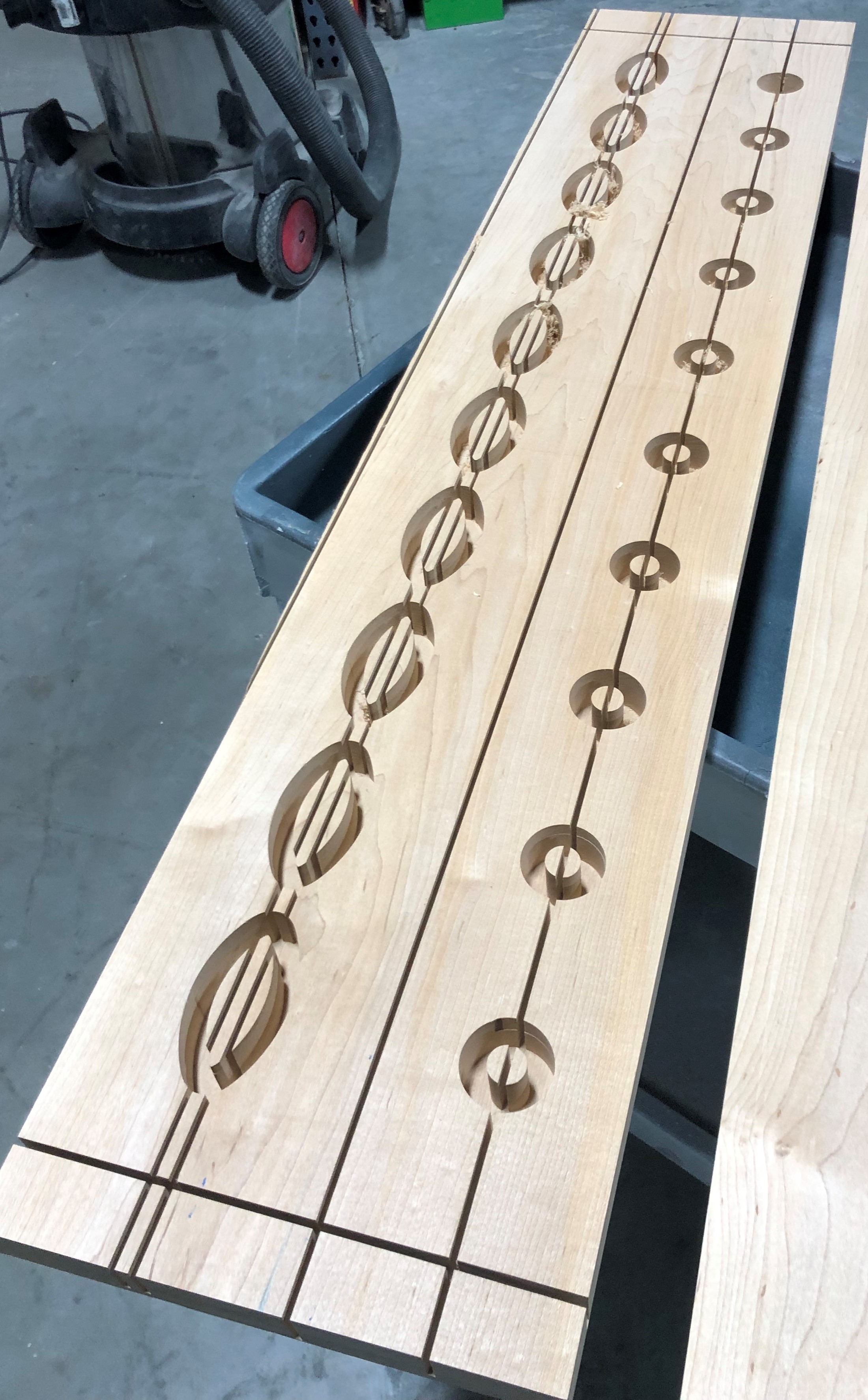

Krepco Member
We do these every now and then and I found this was the best way to cut them. 3/4 downshear bit, climb cut, no tearout, sand and finish. Used a 300 mm saw blade on the CNC (5 Axis) to cut out the finished parts but a table saw would do the same. I did not cut all the way through when cutting the bottle holes or the sawing out parts. Once the cnc was done cutting I took the board to the planer and took off the last 1/8 inch and had the finished parts.
View higher quality, full size image (2200 X 3550)
View higher quality, full size image (2989 X 2885)

pat gilbert
Perfect, thanks Krepco

pat gilbert
FWIW worked like perfect, thanks for the tips
