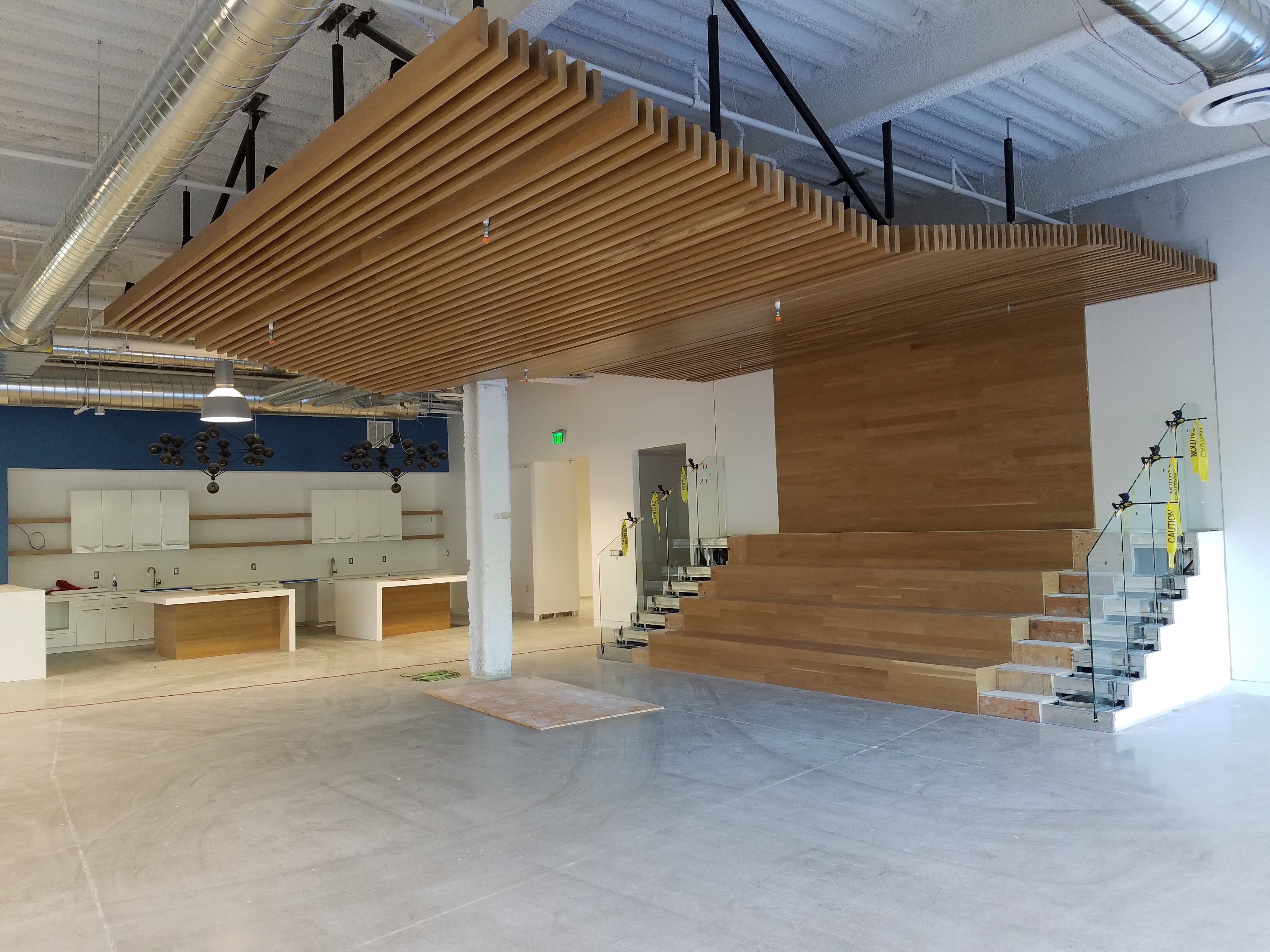

Has anyone hung 2x8 #2 common lumber from the ceiling with 1/8" aircraft cable to where you can't see anything but the cable?
I need to find some kind of hardware that I can use to hang these slats, be able to adjust them to level and have them hidden both in the ceiling and on top of the slats.

Gonna need a sketch to help that description. Is the 2x8 hung vertically, or like a suspended ceiling? Also don't understand the "can't see anything but the cable"?

The ones in the picture are about 21' long and are 2 x 6 and connected to a metal structure. Some things aren't meant to float in midair

The slats are 17' long. They will hang in two different locations. One set will hang below a drop ceiling which poses its own set of problems as far as running the cable through the tiles and up into the actual ceiling. The other set will hang directly from a sheetrock finished ceiling. The architect wants these slats to suspend from both ceilings where all you see is wire, no mechanical fasteners or adjusters. The pic is an accurate look as far as how they will be suspended. My question is, how do you adjust these long slats to level and still achieve the wire only look? One set will be approximately 16' in the air and the other set about 8'.
