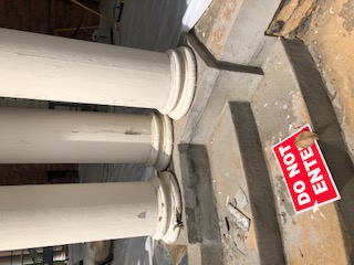

Cheers All, I am replacing fake concrete plinths with wood. The challenge is the columns are grouped together in sets of 3, so they are appear too close for individual plinths.I have 2 ideas for a design:
Laminate 2x4’s on end to make a single plank or use 4x4’s and a half lap mitre.
Plinths need to be 31/2” tall 18” wide.
What’s the best method?

here is what i am working with... about 3.5" tall and 18" wide..

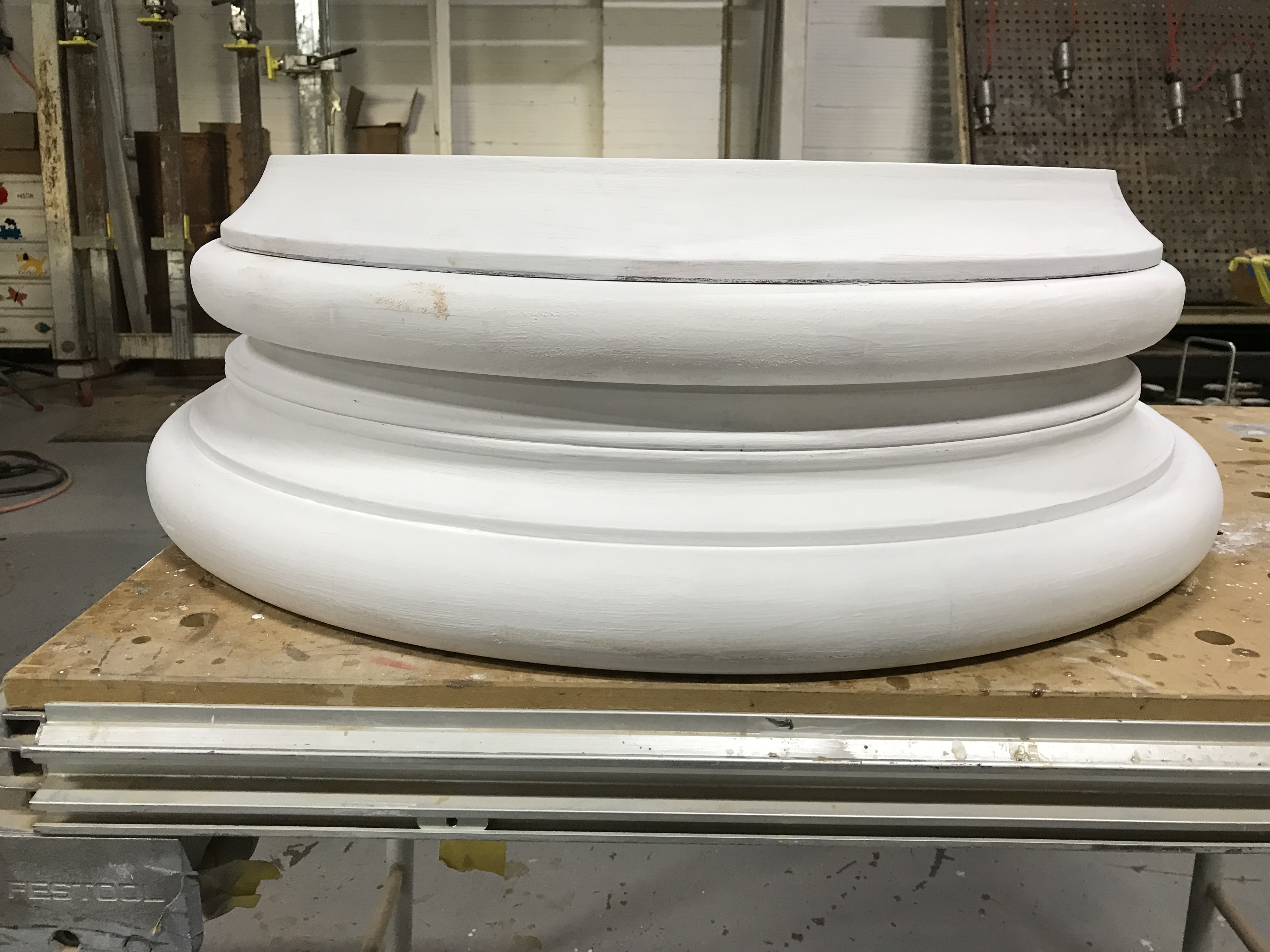

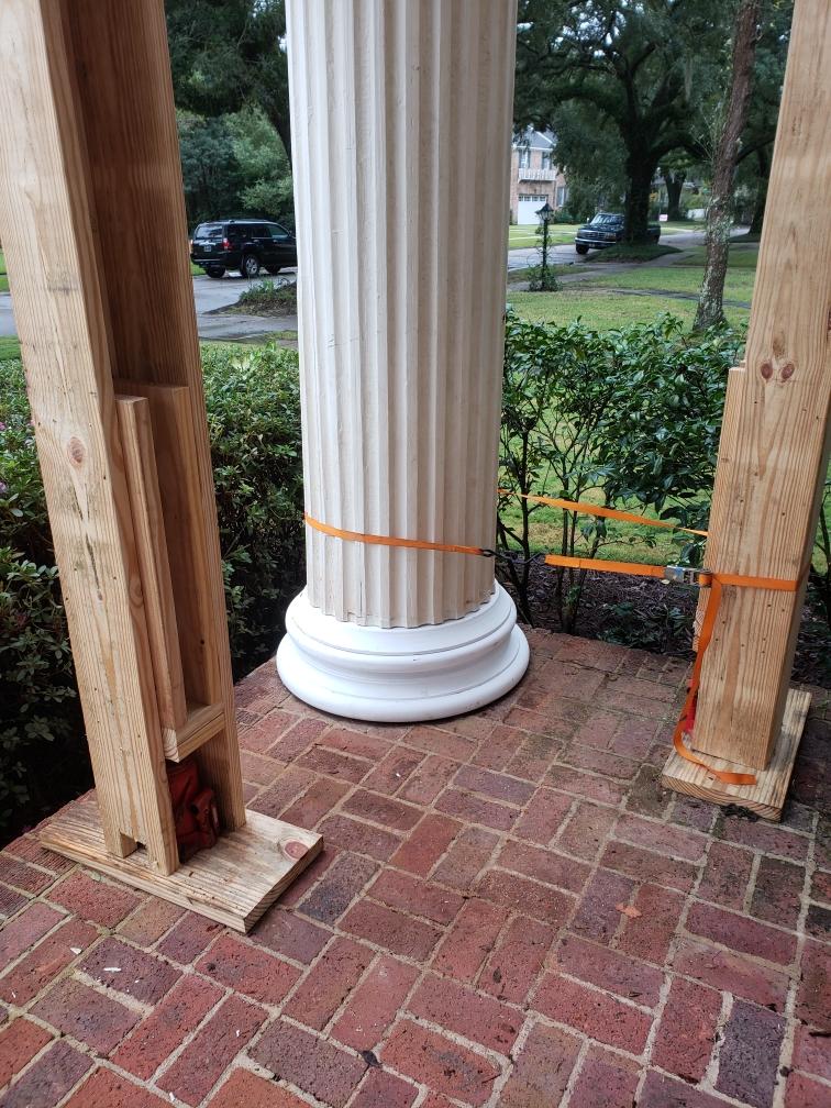

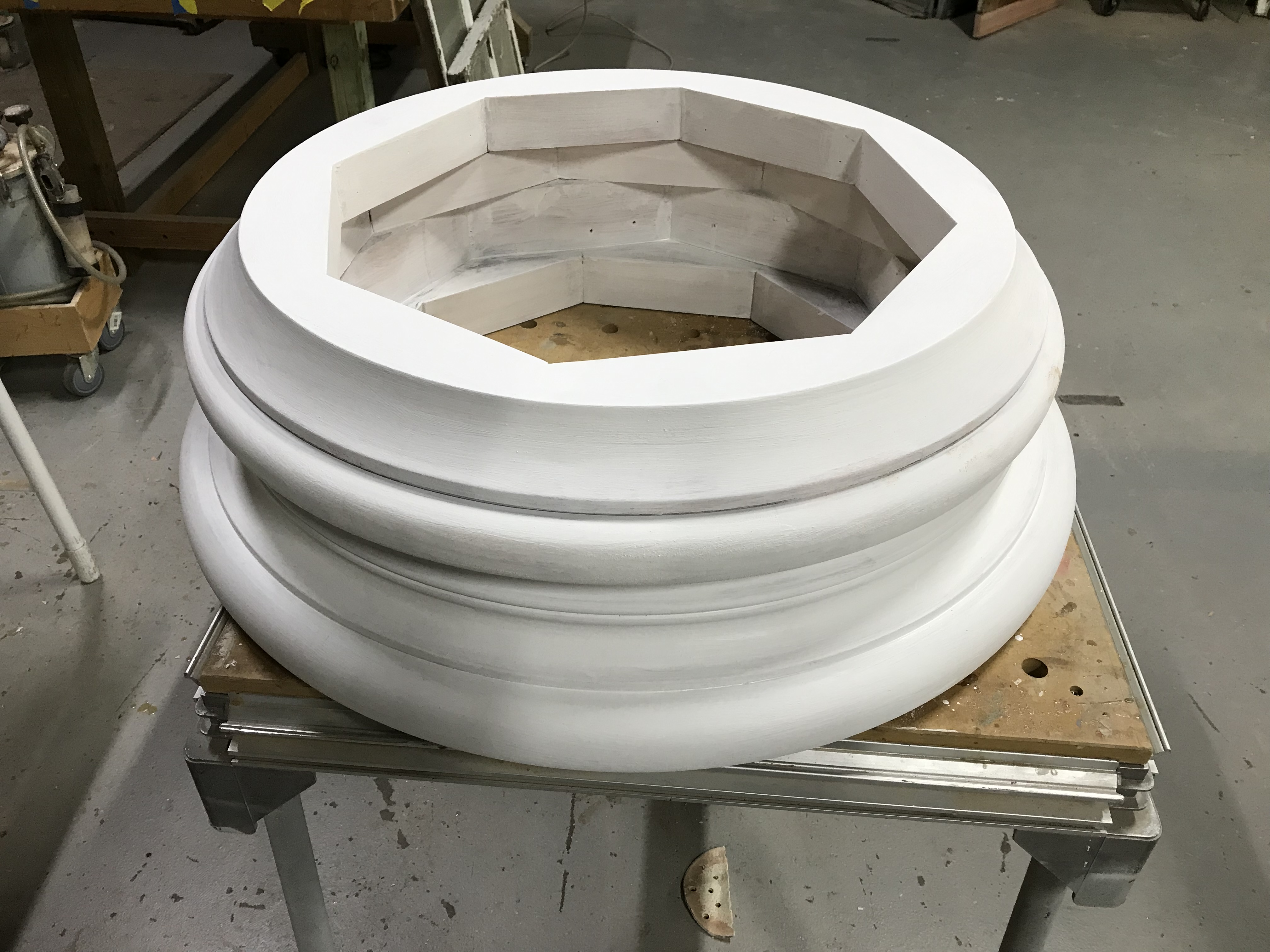

Hastings Read Member
Hers how we tackled this recently. Octaganol sections finger jointed with epoxy. Four separate sections turned on a lathe and then joined with Dominoes and epoxy. Bottom section was Accoya, the others Red Grandis.
