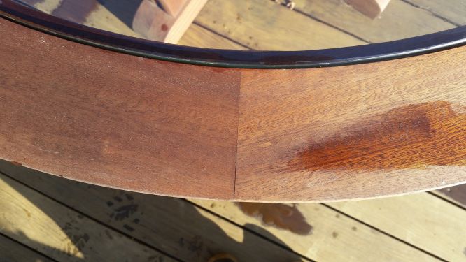

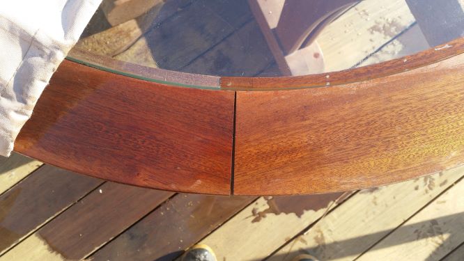

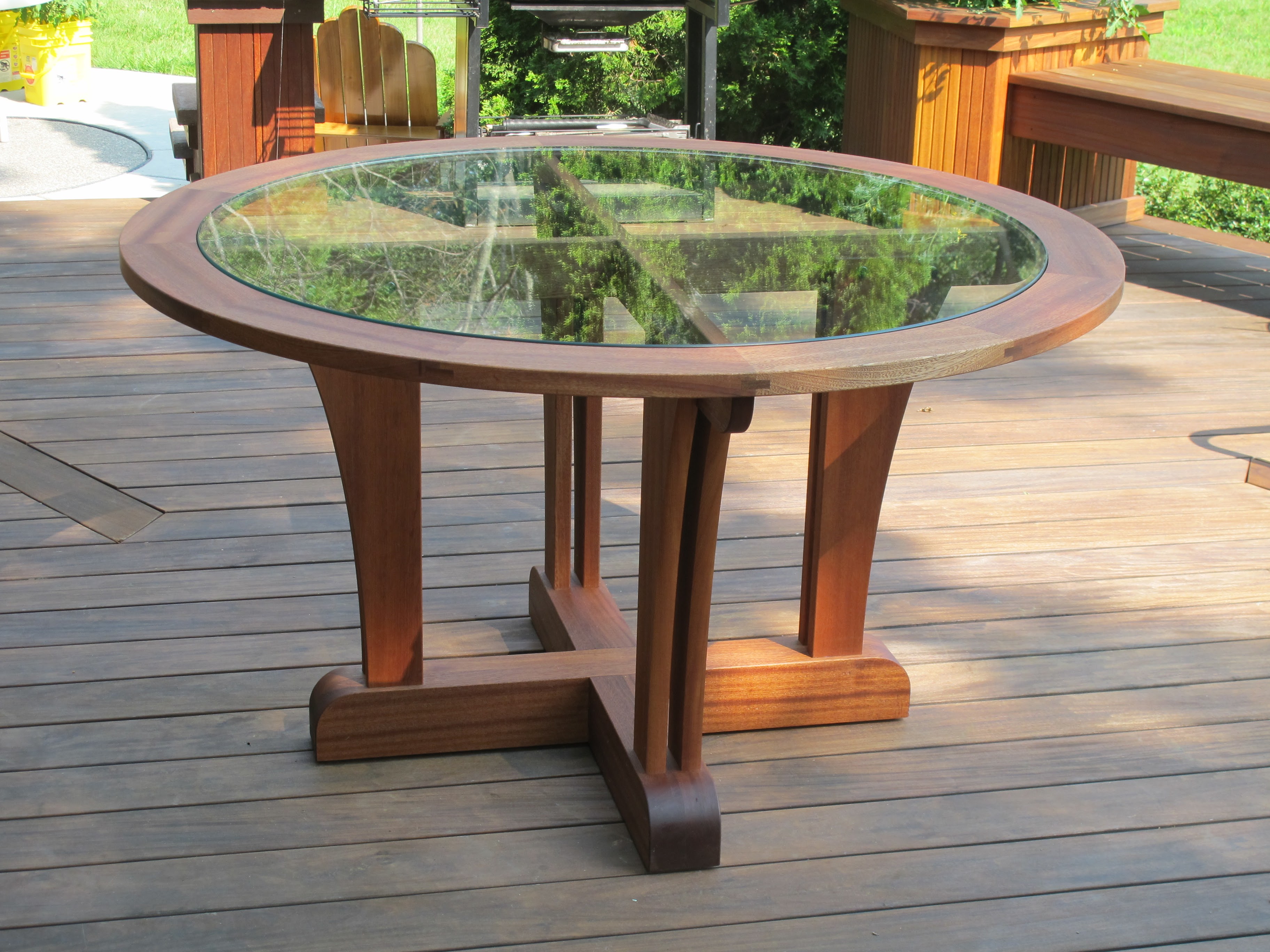

I built this table about 3 years ago, knowing at the time that the top ring was a risk for the joints separating with seasonal movement. Sure enough, 2 of them did after the first winter, and nearly all of them have at least small cracks now after 3 years. There are 12 segments to the ring, which are about 4-1/2" wide and joined together with a spline 1" deep and glued with T-88 epoxy.
Knowing that I have again proven that wood moves and mitered joints fail how would you go about making this ring? The only way I can think to do it is by winding a narrow strip of wood around a form, glued with epoxy, to form a spiral ring like you see on the base of some Danish modern chairs. Thanks.
John
View higher quality, full size image (3648 X 2736)

David, the Sapele I used to build the table was at the same moisture content as outdoors when I took it into my shop to build it. On the order of 10% IIRC. My shop is at 8 - 9% in the summer. If you look closely you'll see that the splines run the correct way. Nothing has broken; the joints have just opened up. Are you suggesting two splines across the joint would survive 10 years outdoors? Some of the joints have opened up 1/8" at the toe, while being almost tight at the heal. I don't think there is any glue that will prevent that from happening. If it did I think the ring would take on a dish shape in order to relieve the stress.
Rich, yes it's an outdoor table but is covered with a vented vinyl table cover so it's not exposed to direct rain. No way it's getting a new piece of glass. That thing cost a fortune.
Has anyone built a glued splined ring that has survived outdoors? The table is my design but not the splined ring joinery. That came from an article in a well respected magazine. I was suspicious from the beginning, well founded as it turns out.
The 3/4" thick glass just sits in a rabbet in the ring; no glue. There is 1/8" clearance between the glass and ring all around.

Wood moves
We know that
If the joints open enough to let water in, fill them with epoxy to keep it out
It's a beautiful table
Don't lose sleep over it ;-)

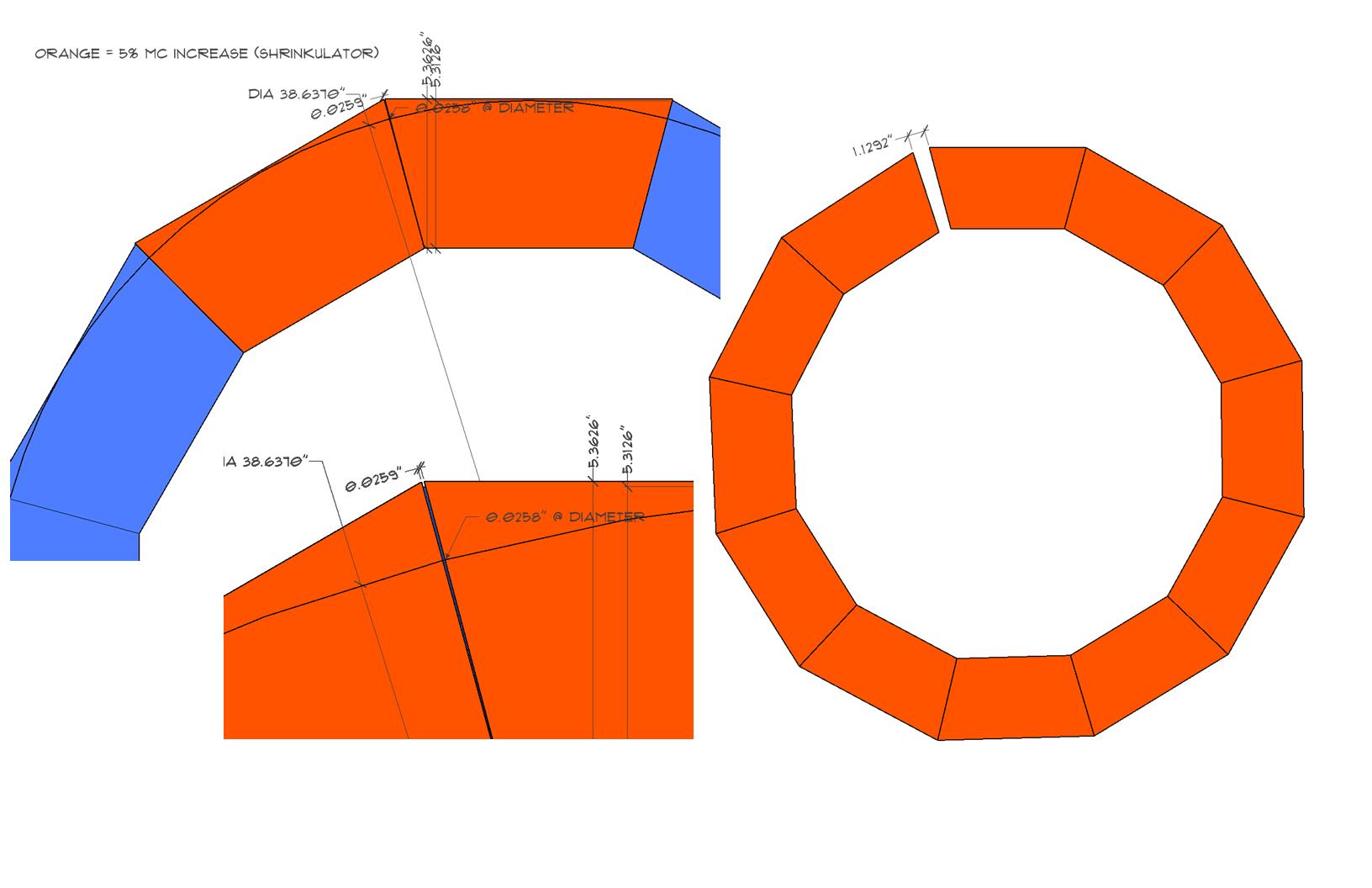

I am back with some revised thoughts, and more math.
What is the MC of the table rim now? "Shop is 8-9% in the summer" ?? I think you mean 20% or so. 8-9% is extremely dry to be doing anything, much less working wood.
Yes, the 4-1/2" width could be narrower, to your advantage. And the 1/8" opening at the toe is the best tell of all. I have long taught a thought experiment about miters opening, where and why, and this is a good example of expansion (increase in MC). As the wood gains moisture, it also gains width. The mechanics of the miter will not allow it to open at the heel (unless the wood was shrinking in service) as it gains moisture/dimension.
You can think of each of the segments as expanding outward, away from the inside toes of the miters. If all the joints are open, I would guess the diameter has increased by .250" at least.
If you discount the holding of the epoxy at the end grain (this can be disputed - epoxy can hold on the end grain), and increase the plows to 1.5" deep x 4.5"long, and doubled, then you go from 9 s/" of long grain to long grain (as built) to a whopping 54 s/" of long grain to long grain! Six times as much glued surface!!
Yes, I think that a 3" wide, double splined rim, epoxied will hold up 10 years if it is covered as you describe.

What is the size of the gaps? Thousandths,1/32" or something I can fit a credit card in? If thousandths, I am not sure wood is the correct product for this customer.

Brad S, He said earlier some of the gaps were open 1/8" at the toe tight at the heel.
12/3/20       #25: How would you solve this problem ...
Mark B Member
To me, if the statement "some of the miters are open 1/8" at the toe and tight at the heel" means 30% (4 of them) that equates to a quantity of movement that no species, nor any change in joinery or increase in glue surface area, could ever attempt to resist. If 4 joints are open nearly 1/8" thats more movement than any spline miter can restrain.

Pixels, not cellulose and lignin, but for fun tossed in a quick 12 segment ring likely much smaller than the original table (40" outer dia segmented, 38"+ round). Sapele on Shrinkulator - .040" radial on a 5.5" width with 5%MC change. Keeping the heels tight leaves .0259" and takes less than a tenth of a degree off the bevel. Taking all that error out on a single joint leaves a 1 1/8" gap.
View higher quality, full size image (1632 X 1056)

I've seen full circles fail as Mark shows in his CAD drawing, and in multiple smaller gaps around the circle.
Picture a simple MSG interior door or window 45 degree casing corner. If it shrinks it opens up on the inside of the corner. If it expands it opens up on the outside. The stronger the wood species, wider the moulding and greater the change in seasonal moisture content the harder it becomes to prevent this from happening. Take the same concept to a full circle and you are making the separation forces even stronger.
I feel strongly that the only way to pretty much assure you won't be making this a third time is by using the brick layered method. The wood would have to split through both layers along the grain for that to fail.

Here is a photo of a joint that has barely opened up and one of the two really bad ones. The ring is 50-3/8" OD and the ID is 4" smaller.
John
View higher quality, full size image (666 X 375)

So at 50" thats some back of the napkin increase of like 24% on the numbers in the drawing. Depending on how many joints are really bad it seems your well below the math though any movement and the forces associated there would seem to present a problem.
12/5/20       #51: How would you solve this problem ...
It looks like you have nailed the failure math Mark. The 1/8" gap in the original posts seemed to be crazy big for simple expansion/contraction, but it comes down to weakest link opening up. The rest are gaps due to mitre angle change.

Your 2nd bad picture is what an epoxy butt joint should look like. The first one looks like a pva joint. Like I wrote before. Perfect epoxy glue joints are ugly.

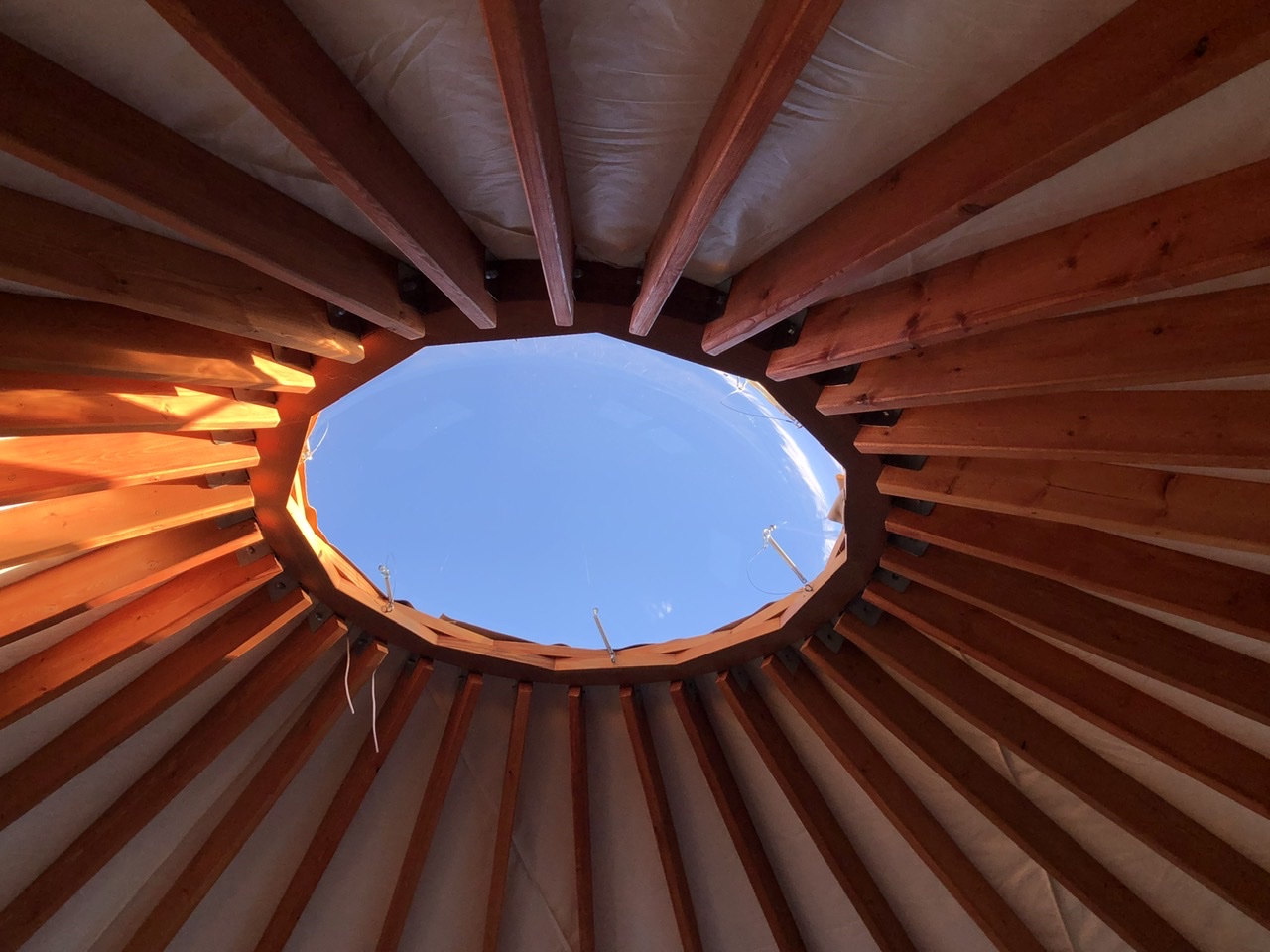

I’ve been working at the yurt last few days and thinking of this thread looking at the center ring. It’s quite nice and made by a local shop with CNC. In over a year and joints are tight as ever.
Poor picture but it’s bricklayed in 2 layers.
Not outside but exposed to radical temperature changes, sunlight and humidity changes at 11000 ft.
Am I right in thinking there would not be much movement of a ring with a lot of segments? Only in the width of opposite segments?
