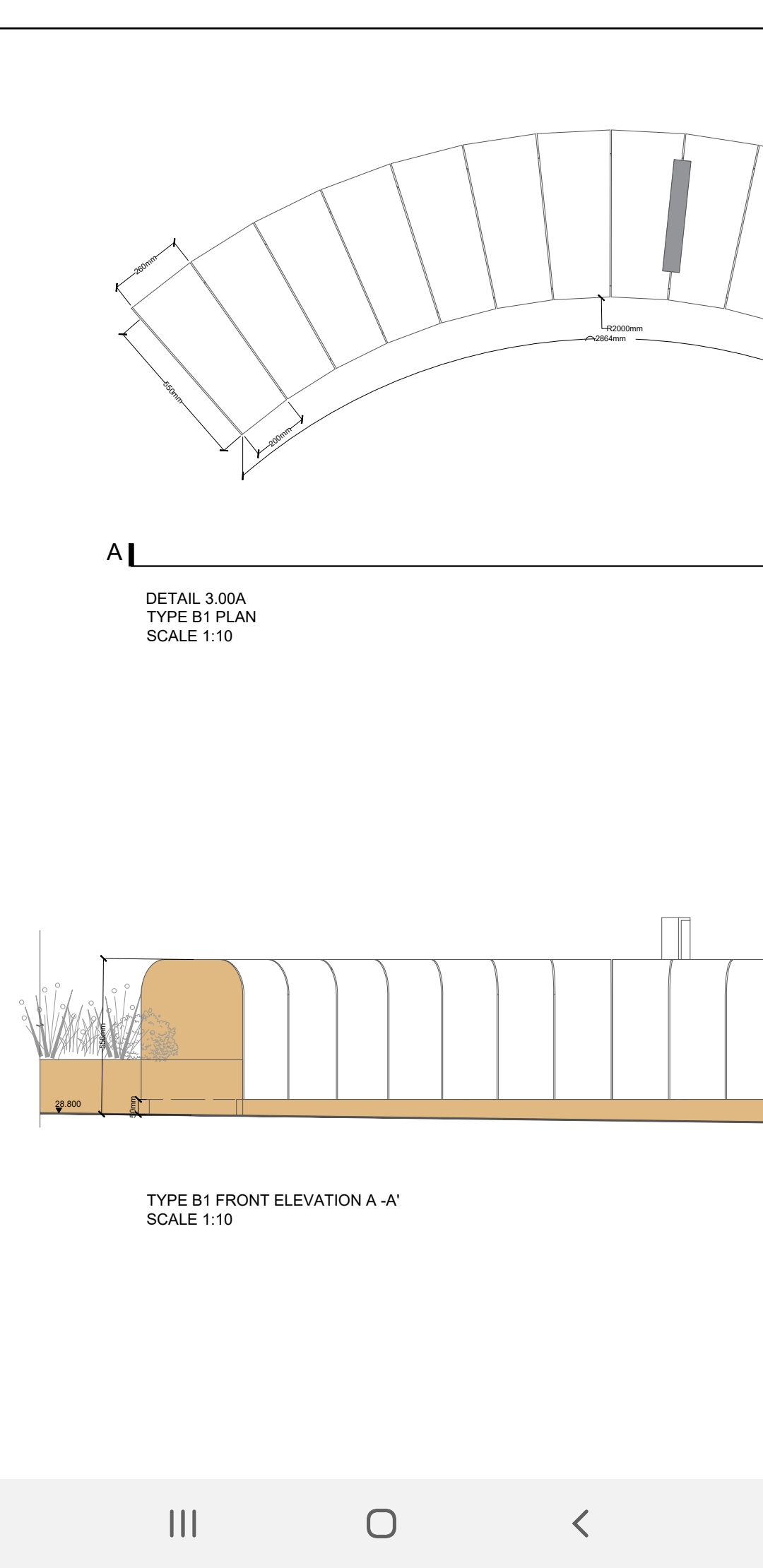

Hi everybody
We landed this job of 100 linear meters of curved oak benches. It calls for 12 -15mm thick x 200mm wide pieces. Would you steam bend entirely or laminate and bend.
Thanks in advance
Mick
View higher quality, full size image (1080 X 2220)
2/16/21       #2: Curved benches ...
steaming bending an 1/2" x 8"(200mm) wide piece of oak in 3 bends as drawn would be a challenge with one piece. Impossible to replicate over 100m. Let alone 4 individual pieces.
This would definitely be a lamination job with a press. We would vac bag numerous ones side by side. It's a huge project . 500 pieces. whoa

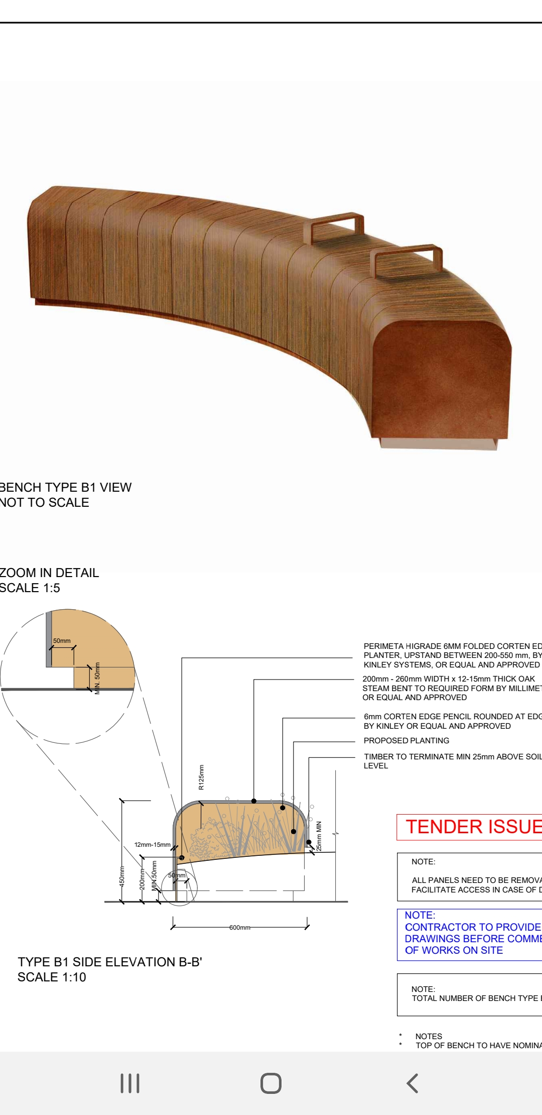

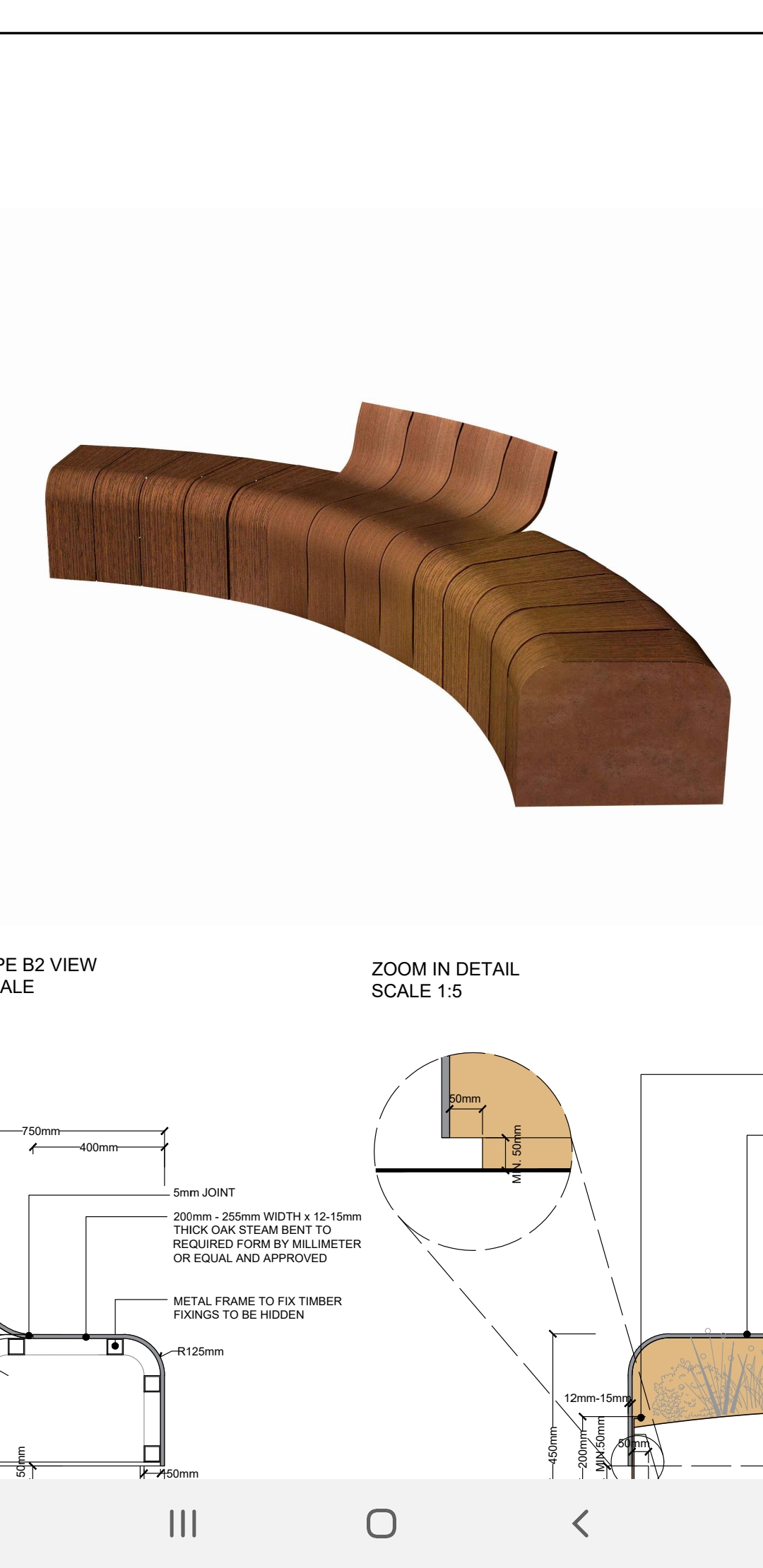

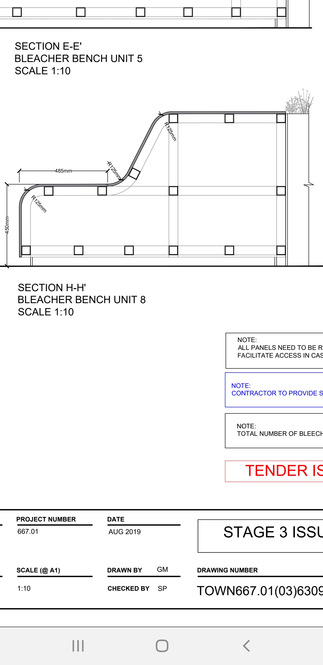

2/16/21       #3: Curved benches ...
Michael Folan
Thanks a mill for swift reply. To compound matters theres a mixture of curved sections where each slat will need to be hand fitted after bending. In your experience will i need to source green lumber and how would i speed up the production with forms etc.
Mick
