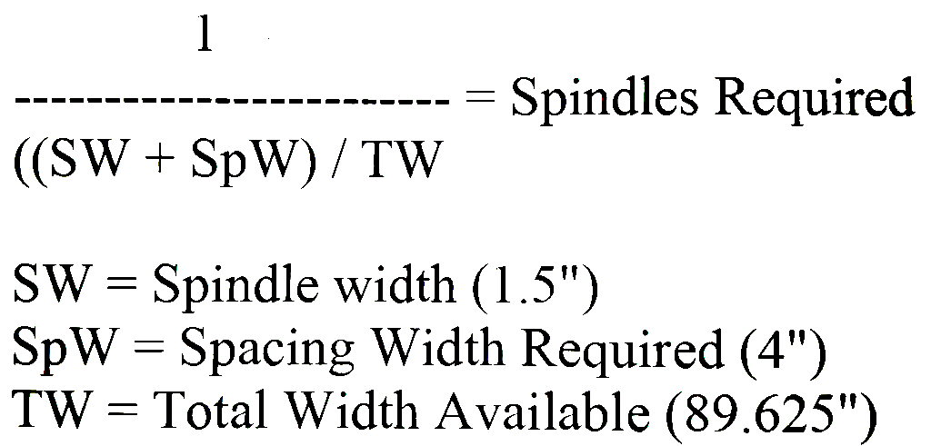

1÷((1.5+4.5)÷89.625)=16.3
Take the spindle and add it to the spacing you require and divide it by the spacing you have. Then take the reciprocal of the number and you have you spacing.

1÷((1.5+4)÷89.625)=16.3
1
((Spindle Width + Spacing width)/total width

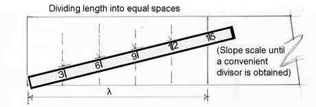

If it were me, I'd use a Git-R-Done approach for this one
and markup a sheet of plywood using the technique in the
image below, adjusting the divisor until the spacing between
spindles was just less then 4 inches.
Might not be as impressive as deciphering the formula
offered, but for me, it'd be far less prone to error.

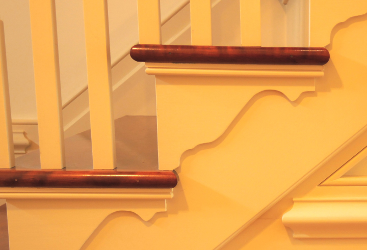

Not so fast........ If you are using something like a 5015, with 1-1/4" square base and a 7/8" taper turned top, then the calculations need to be made at the top of the spindles, using 7/8" and 4". Not 1-1/4". That 3/8" can cause a lot of misery.
And, sidebar here. The spindles do not locate off the center of a tread. The front face of the spindle needs to be aligned with the face of the riser and the outside face of the spindle base needs to be aligned with the skirt board or bracket.
The photo is a good example of what NOT to do. That first spindle is pushed out to the start of the bullnose, and looks like it is out in space instead of bearing the load directly.

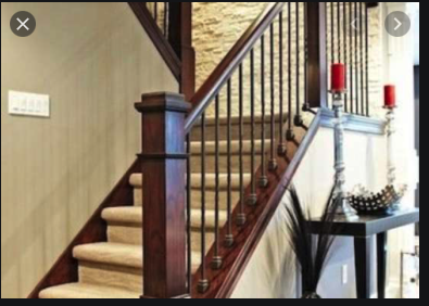

Ok, as pointed out, the placement of the spindles is critical if your stairs are like the pic posted, e.g. placement on each step. But the OP does not state, what if the construction is similar to this pic (sorry my nomenclature on stair parts is deficient) in which they are evenly spaced regardless of each step?
