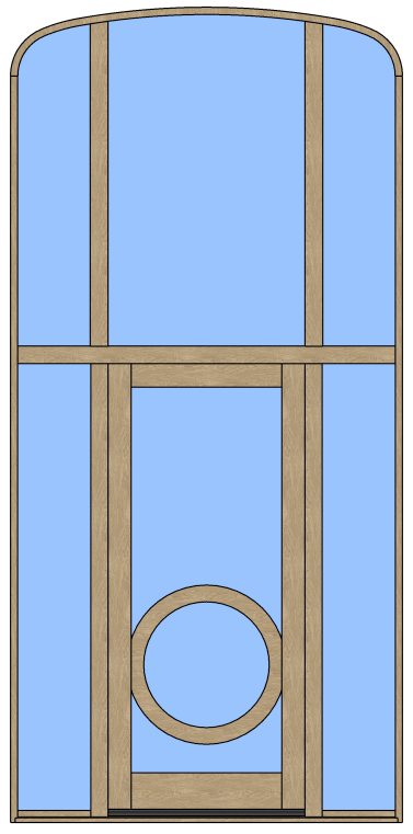

A recent inquiry from a client has resulted in the attached sketch of a door. The door itself is 48" x 108" in size. The whole thing is ~7' x 16'. It's overall size doesn't bother me a whole lot (mostly worried about fitting it in the shop and moving it around), but the size of the door bothers me a bit. I've built barn doors much bigger, but never a hinged swinging door. The whole thing is going to feature triple pane glass with art glass inserts making up the middle pane. The geometric circle in the middle of the door is actually my own addition to the design (the circle feature originally being a design in the glass), which I'm not sure the client will accept. I've explained my reasons to the client for wanting it, but I'm not sure they will go for it.
The door itself will be made of either white oak or sepele. They would like to paint the door white with the finish being smooth in the end, but I'm not sure I can find a close-grained wood that is suitable for exterior door manufacturing. The door is going to be installed facing east in a well treed area, so I'm not too worried about exposure, but the whole thing has to survive -40 degree C to +40 degree C seasonal shifts. We are located in Saskatchewan, Canada.
The door will be 2-1/4" thick with 6" stiles, 10" kick rail, and 6" top rail. The stiles and rails will be stave cored, 1/4" skins each side. I typically use 3" x 6" floating tenons, 2 in the kick rail each side and 1 in the top rail. I would put two more in the circle if it is approved by the client. The skins will be 1/4" sawn. The sticking for the door will be square, with 3/4"d x 1-1/4"t tongue and groove.
The IGUs will be 1-1/4" thick to match, inserted after construction, siliconed in place (with a ton of silicone) with a molding retainer.
3 points or more on the hardware, I haven't talked to my supplier to see what they would recommend yet.
So, um... basically I'm looking for validation on this. My worry is that the door will sag and that the silicone holding the panel in place won't provide sufficient strength over time to resist the weight.
Please advise and share your opinions.
Thanks.

What is the weight and type of glass? 16' bothers me for wind load. The circle looks way out of place. It appears to have a modern style appearance, but that circle in the middle speaks of modern Victorian?
8/17/21       #3: Oversized Exterior 1 Lite Doors ...
Christopher Member
Wind loading? Huh. I hadn't thought of that. That's a point worth investigating.
Agreed about the circle. Artistically and esthetically it's supposed to be art deco. Its position is based on the customers spec and it obviously needs some work before sign off. The conversation should be confined to the structural points in question.
How would you deal with the wind loading?

First, a critical review: This looks like someone wanted custom, but fearing a high cost, eliminated the details that would make it a good example of custom work. It looks cheap.
The door is not a problem if you build with good solid wood or stave built stiles, 2-1/4" thick, mortised for 2-1/2" or longer tenons, coped and stuck joints. Silicone the glass in place, and use it on both sides of the glass. 4 or 5 good ball bearing architectural grade hinges at 5"x5" will carry the weight of the door easily. No need to reinvent any wheels. And certainly no need for the circle. Trust the joints. No need for a bar clamp to test them, they should be far stronger than what a bar clamp can bring to the scene.
No funny hinges, and no multipoint. No big circle. Single point latch will work just fine. Crown the latch stile about 1/8" to 3/16". You might want to add a line of silicone bulb weather strip on the three sides of the door edge to augment the Q-lon type compressible foam.
The frame needs to 8/4 solids, rabbeted 3/4" deep x 1-1/2" wide. Box the mulls with T&G spacers, 8/4 thick, glued the full lengths. Join them with epoxied dummy tenons, sliding the elements together with epoxy. Did I mention to use epoxy? If these are boxed to 6-5/8" "thick" x 5" wide, they will be as stiff as they need to be.
I would also consider boxing the side and head elements also. The stiffness they would give makes this thing nice and rigid. Set your glass with silicone, and it becomes almost monolithic. Make sure your benches are flat and this frame is built flat. Any deviation from the building flat to the installed flat could cause problems.
I admit this is scary at first look. Remember, we are problem solvers that happen to work in wood. No need for steel, or strange inventions to make this work. Believe in your ability to join wood, and you will have it. But move past the thin elements, make them fatter, and hollow, and you are tubular, man.

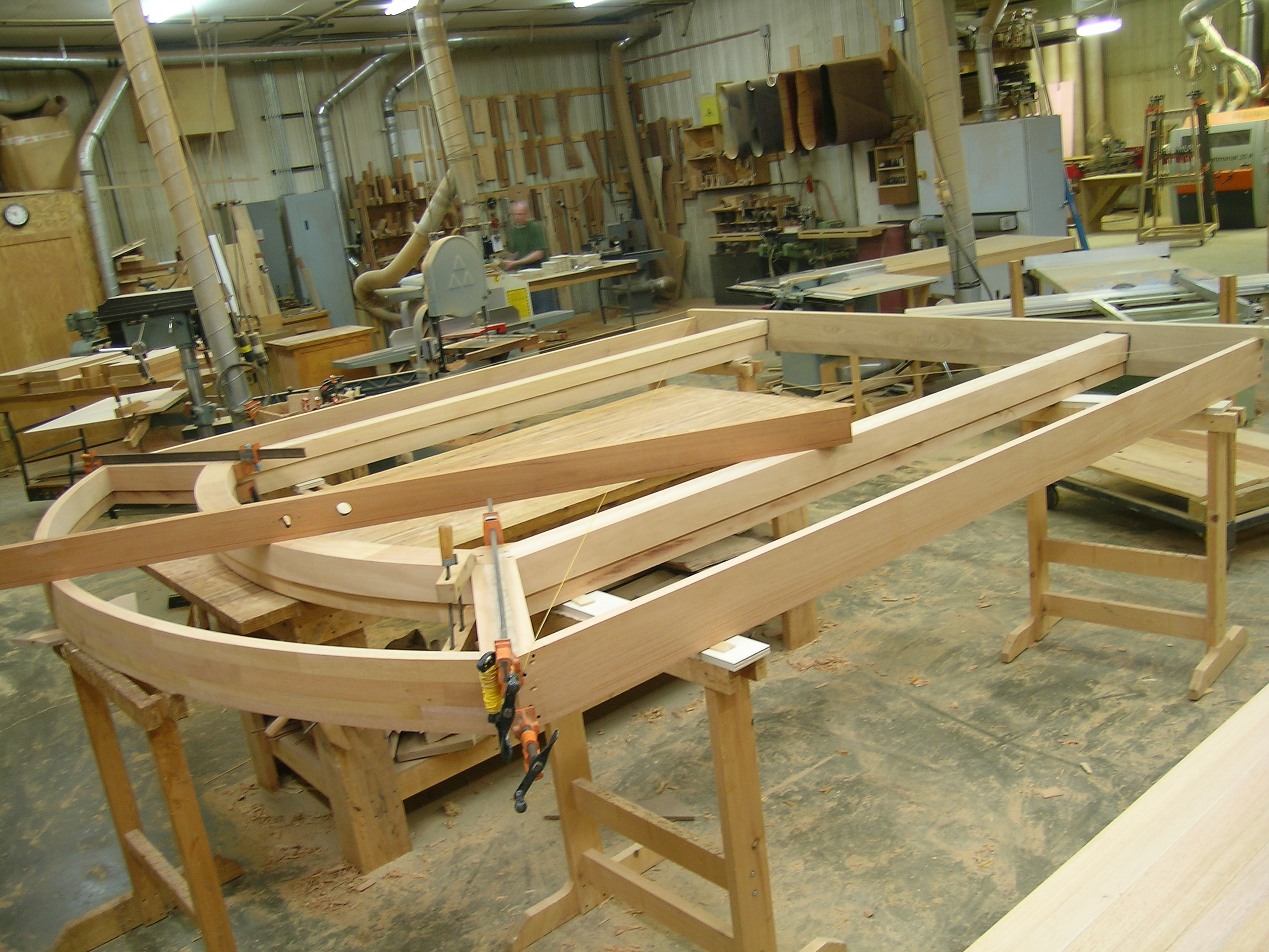

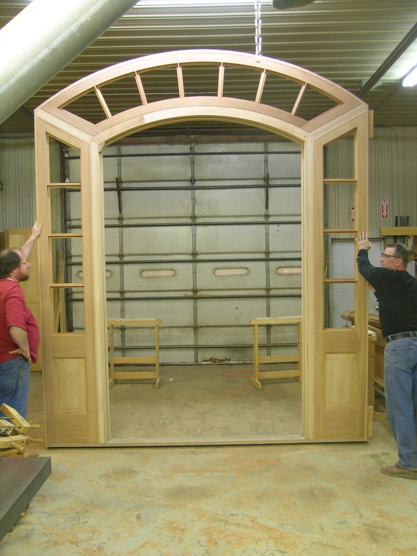

I, too am self taught. I worked with a few old guys back in the '70's. But they were burned out, and no real help, for the most part. I tend to overdo it, but then we have no failures.
No drawing handy, but just space your two jambs apart with a full length stick in the outer edge and another along the inner edge. We typically rabbet the spacers to make a 1/4" x 1/4" tongue on each part, then put a 1/4 x 1/4 plow in the back of the jambs. Glue and clamp.
We used West System for 30 years or more. Volume pumps make it easy to get 'just a bit' if needed. We now have Total Boat (from Jamestown Dist.) with an equal resin/catalyst mix that is so simple you feel guilty.
Once glued and clamped, you have a wooden box that is more rigid than two or three jambs together. I would run the two verticals full length, sill to head.
I would also "semi-box" the perimeter parts that run to the walls. Make them close to the same width as the boxed mulls so things look like they belong to each other. Once joined to each other, you will have a very strong and rigid assembly. Add the glass and weight will double, but it will still show some rigidity.
The photos are of boxed jambs. You can imagine how strong they are, with plenty of room to join, and they also give a look of solidity.
View higher quality, full size image (1350 X 1800)

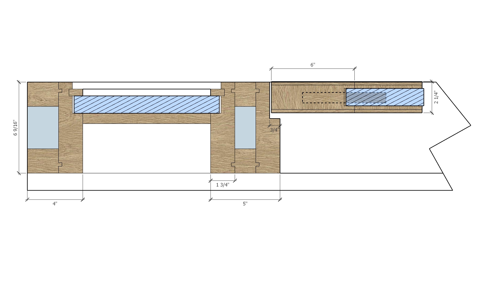

Ugh, I'm so hopelessly visual. Quick sketch to see whether I've gleaned from this conversation what I think I've gleaned.
If the boxes are big enough, like in this case, would you fill them with insulation or something? Or leave them hollow?

Yes, rip and size rigid foam to go inside the box mulls.
Epoxy is used at every joint. We also use the same silicone sealant we use to set glass. Why one over the other? Evolving discussion is about any pros and cons.

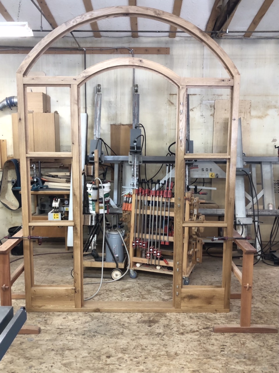

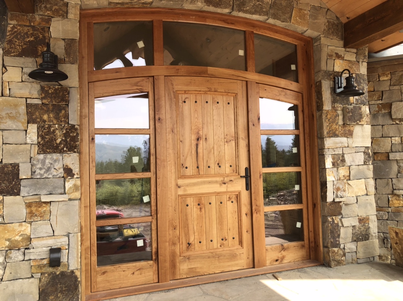

We build these large units a couple different ways.The first one I call fixed in place sidelights. The frame is built using door frame tooling 3” thick X 4 to 5” wide. The sidelights and doors are set into the rebates on the frame. To get jamb width usually 6 3/4” or more 8/4 jamb extension are set into the frame. This adds a lot of strength to the frame and that is very important with the door in the middle. Sidelights are installed into the frame with screws before glazing is installed.
This results in a thick heavy frame and sidelight - door that may or may not be acceptable design wise.
This is a double gasket 68mm thick Euro door but the same principles can be used for conventional US type butt hinged doors.
View higher quality, full size image (1280 X 958)
https://www.instagram.com/p/CFO-PV8jt2b/?utm_medium=copy_link

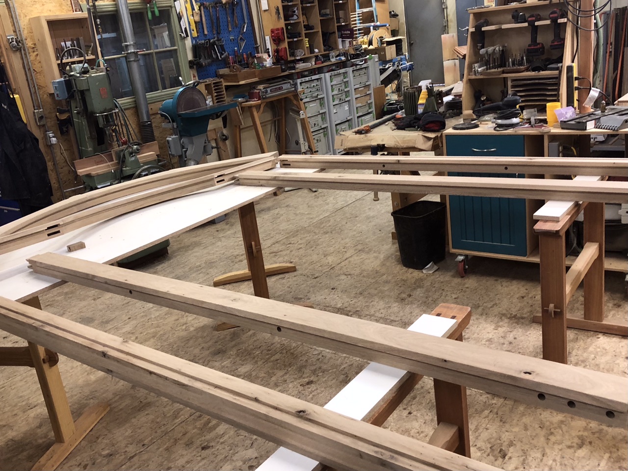

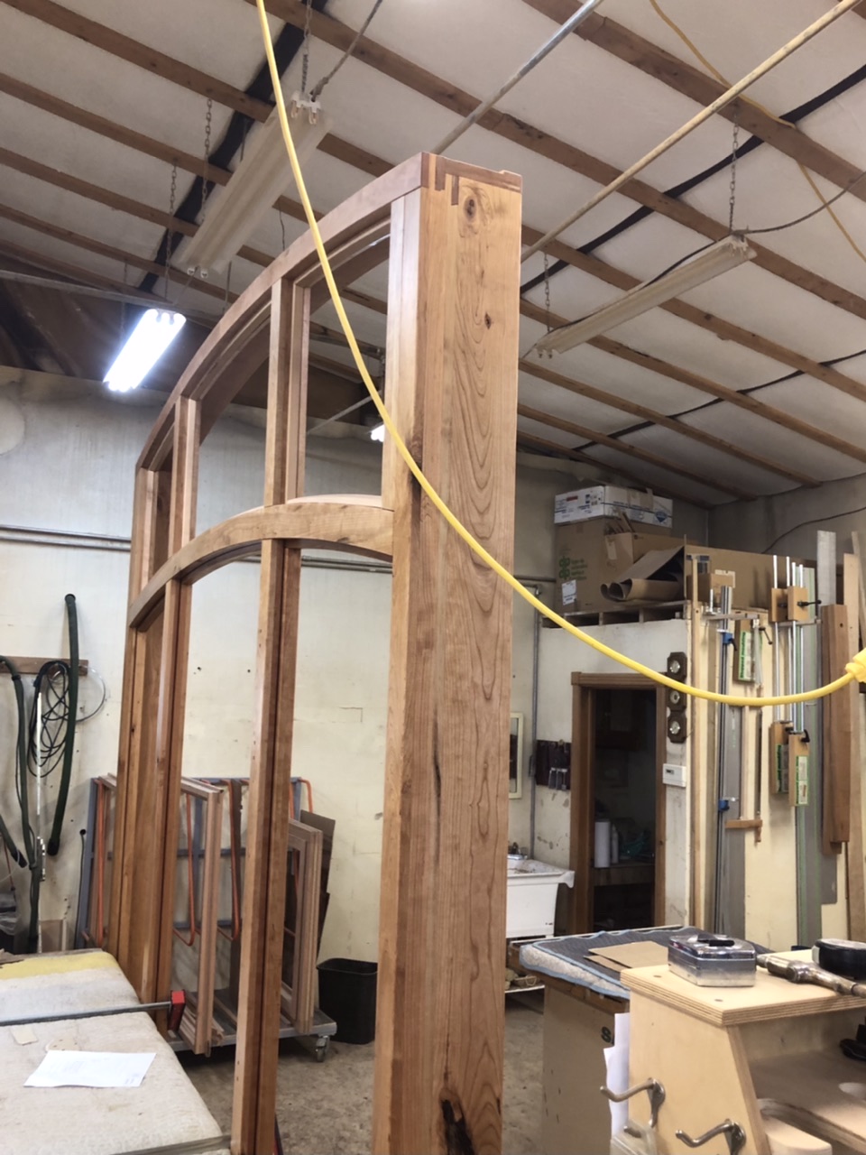

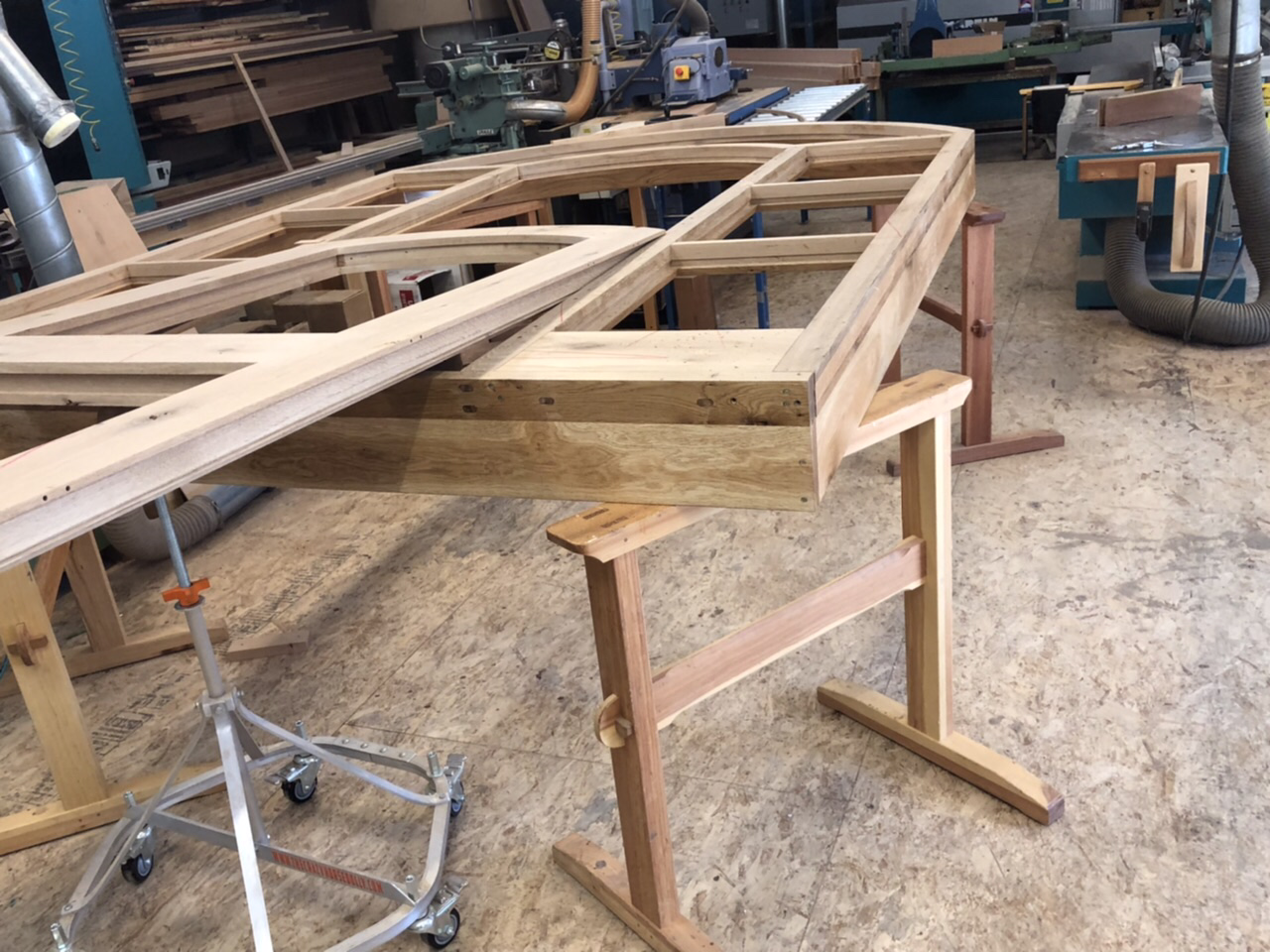

The second type construction I will show is a lighter construction that shows more glass. The door and frame is also built 2 5/8” thick. The frame is made with window tooling that will also accept the door and hinges. Using 8/4 jamb extensions this frame is as strong as the fixed in place type and has a lighter feel.
This frame is joined using tenons, dowels and Domino joinery. I use whatever is easy and strong for the application.
https://www.instagram.com/p/CLNujfHDLN5/?utm_medium=copy_link

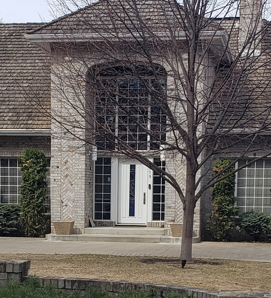

The issue they have is competing requirements within the design. The lady of the house has a design in mind, and the man of the house has his build material requirements. He wants metal clad, she wants a door with lots of curves and even mouldings on the face of it.
The house is actually quite nice, and whatever door they go with will hopefully be quite nice, too, but they have to figure out how to manage their expectations (which, to be fair, they are only able to do by having conversations with companies like us about what is and isn't possible with the various methods available to build doors). It's looking less and less like it will be a wood door solution we can offer.
