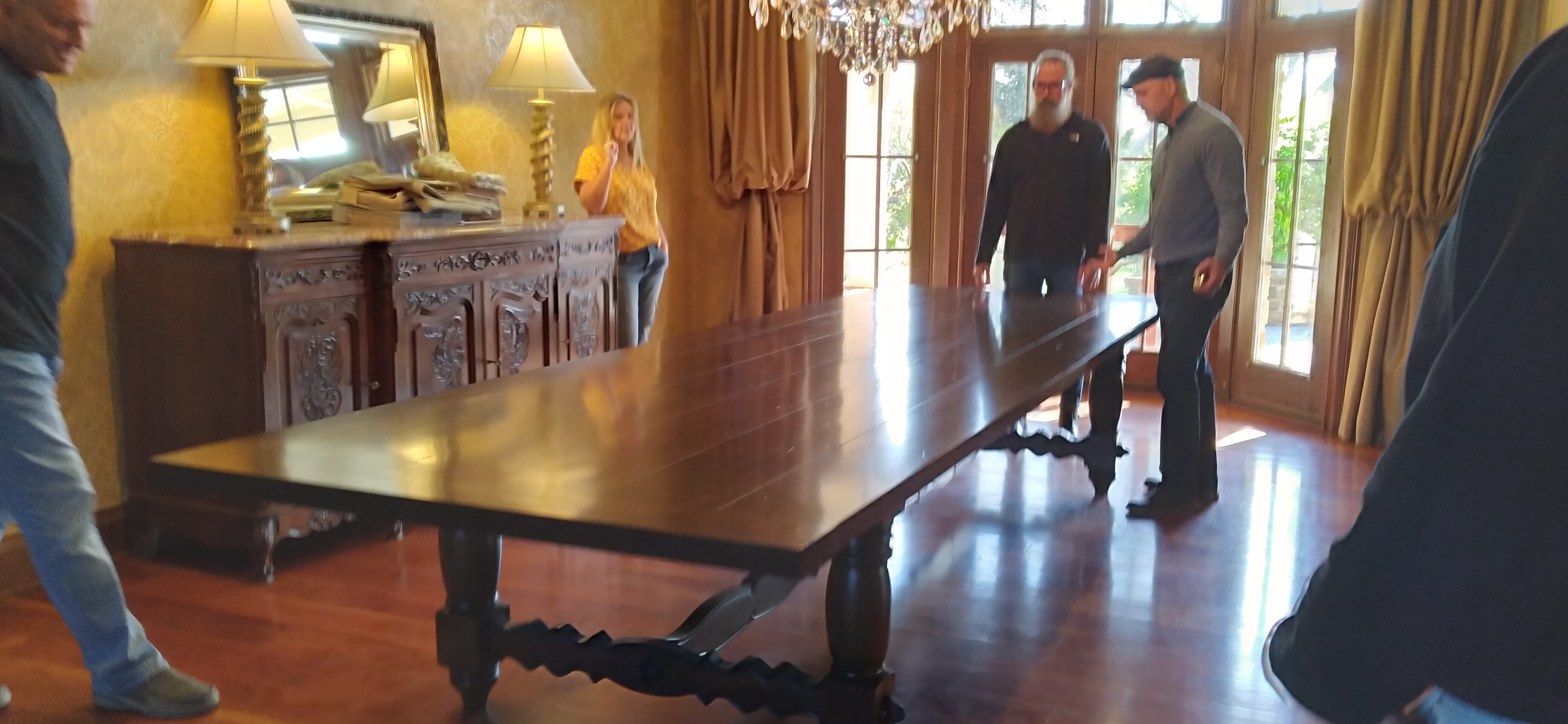

The two traditional solutions for this were worked out many years ago, before Ikea.
Dovetail tenons that slide into the posts from the top. A slight taper will make them go together well and be snug when driven home with a mallet.

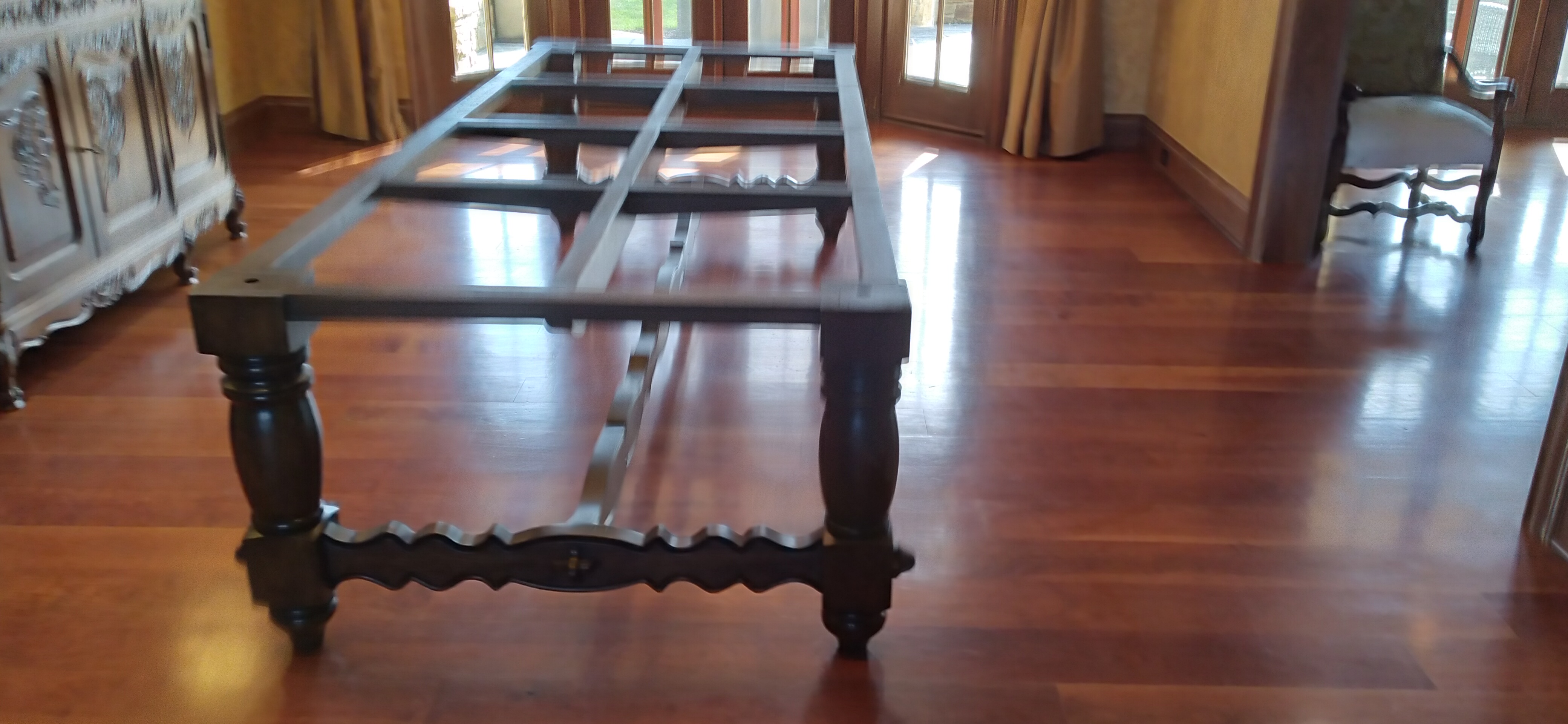

Tusk tenons may work if you can offset tenons at the corners. We just did a large table with tusk tenons. While it took longer to make and get clean mortises, the ability to knock it all down was very appealing.
The photos below show the table. You can make out a few of the tusk tenons. By the way, this table is inches over 20' long, and it is 2-1/2" thick with no more support than usual. Wood is better at spanning gaps than you think. I'd forego the steel and just add another stretcher, back a bit from the front, and then you make it deeper since no one will ever see it at that angle.
View higher quality, full size image (4160 X 1920)

David- The rails on your table- Its hard to see in the pic but guessing they are around 1 1/2" thick by 3" wide? Did you join those to the leg with twin dovetails or a tapered dovetail? Ive repaired a fair amount sliding dovetails that have failed.
The thru wedge tenons on the base- How do you avoid finish damage on install when you put the wedge in?
8/28/21       #12: Modular table ...
“Study your craft” is a phrase, a bit of really good advice from our moderator Gary Katz. I do not mean to imply that your craft was not informed. I asked that you expand your thinking to include wooden solutions. They were the First solutions in our craft. Metal solutions are sometimes considered quick and dirty by those of us with a historical perspective.
The upper rails each had a large dovetail fit in from above, driven in place at install. The lower tusk tenons went together like butter, and the tusks did not mar the surface. It was a “fast” angle, so it did not travel too far before tightening up.
