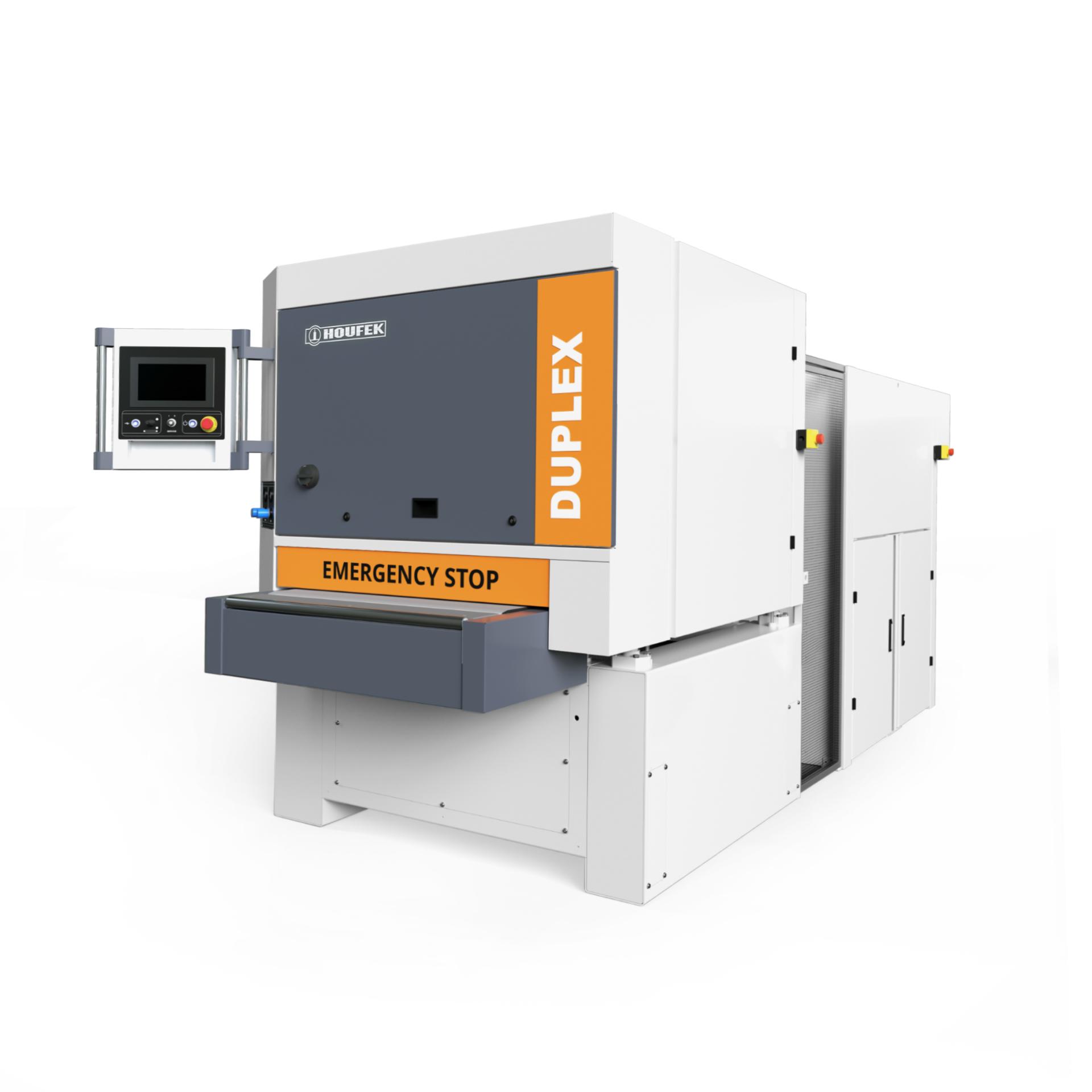

What kind of volume are you passing through your sander? Do you see yourself doing this consistently for years to come? If your volume is low or if you don't see this type of work continuing you can of course find work arounds. If this process is part of your business that isn't going away why not find a permanent solution that will increase efficiency and profit?
A double sided sander with a stationary bed would be a permanent fix that will cut your production time 60% to 70% without the extra handling you are currently doing. I have included a link to the page on our website for the proper solution. Feel free to give me a call if you would like to get an idea how much this solution would cost.
View higher quality, full size image (1920 X 1920)
http://nutekmachinery.com/duplex--series.html
