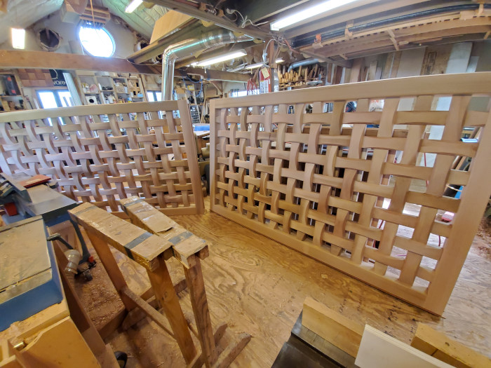

I trust my craft and make drive gates with no internal steel. I use real mortise and tenon construction, and maximize glue surface area. I design the infill to add rigidity. Some folks want decorative iron in the gate, so I will mortise that in and make it rigid. There has been no sag or change in any of the gates we have built.
If you use plywood panels, you can glue that in place to help make it rigid. But, filled gates have a hard tine with wind - the operators give way and then the gate flops in the wind and self-destructs. Or so I have heard.
Double tenons will double the glue surface area. Design the infill to help also with tenons and such to add rigidity.
6' is not too far. Post the dimensions or drawings and I can identify places where you can add rigidity.

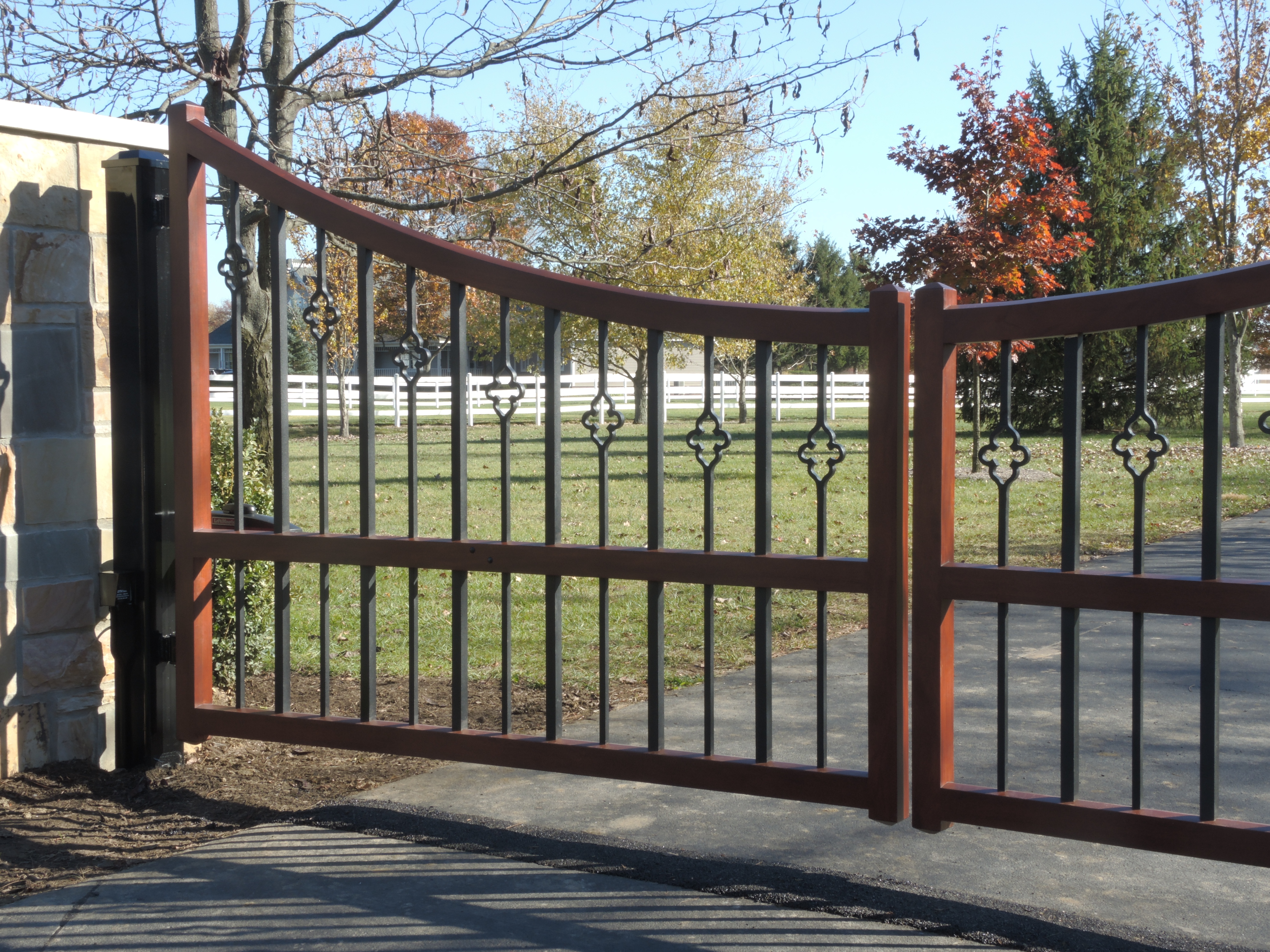

David, nice looking gates(ugly black mounting post though). Very interesting designs.
I was looking at what appears to be metal spindles in the one gate. Is there any issue with moisture getting in the spindle mortise? Or possible staining of the wood from the metal? Did you present those areas? If so, how did you assemble?
I was also wondering about the use of what looks to be western red cedar? I’ve never had luck with it as an outdoor wood for products that move or get used, with a finish on it. I’ve found it’s so soft, the first ding or bang to the surface, you have breach in the finish that lets moisture into the wood, while the remaining finished areas work to hold that moisture in.
I’m I correct in assuming those gates are light enough to negate the cedar wood fibers crushing at the joint?
Thanks, it’s always nice to learn from you.
11/3/21       #9: Driveway gates ...
Matt- Good questions. The spindles in the lightweight looking paired Mahogany gates are aluminum, and they are set into mortises with epoxy. They are tight fitting mortises and the epoxy seals out moisture. The rails on those gates have a crown or peaked upper surface - 10 degrees - to run water off, away from those mortises.
Yes, we have used Western /Red Cedar for several pairs of gates. We just don't get anything here but Cedar in 5x5 or larger, and clear. Doug Fir would be a good choice, but 10/4 is all we can find. Teak would be first choice, with no limits, but I don't get too many requests for Teak.
