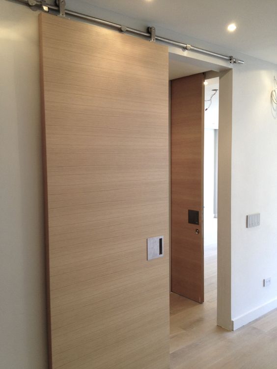

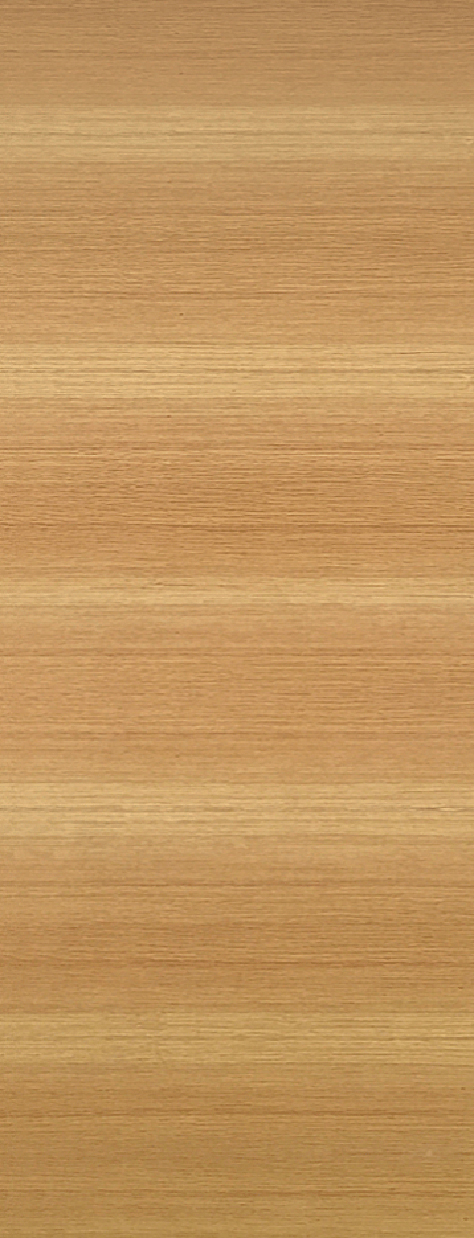

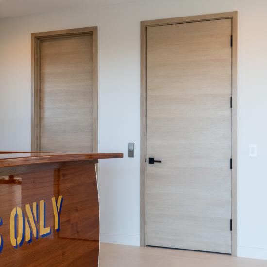

I am looking to build some rift white oak horizontal grain doors. I typically order 4/4 and slice my own veneer. Any thoughts on matching grain and colour? I'll try to add a few pics from online but not sure if this is real wood veneer or not. Not sure how they'd get so consistent with rift cut lumber.

Looks like a standard layup of commercial veneer to me. The manufacturer just orders sequential veneer packs and can easily have the same pattern throughout the home. The veneer mill makes all the slices of the entire log in a rift position. They don't take veneer from boards.

The photos are just a commercial layup of rift veneer. They would be getting about 42 pcs per inch vs your 12. That is why the color and grain are so consistent.
I would use a firm like Indiana Architectural Plywood to lay them up for me
