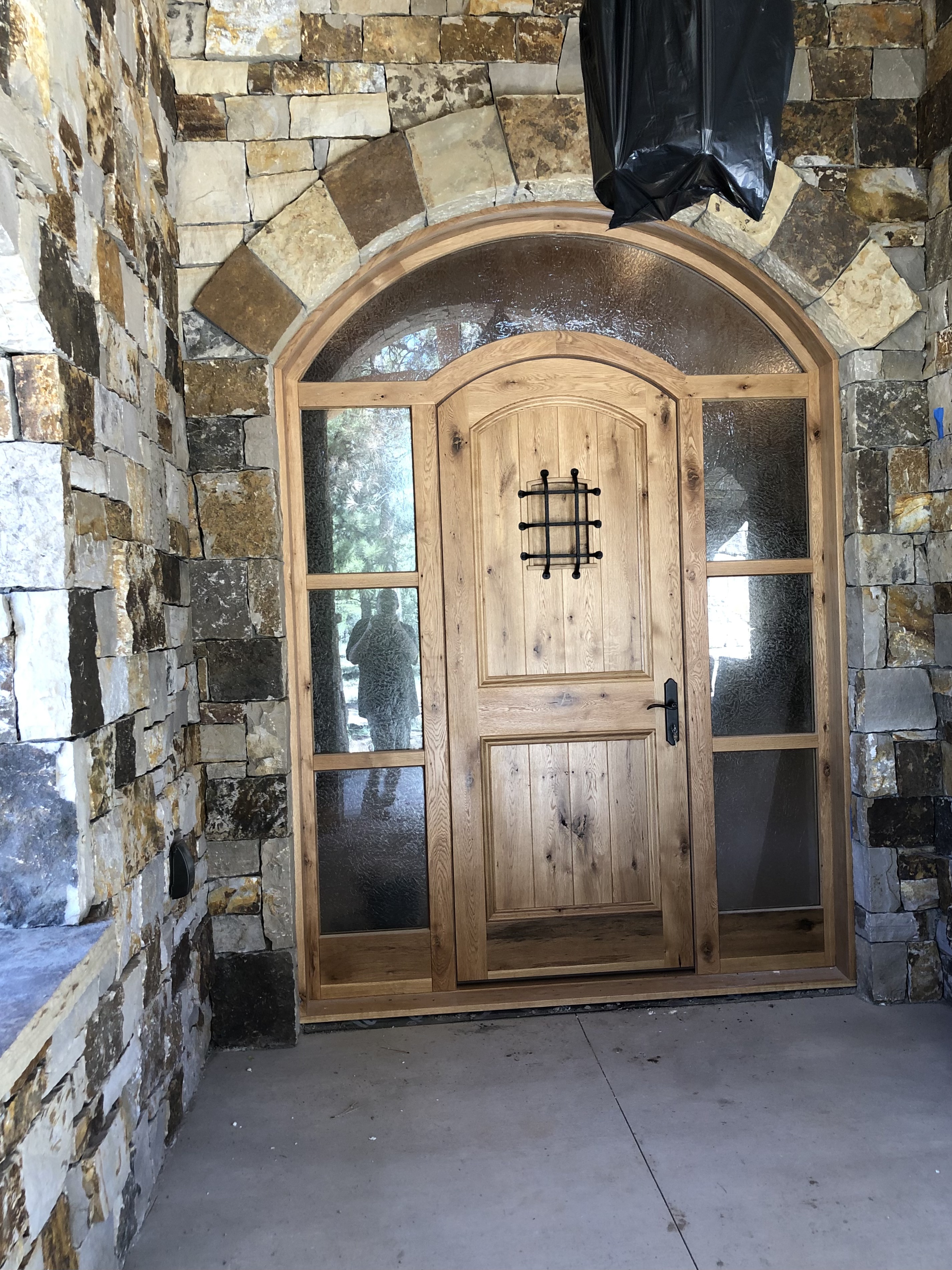

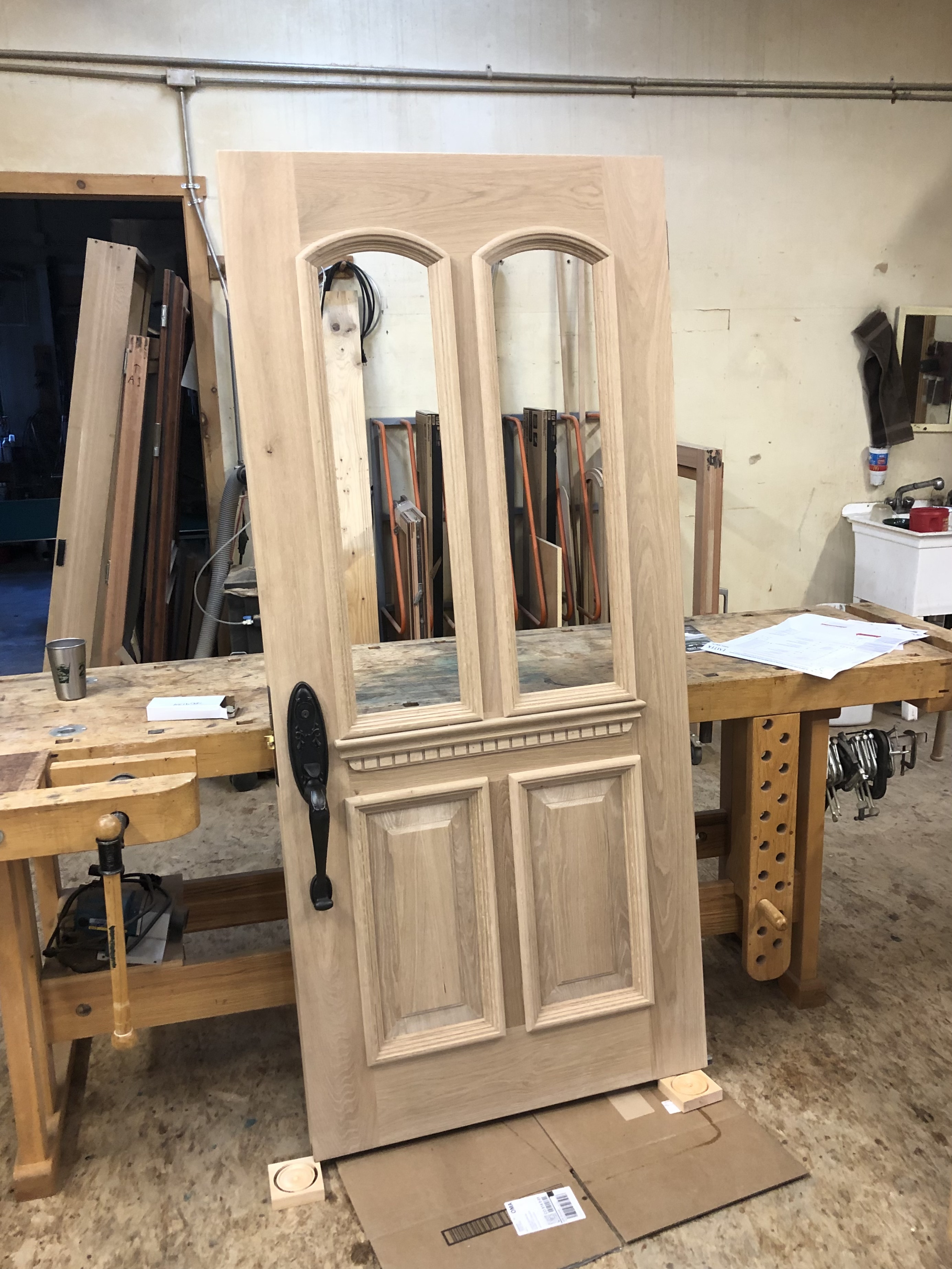

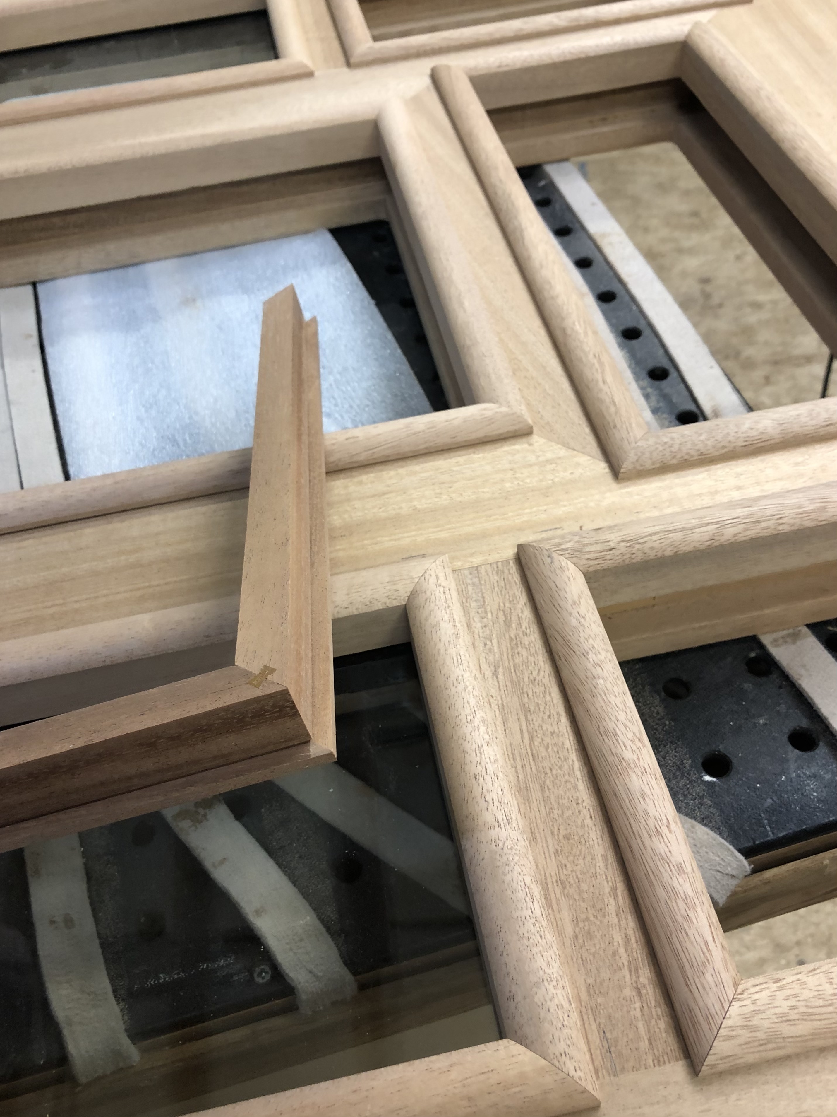

I’ve use one for years for both large bolection and small glass beads on doors and windows. It’s a good way to go and keeps the moldings tight. Makes finishing easier for beads on the glass side. And great for joining curves to straight.
I put a Instagram link that shows the process.

We have used them for years as well, everything from mitered hotel mirror frames to bolection moldings on exterior doors.
Key is to have a clean accurate cut on your miters. The Hoffman key won't pull a miter joint together that was cut on a saw with the blade not cutting at 90 deg..

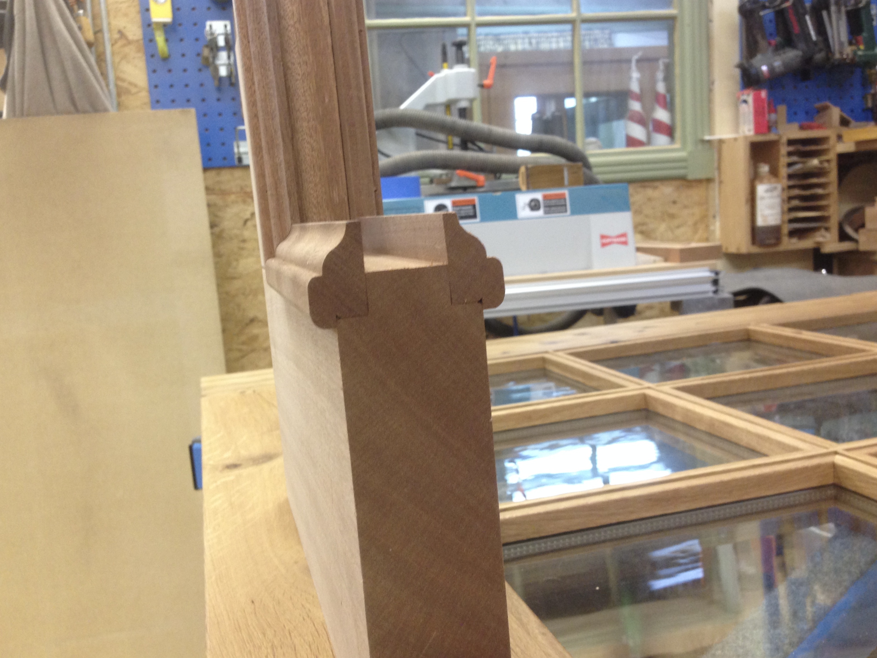

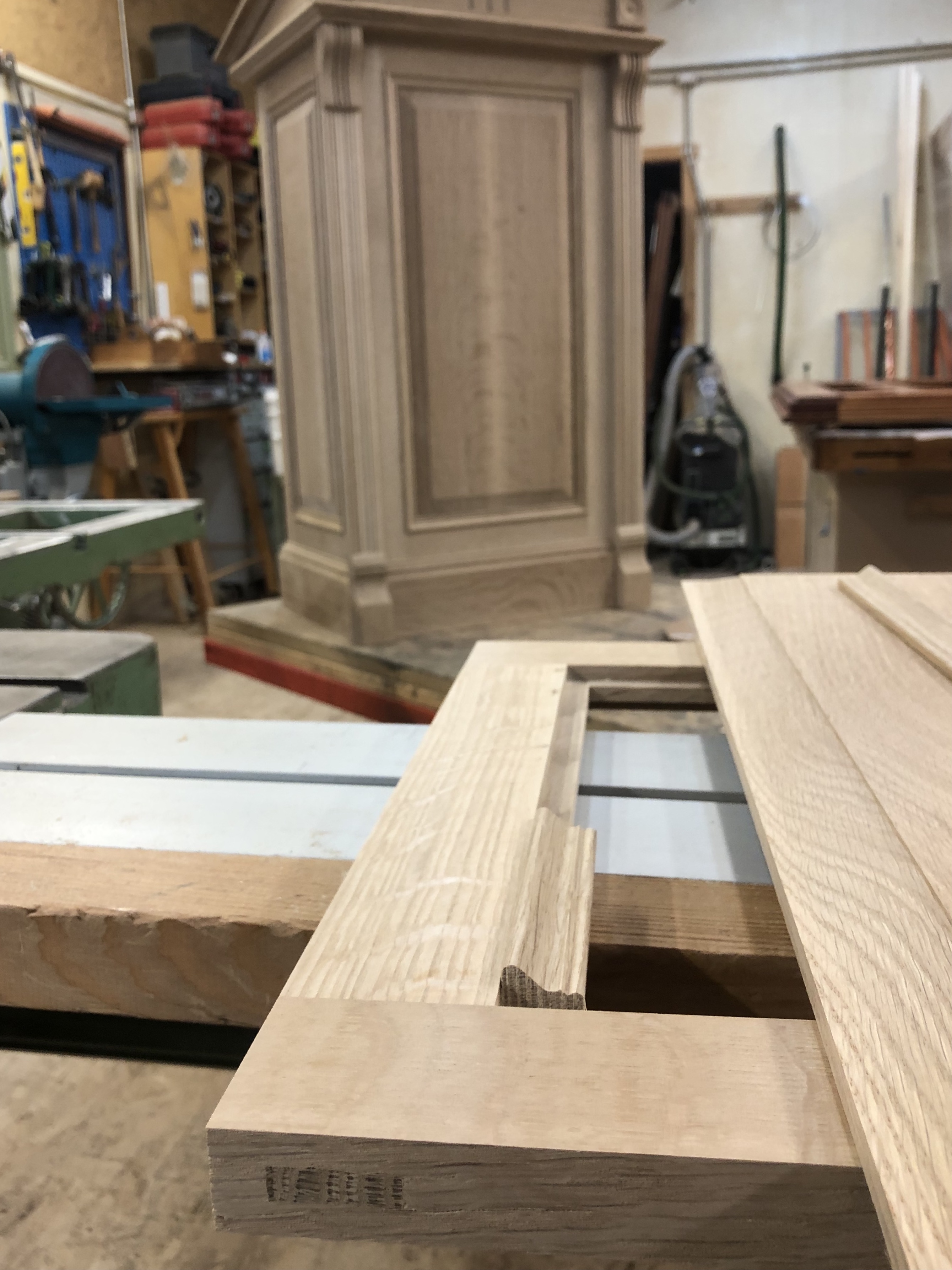

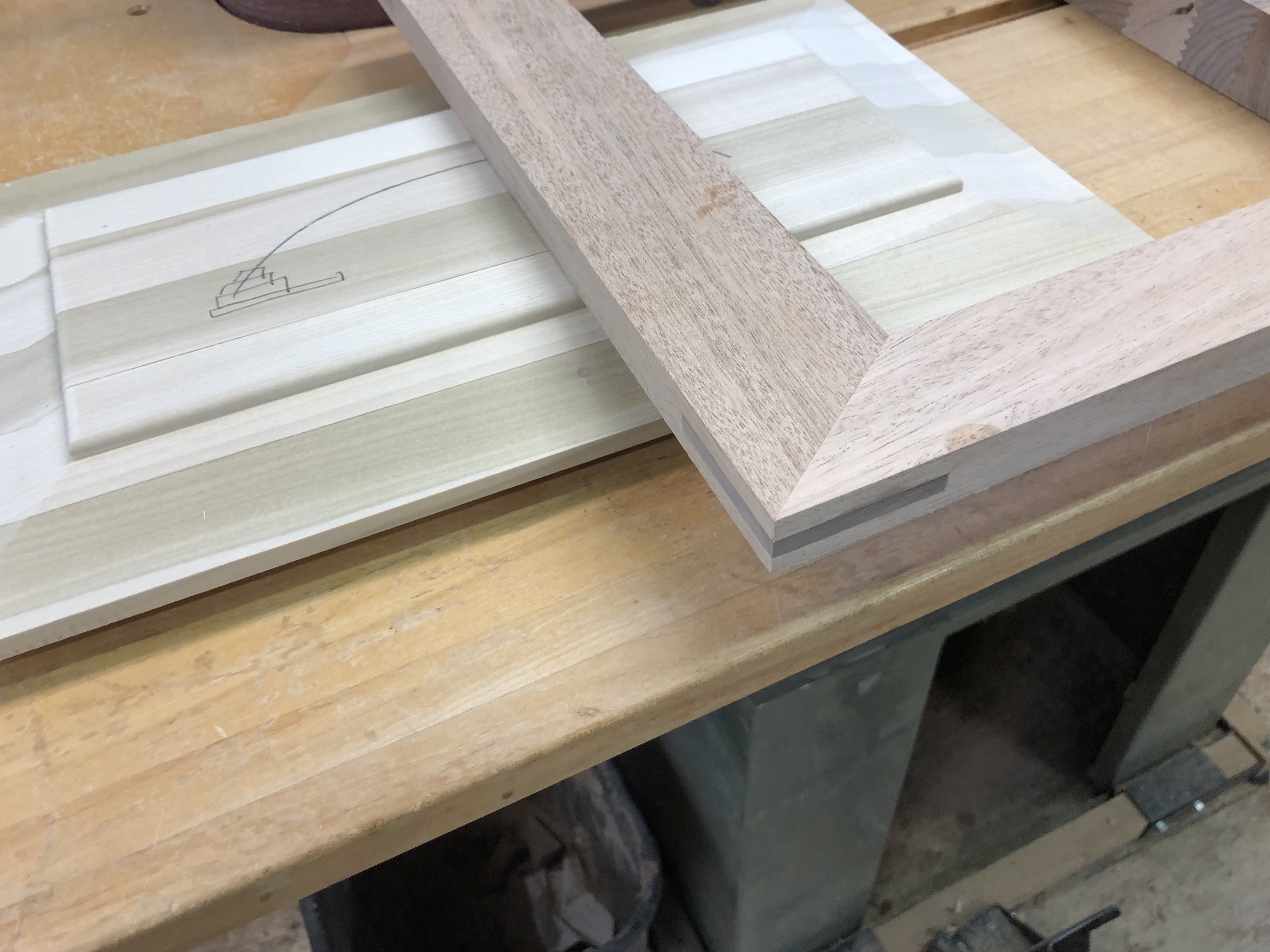

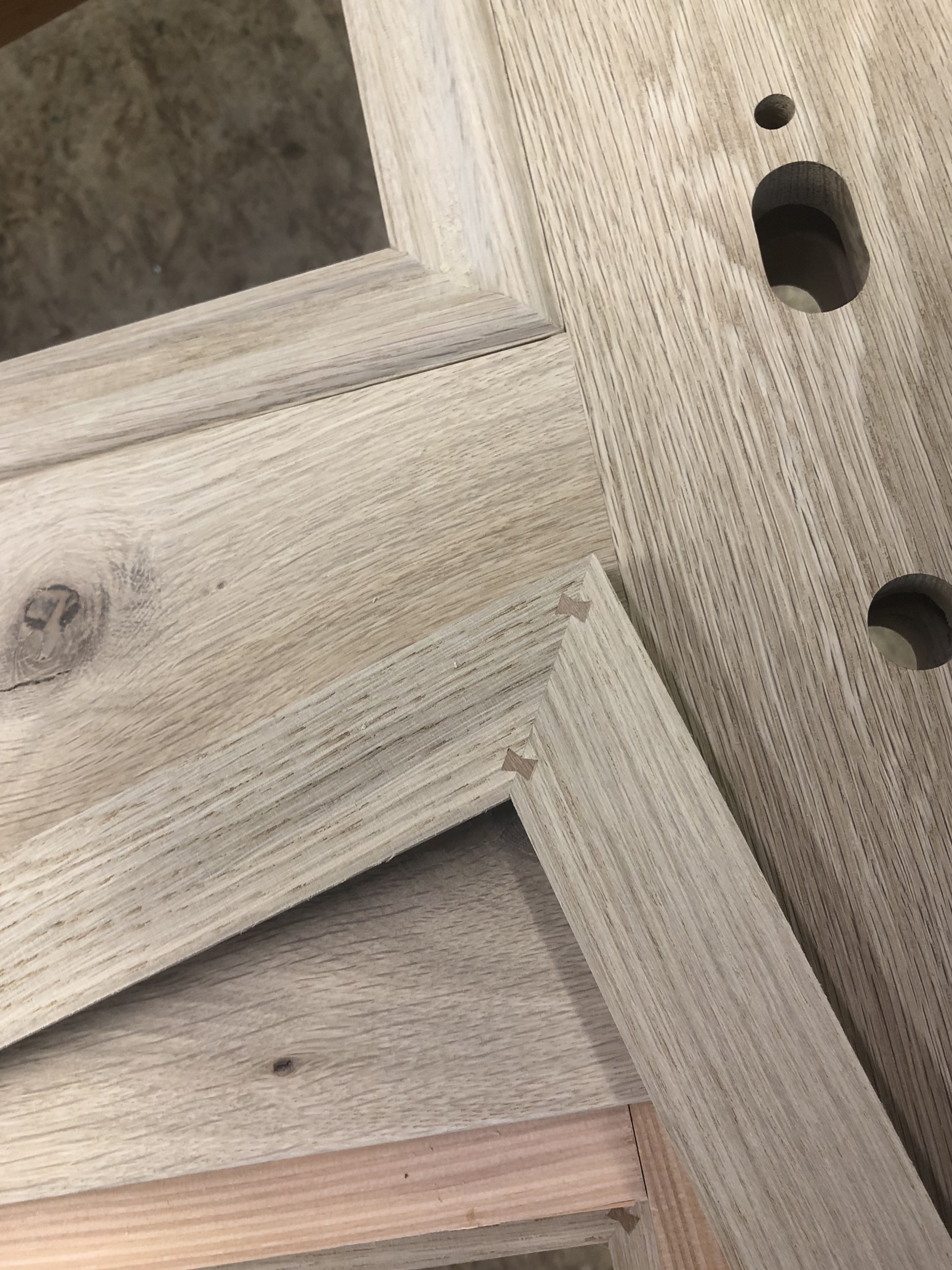

I don’t think I have ever encountered a door situation where the Hoffman dovetail was not strong enough. My applied moulding always sits on a ledge, not the panel which further adds to the strength. Even on furniture doors. The biggest advantage to the dovetail is clamping of the joint is automatic. Glue does not push out to the finish side through the dovetail joint.

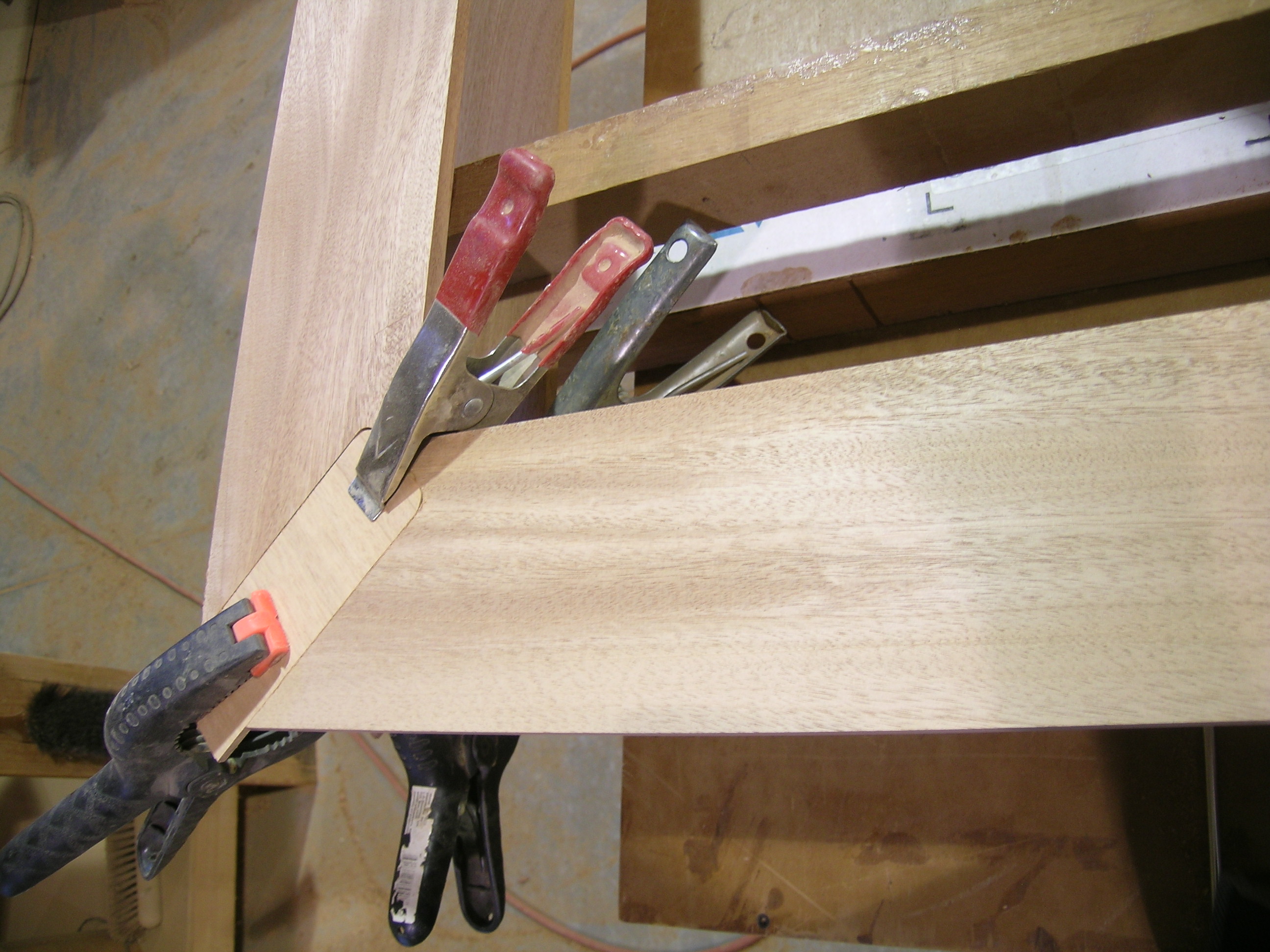

I could not imagine trying to put a complex glazing bead together and clamping with splines like the one in the picture below.
When I feel the need for a spline on a larger mitered frame I usually dovetail the back then cut the groove for the spline with a simple shaper jig.

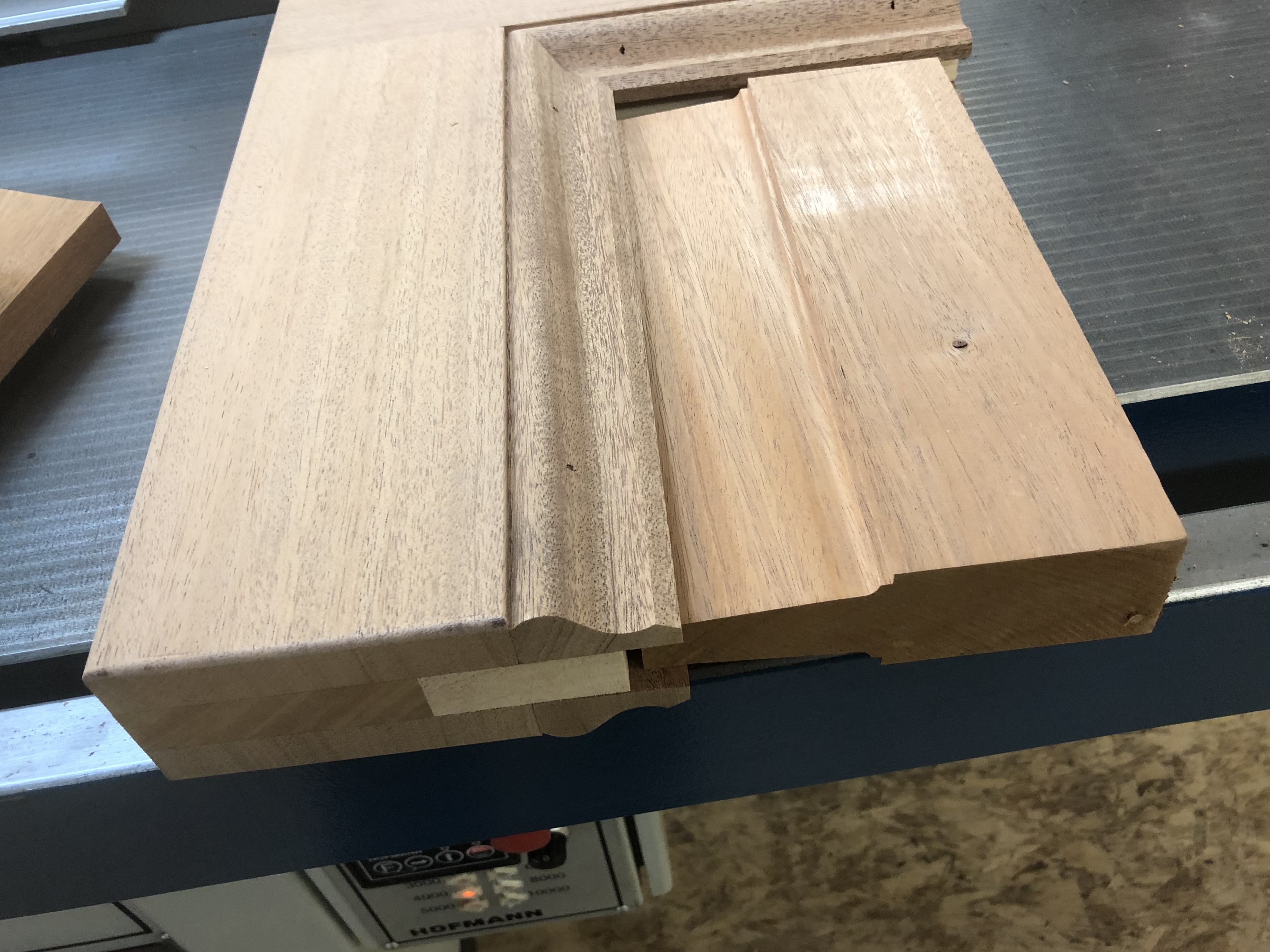

Joe's method of seating the moldings on a 'landing' is one thing that goes a long way to making a superior product. The land gives more glue surface and also reinforces any miter.

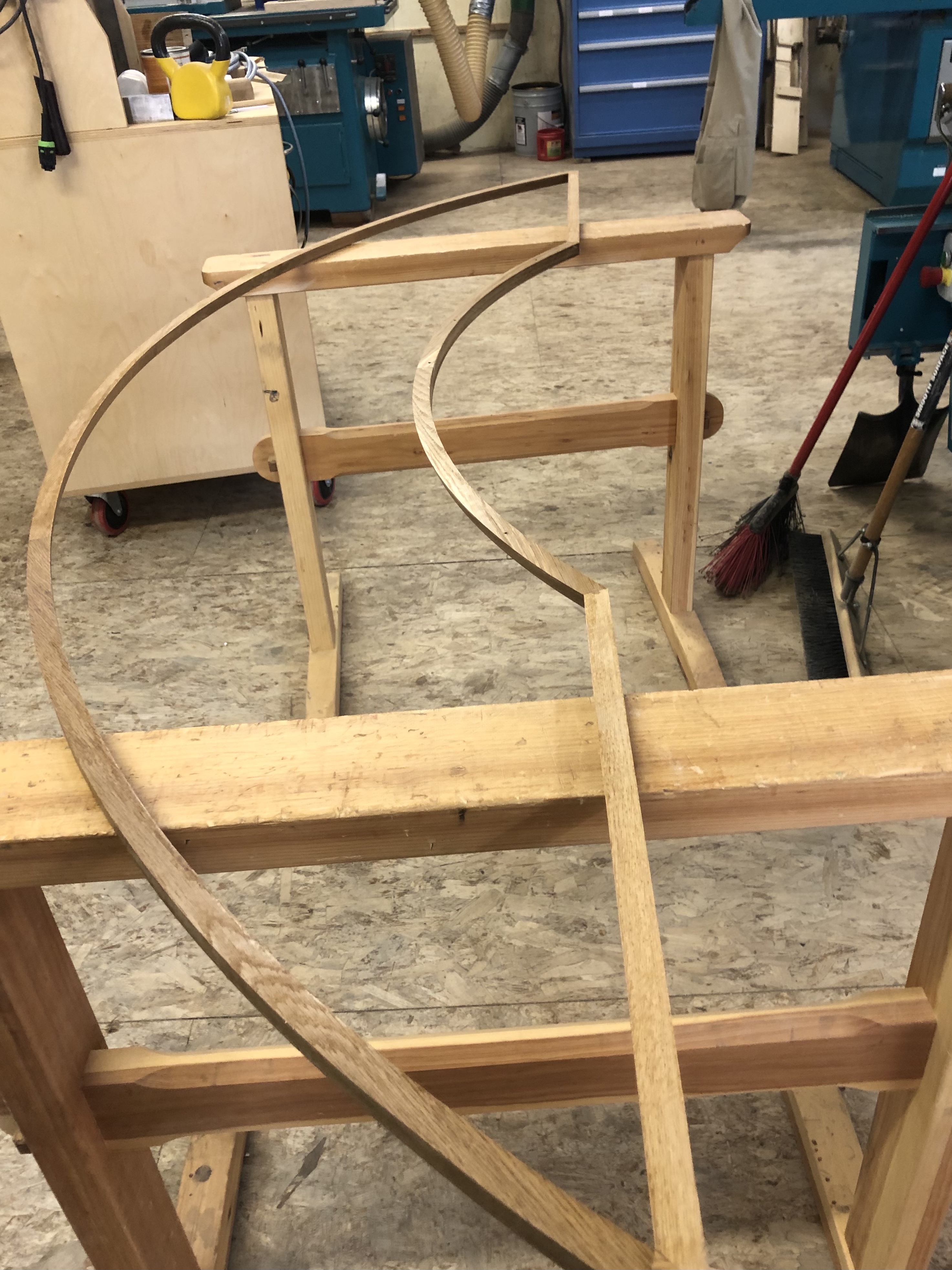

Mitered moulding corners large and small is about all it gets used for in my shop. Nice for window work and doors with glass beads. I did try it on a face frame once. It works but a lot better ways to do that. I do know a shop that uses one for small decorative boxes with mitered corners. They have a system in Germany where large dovetails are used to put windows together with mitered corners using long lengths of moulder scantlings vs the traditional slot and tenon method. I don’t think that ever took off.
Segmented curved parts can be done many ways but are usually fingerjointed here. I could see where the dovetail could work on some of these but prefer finger joints. The Hofmann excels at joining curve moulding to straight though.
