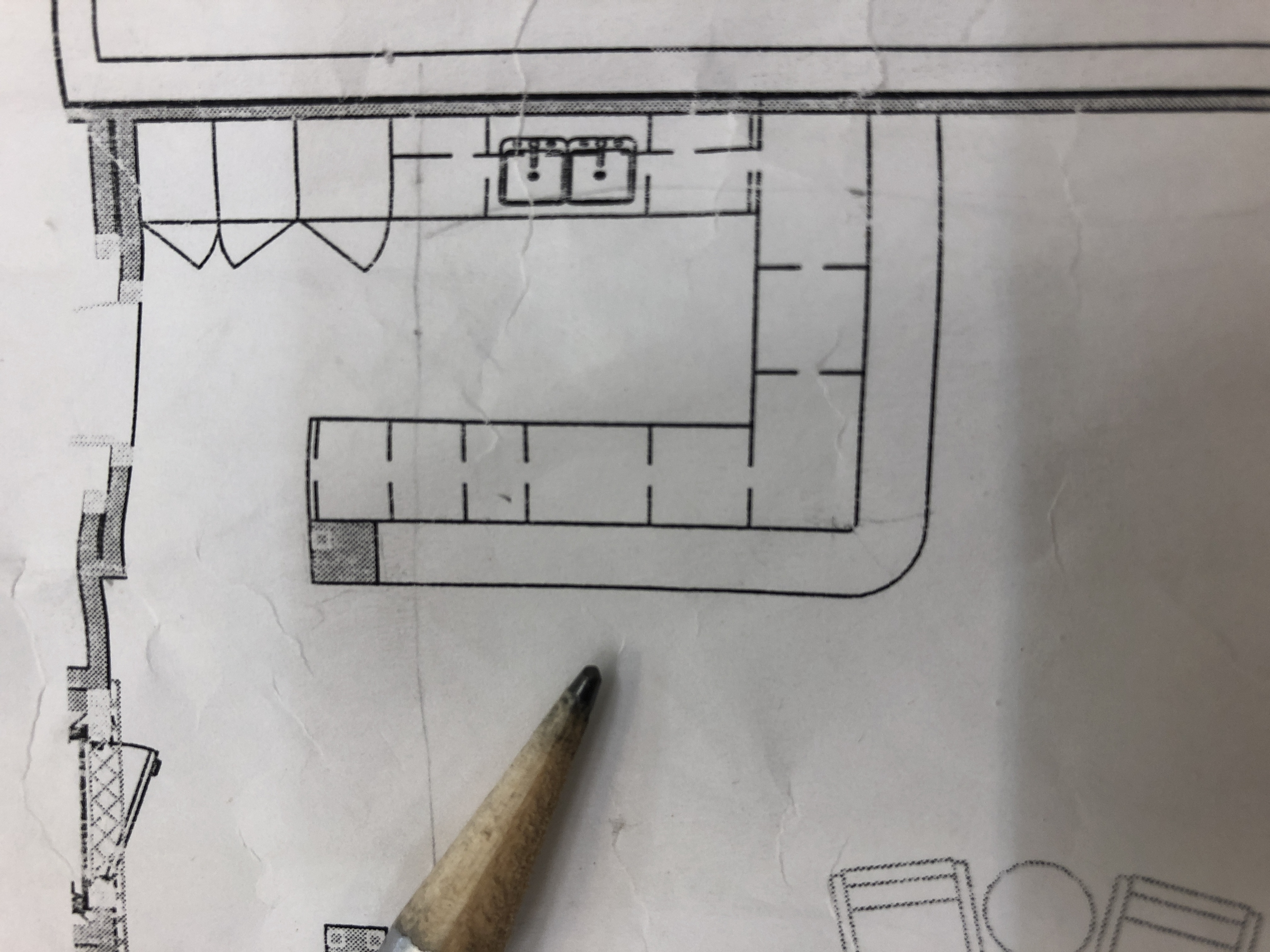

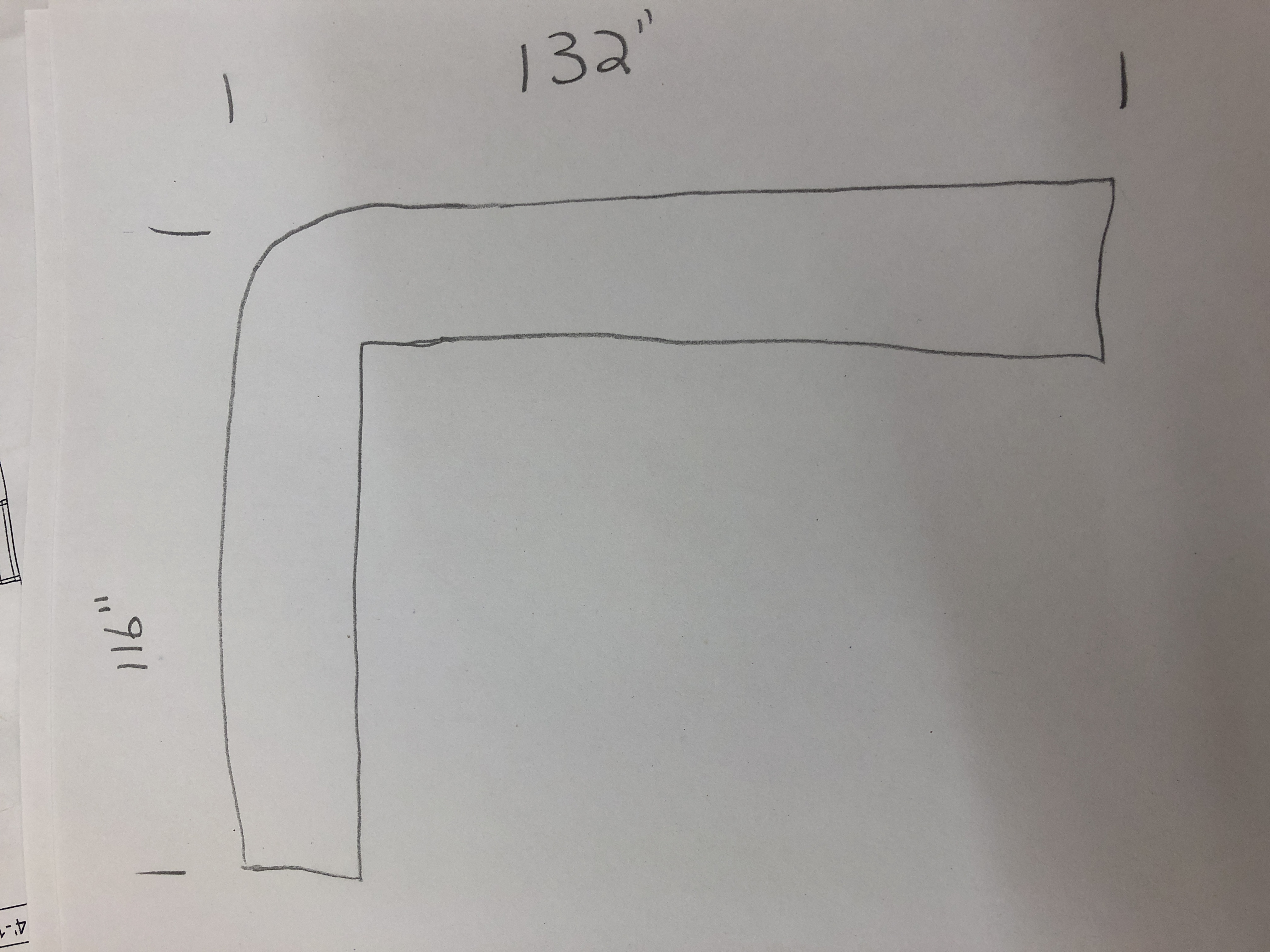

Hello all, I have to make an plain sawn white oak countertop/bar top for a basement kitchen. It will have to go into the basement in two pieces as that’s the only way to get it in. It’s roughly 16” wide and is L shaped. One leg is 132” long, the other is 116”. The outside corner of the L has a radius. They would like to top out of solid wood, but I don’t see anyway to joint the corners without having movement issues. What I have done in the past is to make something like this in 3 sections, two straight legs and a strip glued radius corner, joined together with dominos and countertop bolts. With this top being 16” wide, and a very tight radius, I don’t see me being able to make the corner piece. Does anyone have any suggestions or ideas? The pictures show what they are asking for. If I need to tweak it some to make it work, the architect is open to ideas. Thanks

I think I'd be looking at trying this in two sections with a 45° seam half way through the radius corner. That is the seam would go from the 90° inside corner to the center of the radius, just as you would find on a post formed counter. That way you can make two full length straight counter sections and temporarily attach them together in the shop to cut the curve. Then separate them for delivery.
The trick to doing this would be a sliding dovetail joint to bring the corner together. The problem would be that expansion and contraction are going to be trying to force that seam open and I don't know if the sliding dovetail is going to be strong enough to overpower the resulting gap. The thicker the counter top the heavier the dovetail will be, thus adding strength. Given the risk I would be hesitant to try this for a customer unless I could convince the architect to go with rift sawn white oak.
12/8/21       #3: Tricky wood countertop ...
How about 3 pieces. Two straight legs and a corner pie section with the grain direction at 45° Push for rift oak to minimize the expansion. Glued Domino on the outside of the joints and expansion fit on the inside with countertop fasteners drawing them together.

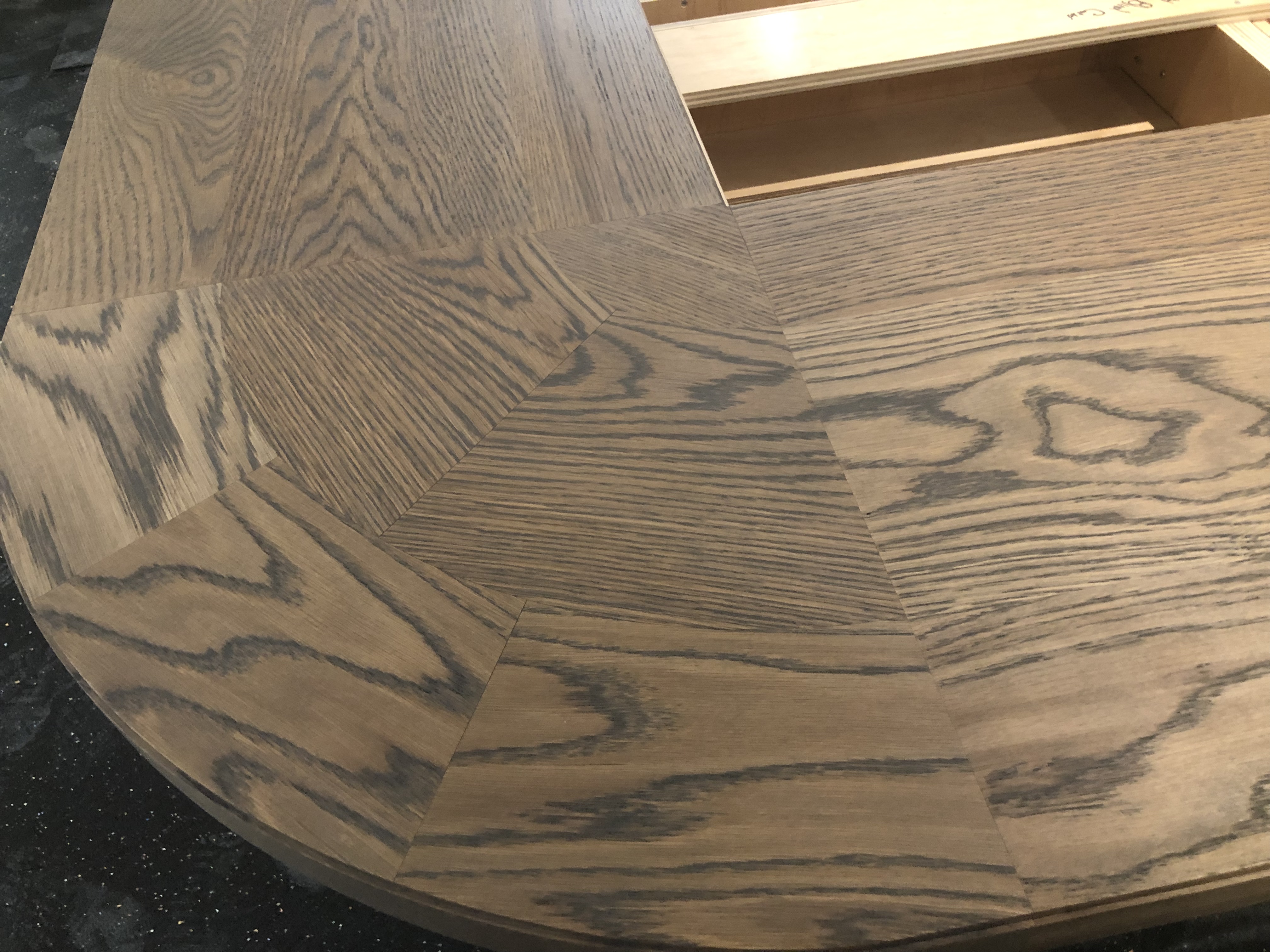

Matt Calnen
This is what the flooring guys did. The shrinkulator says it will move 1/8” for quarter sawn, and a 1/4” for flatsawn white oak. I still think that’s to much to miter.

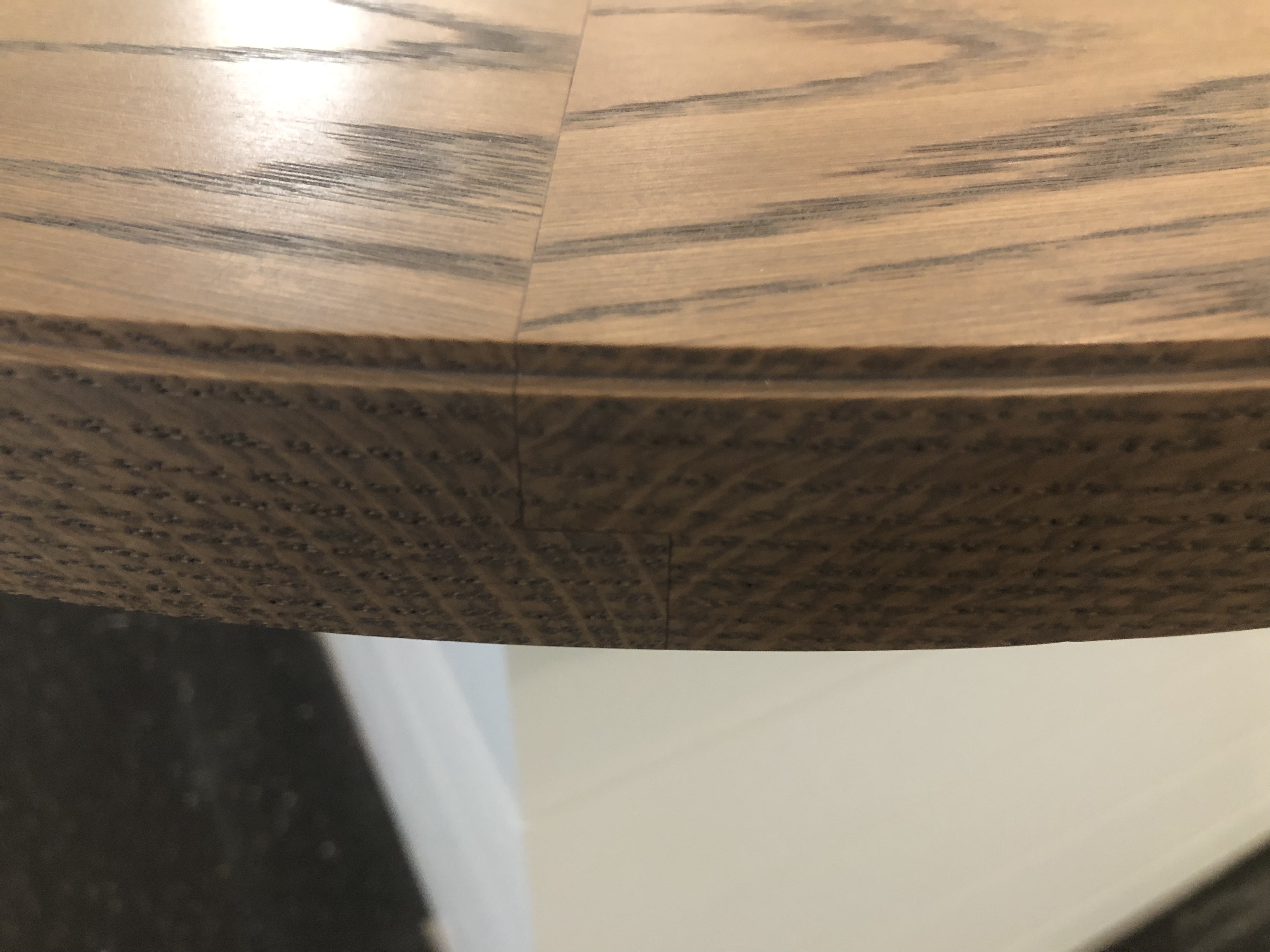

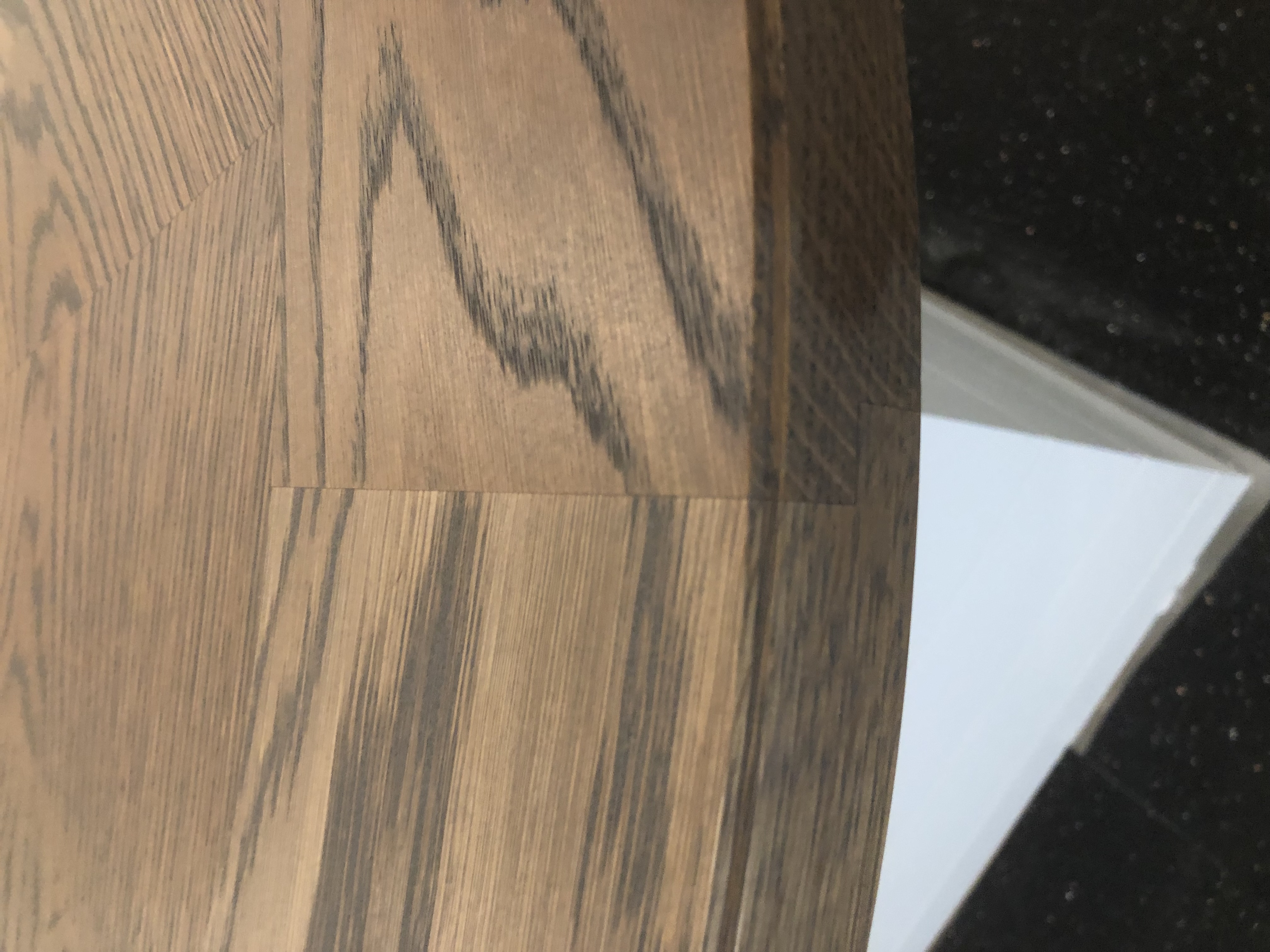

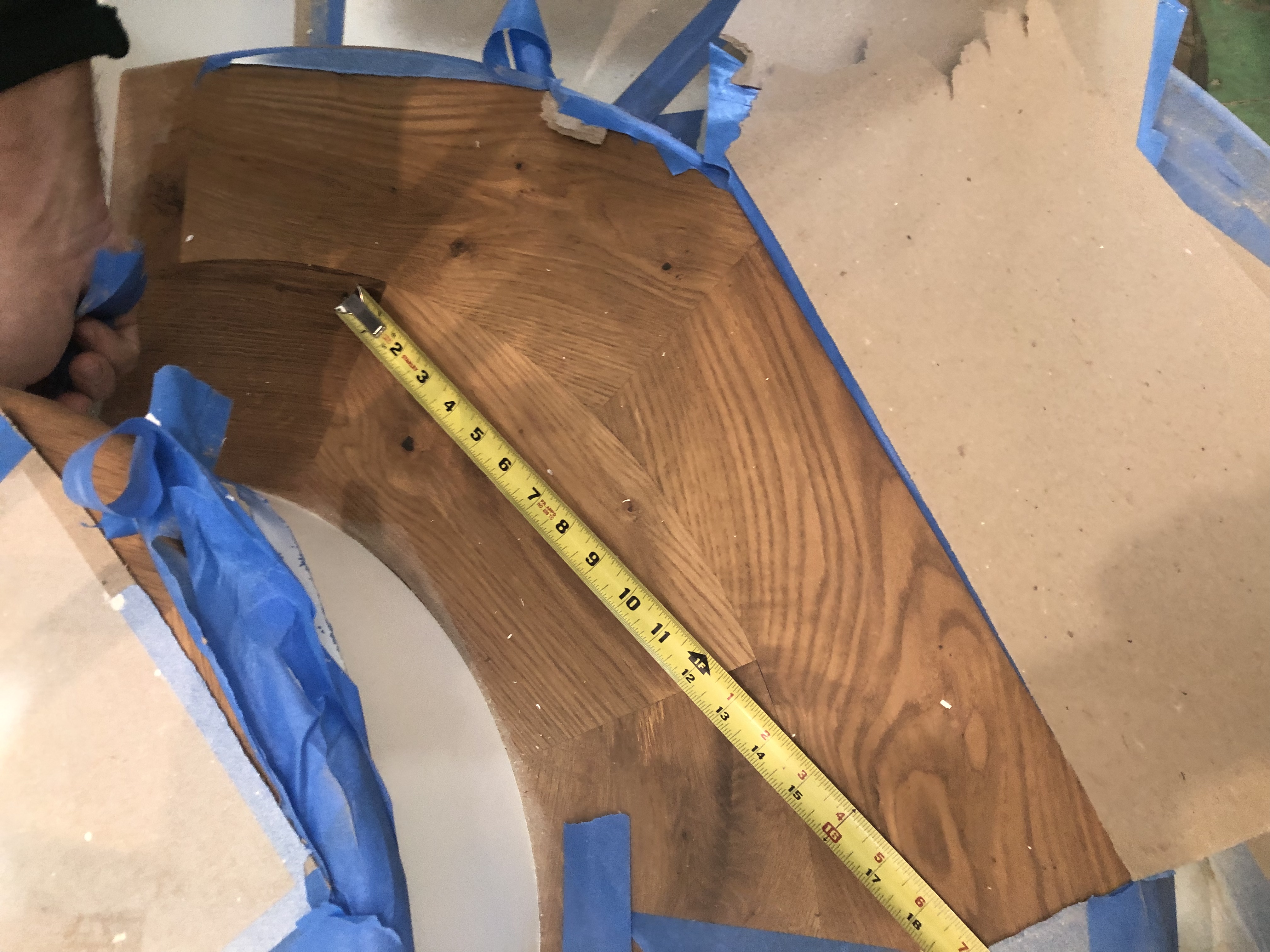

Matt Calnen
Well, the owners where going to have a party, and needed the top put in. I did the best I could, epoxy, half laps, and domino’s to try to keep it all tight. Time will tell. The builder told me not to worry about warranting anything, it was more important to keep the customer happy. Thought I would follow up, thanks for all the insight on this thread.
