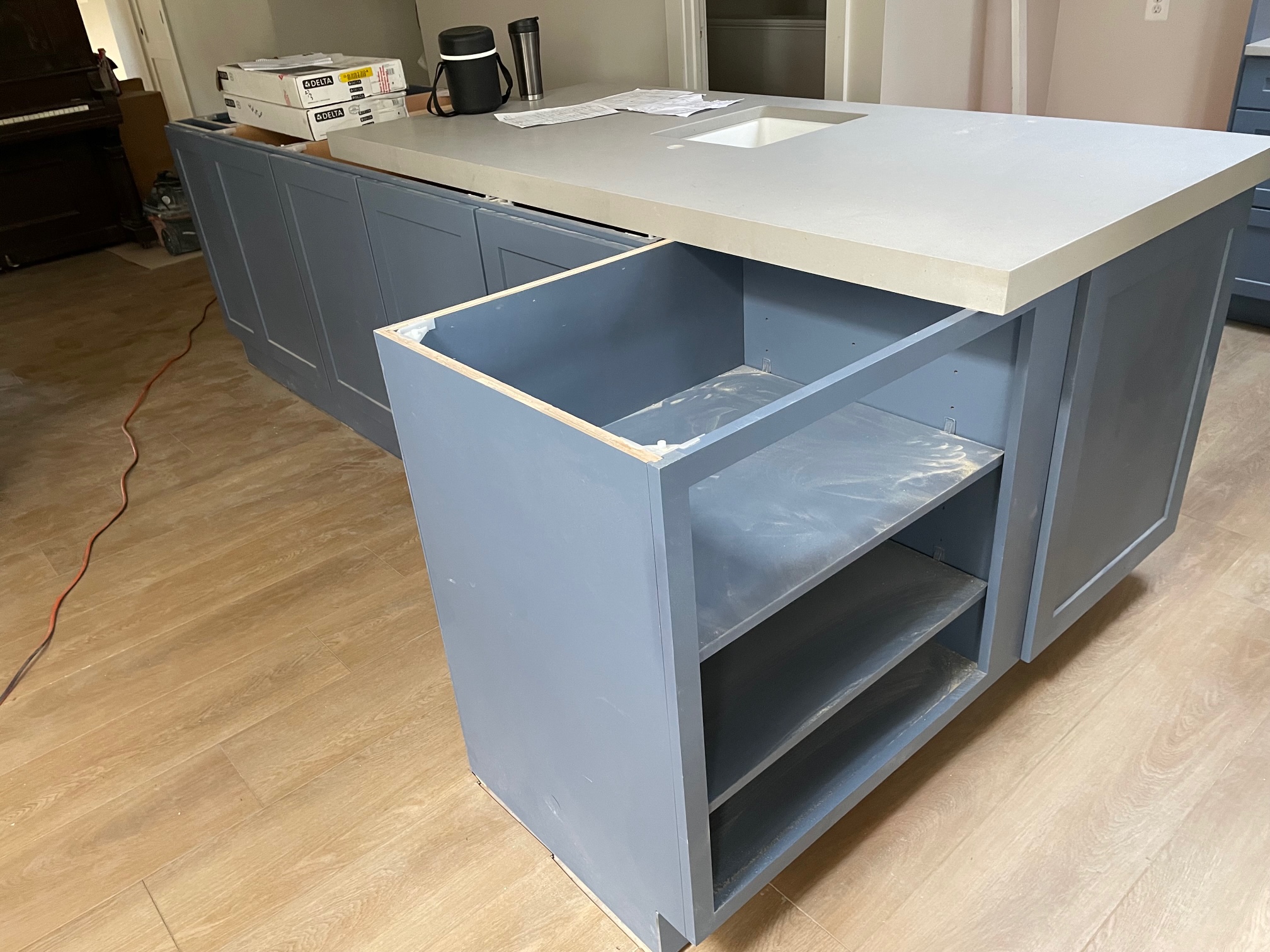

We're constructing an edge-grain maple countertop to wrap around two sides of a 36 x 72 quartz counter. The stone counter is 2 1/2" thick with mitered edges turned down for thickness. Our top will join the stone on two edges to form a 2 1/2" x 5' x 10' island top.
Owner understands there will be movement so wood will not always align with the stone.
I'm thinking of hollowing out the underside if the wood top to save weight (approx 100 lbs) but also to allow us to connect to the stone counter with threaded rod and nuts. Planning to leave a reglet in the wood top so we can fill with backer rod and caulk to keep the joint water tight.
Anyone think the top might cup with the hollowing out? Am thinking to rough out hollow sections then glue up and smooth underside and top after. Glue up will be in a couple of phases given size and complexity.
Anyone have experience with this. Thoughts/comments?
Thanks in advance
HRM

I dont know what the gain would be to relieve the back to dump weight in risk of movement? Your going to be lighter than any full thickness top regardless. The cabs wont care, the floor shouldnt care, what would the motivation be to overcomplicate it? Leave it full thickness where its most stable would be my vote.

The stone should be the landmark, fixed, not moving. Fit the top to 1/8” or less, with colored silicone in the gap, no recess (cut it off flush). No need for threaded rods or standing on your head. Just use slotted mounting holes in the support members, allowing the top to move, as predicted in “The Shrinkulator”.

I personally would not do it. Sounds like all the problems that will eventually happen will get blamed on you. The only way I would venture into this is to be paid immediately after I set my wood tops and no warrranty what so ever and do not expect me to return your phone calls. The joints between the wood top and the stone will forever move at different rates, silcon or what ever you use between them will be always be a very ugly joint, whatever you use will only get worse with time. No matter what you do your name will always be with this project and so will your reputation.
