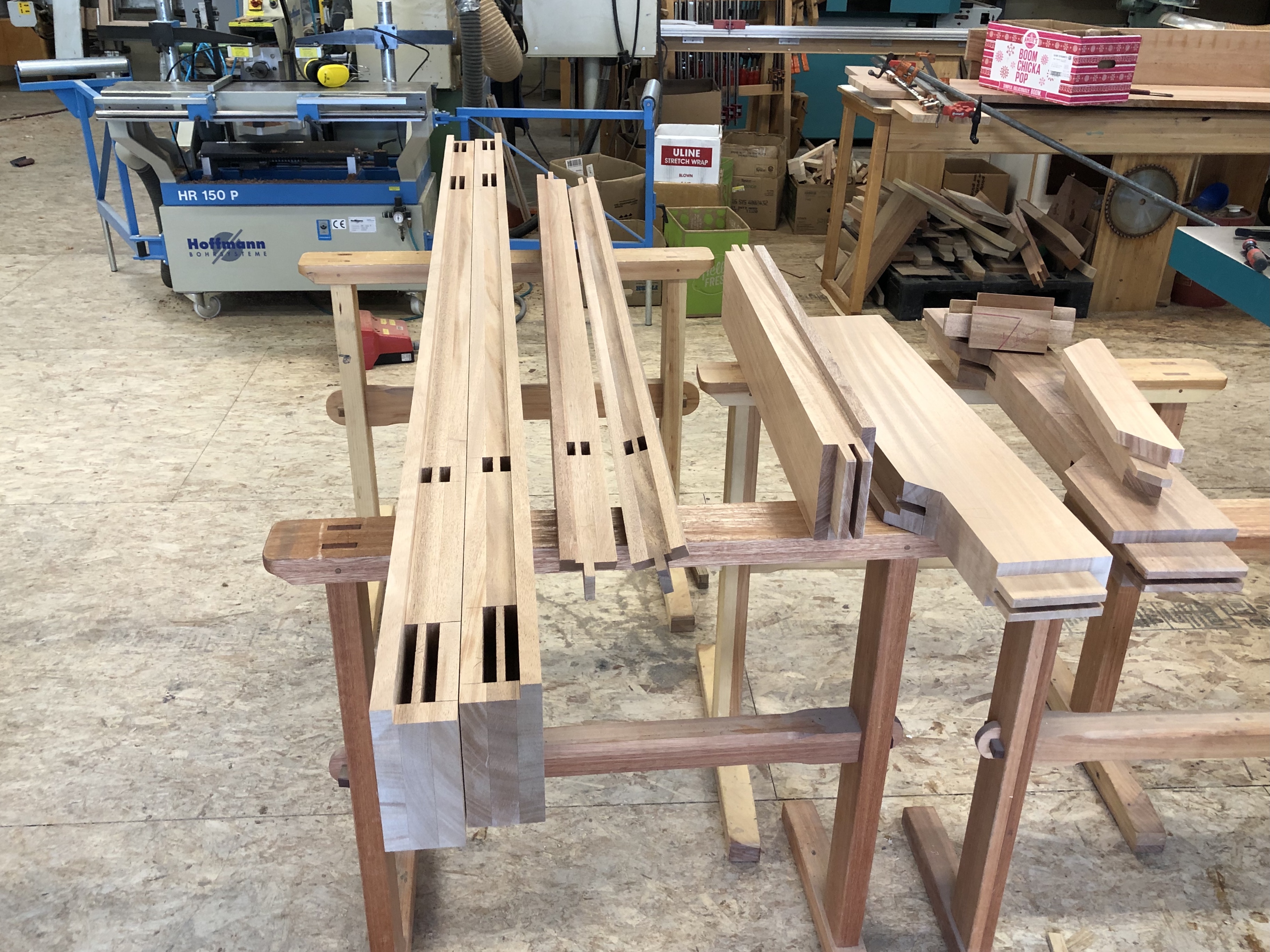

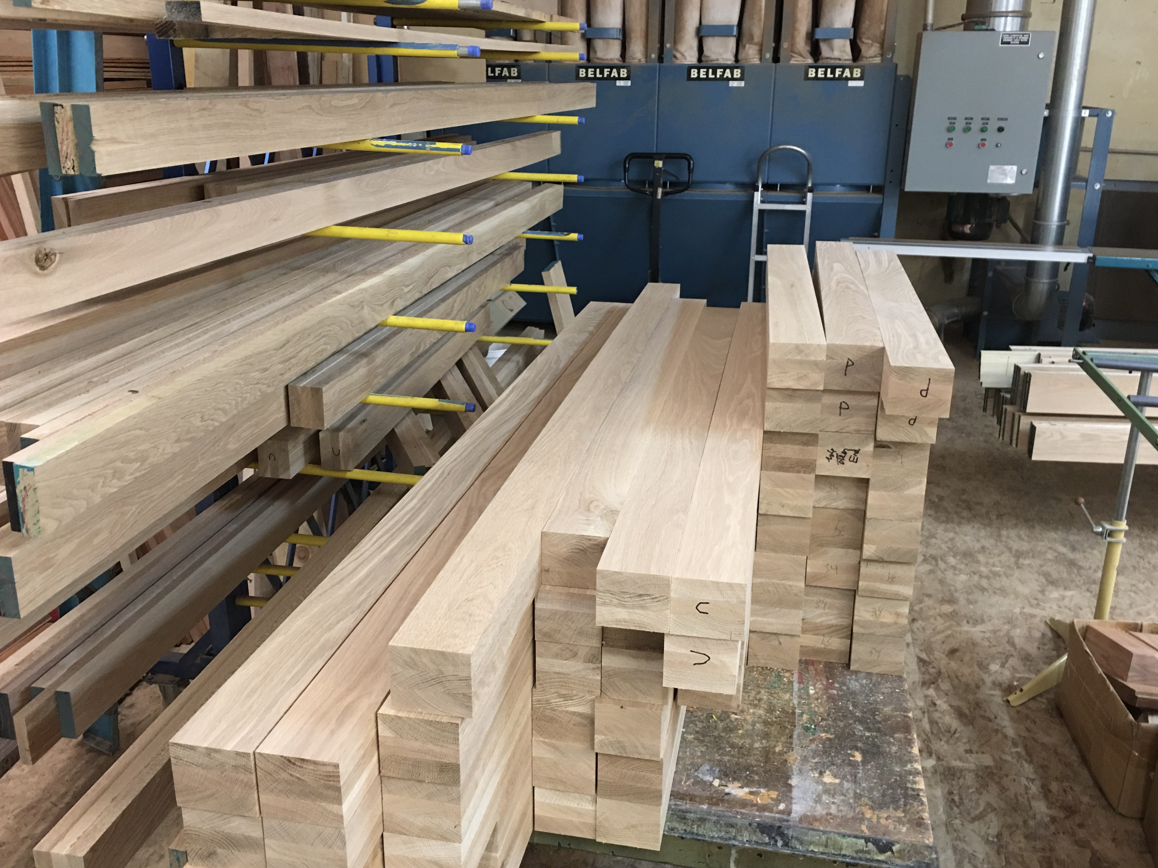

Joe Calhoon
2 layer laminations for door stiles is a bad idea. It’s ok for shorter parts like rails but not stiles.
I typically use 3 layer solid for my 68mm thick doors and sometimes 56mm thick when I cannot get suitable solid material for these. For 1 3/4” thick doors 3 equal layers is not a good idea. I prefer solid or engineered stave core for these.
Important on the 3 layer construction is to alternate the grain of the 3 laminations. For 68mm thick I use well faced and planed 5/4 24 mm thick. Blanks are 72 mm thick and faced and planed again or sent through the straightening moulder. For 56 mm thick similar process using 20mm thick material.
Quartered and rift material preferred but not always possible with the wide range of materials we use.
