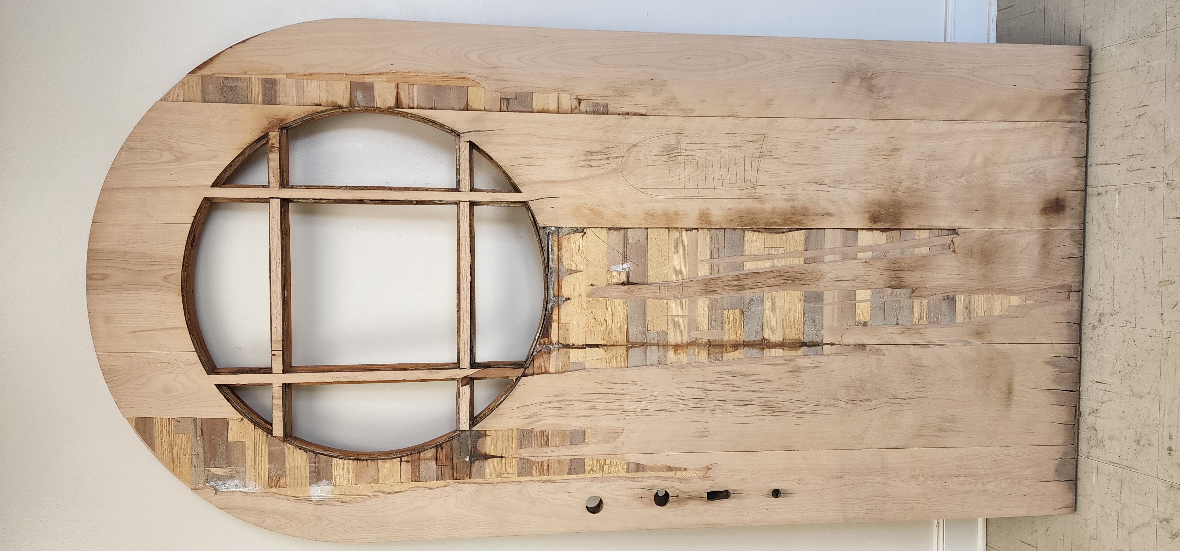

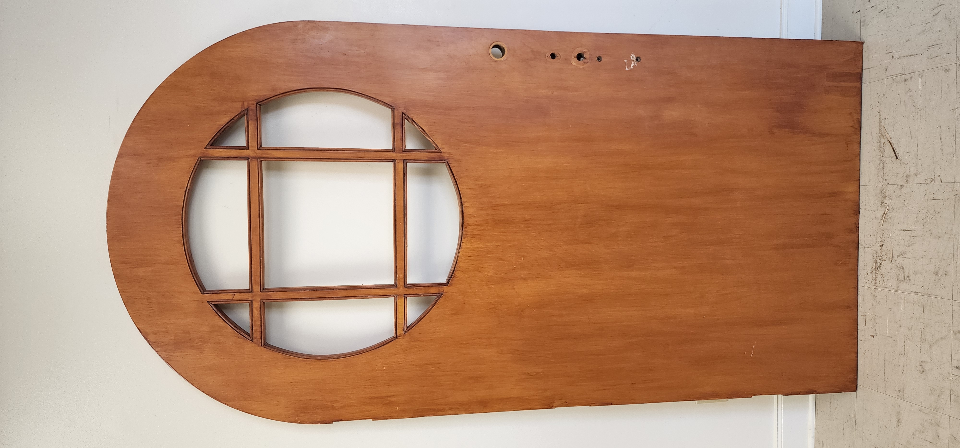

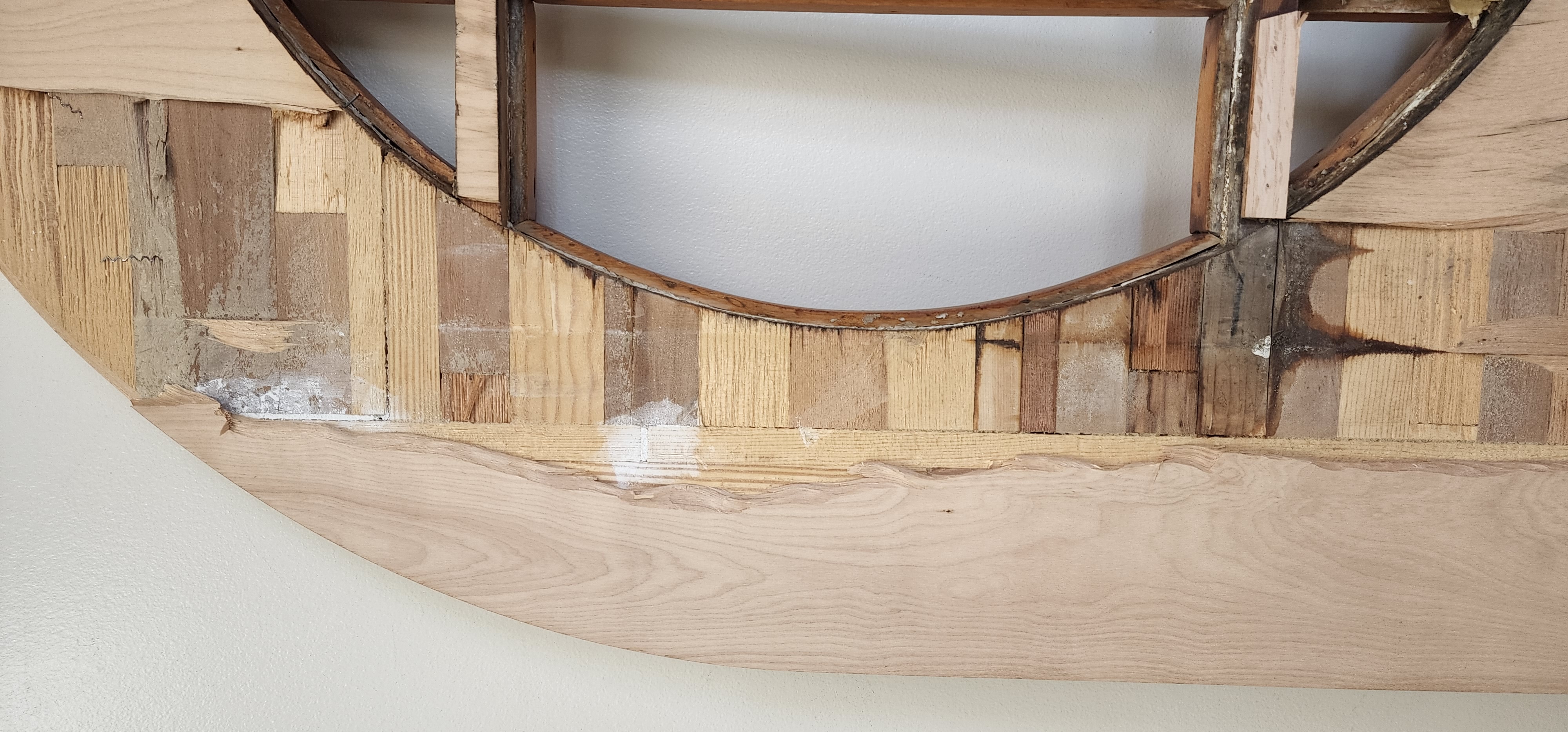

We are getting ready to replace this exterior door. The original door in the photos has a core of pine that runs horizontal except for two 5 inch pieces that run vertical like stiles. This core has a 1/4 inch crossband that runs vertical and then veneer on it. The door is approx. 70 years old and is pretty darn straight and flat, but someone at some time replaced the veneer on the exterior side and used contact cement and of course it did not hold up and caused quite a bit of damage to the point that it needs to be replaced. Question: we have made a few exterior frame and panel doors but never a solid flush door, is the original construction method (not the contact cement flaw) sound--running the core horizontal with 1/4 inch cross banding?

I was taught that 1/4" does not act like veneer, but more like solid wood. All that core material in the old door likely caused some issues with the bond between the core and veneer because of seasonal expansion and contraction. I feel you will be in trouble with your current plan,

I would build that door using “eggcrate” construction with cross bands both sides and face veneers over the crossbands, with all veneers at 1/16” thick. Epoxy and a vacuum bag to press and you have it.
This is described in detail in my book on doors, available from the website.
5/23/22       #5: Exterior flush door ...
I forgot the two layers of 1/4" MDF - one each between the egg crate and veneer. Crucial error.
The MDF, if laid up with epoxy, will make a good water proof door . Paint the mortise latch edges with epoxy, as well as any other place that water may sit or seep.
With exterior doors, it is wise to fill the voids in the egg crates with rigid foam. Sand/plane the foam to match the void thickness exactly. This will support the face when sanded and give us a flat door.

Thanks David, I am going to build it egg crate style and I agree that the mdf will be fine when using epoxy. The only difference that I may do is to use one layer (on each side) of 1/8 instead of 1/16 for the cross band then 1/16 veneer as the face veneer each side. I will post a photo of the core when I build it.
