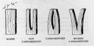

It is not normal. It is a sign of case hardened lumber - a drying defect.
You can perform a simple test to see if it is case hardened. Cross cut a 5" to 7" wide board, and then cross cut it again so you have a piece of the board about 1 inch "long". Turn it so it is long grain parallel to the bandsaw blade and cut it like in the drawing. Date it and save it for your lumber rep.
It could be they don't know, or hope you don't know. Either way, it is to be avoided.
