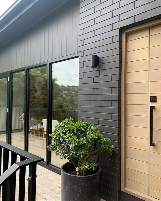

First time posing here. I am used to building historically appropriate rail and stile entry doors. That is my bread and butter... but more recently I have had inquiries on more modern designs, which more or less require vac-press lay ups on exterior grade sheet substrates. I am thinking either extira or marine grade fir with the edges and ends capped in hardwood before the lamination.
One that I am going to do involves a sort of "ship-lap" look to it on each face. I plan on laminating 3/8 thick hardwood (white oak) to each face with west system epoxy in my vac-press, widebelt sanding the face flat, then routing the 3/16 deep grooves into the face at the joints to create the ship-lap look. Has anyone had any experience on this type of door construction? Will there be problems with the boards splitting since it wont be allowed to float like it would in a rail and stile door?

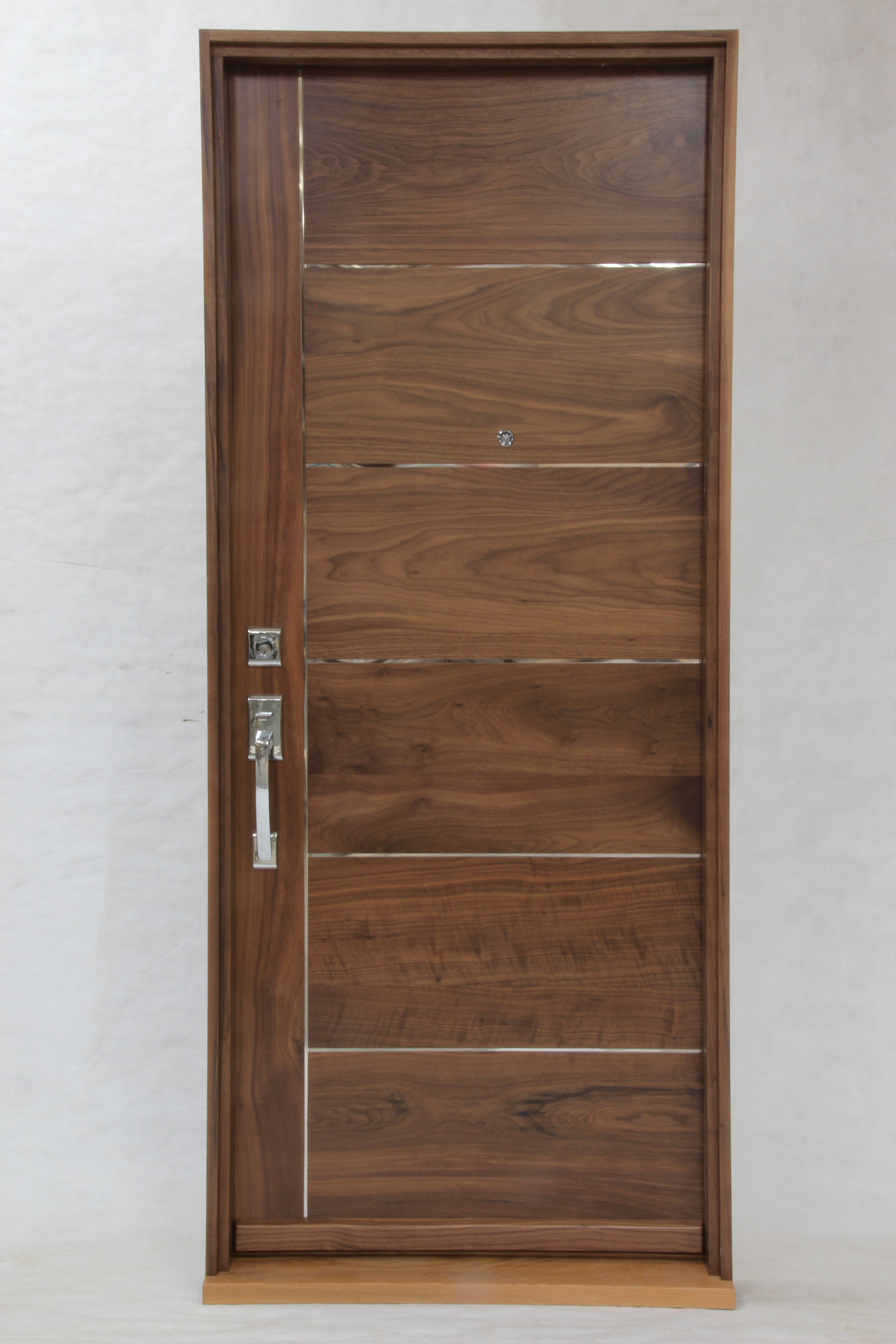

Hi Mark,

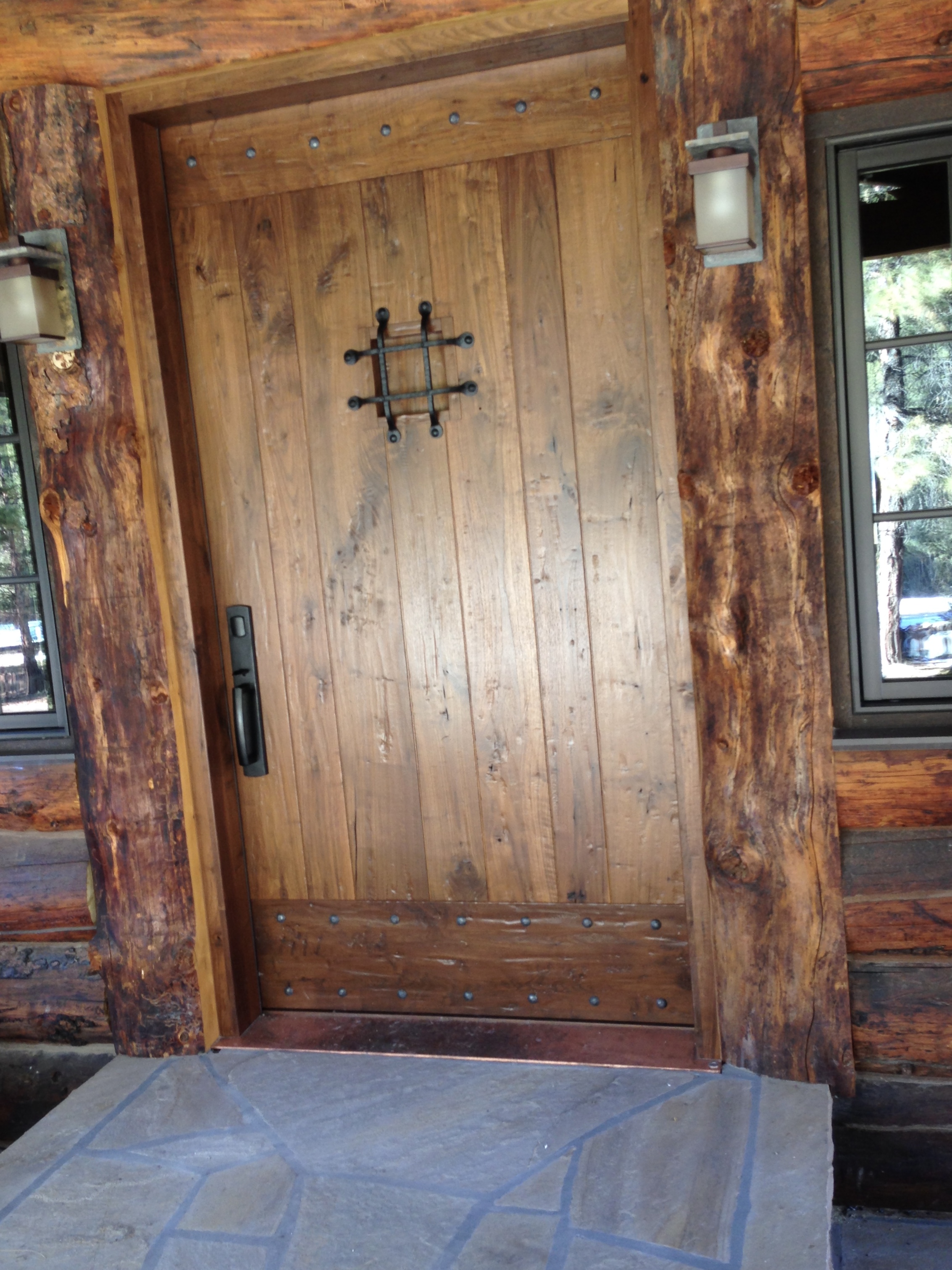

It depend on type of gap we have need. We do prefer to prefinished the inset if we can. That way if we have a bit of movement with the seasons it does not show. Sometimes we have metal insets in the core. Attached is a picture of a door I was worried about wide 3/8 thick boards boards are overlapping the inserts. The boards are way wider than we are comfortable with and flat sawn material as well. This door was build 9 years ago and we had on problems with it.
View higher quality, full size image (3456 X 5184)

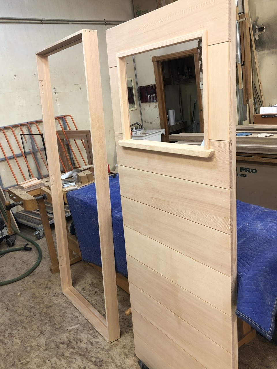

If V grooves are allowed I usually use solid wood for this type door with the cladding over a ladder frame. The walnut door is 5/8” T&G over a ladder frame both sides. Cladding is glued to the frame but they are not glued to each other so each board can move. Most of our doors are euro rebated so no issue with air leaking through the v grooves. For a conventional door I would make a small rebate around the door edges to allow the gaskets to sit to a flush surface.
The fir door in the picture is a outhouse door I built for my son’s yurt. It is one side clad over a ladder frame. No worries about air leaks on that one. It has held up well for 3 years at 11,000 feet.
I would never use MDF for a door core. I would like to try Tricoa for a moder door core but difficult to source here,
View higher quality, full size image (2266 X 3022)

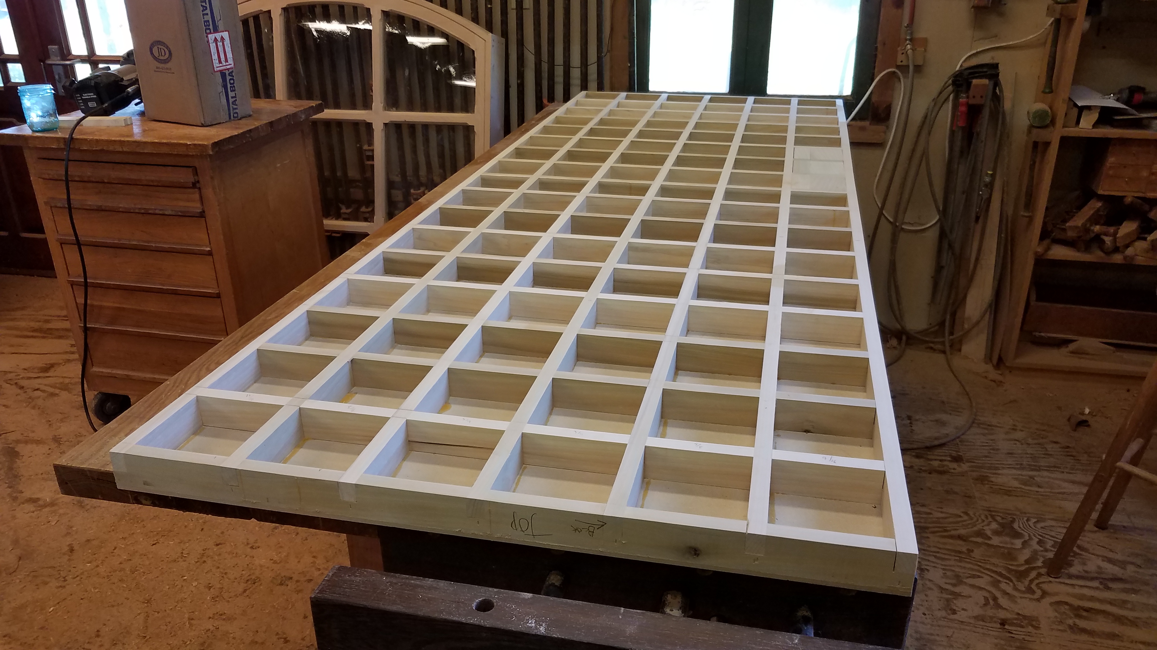

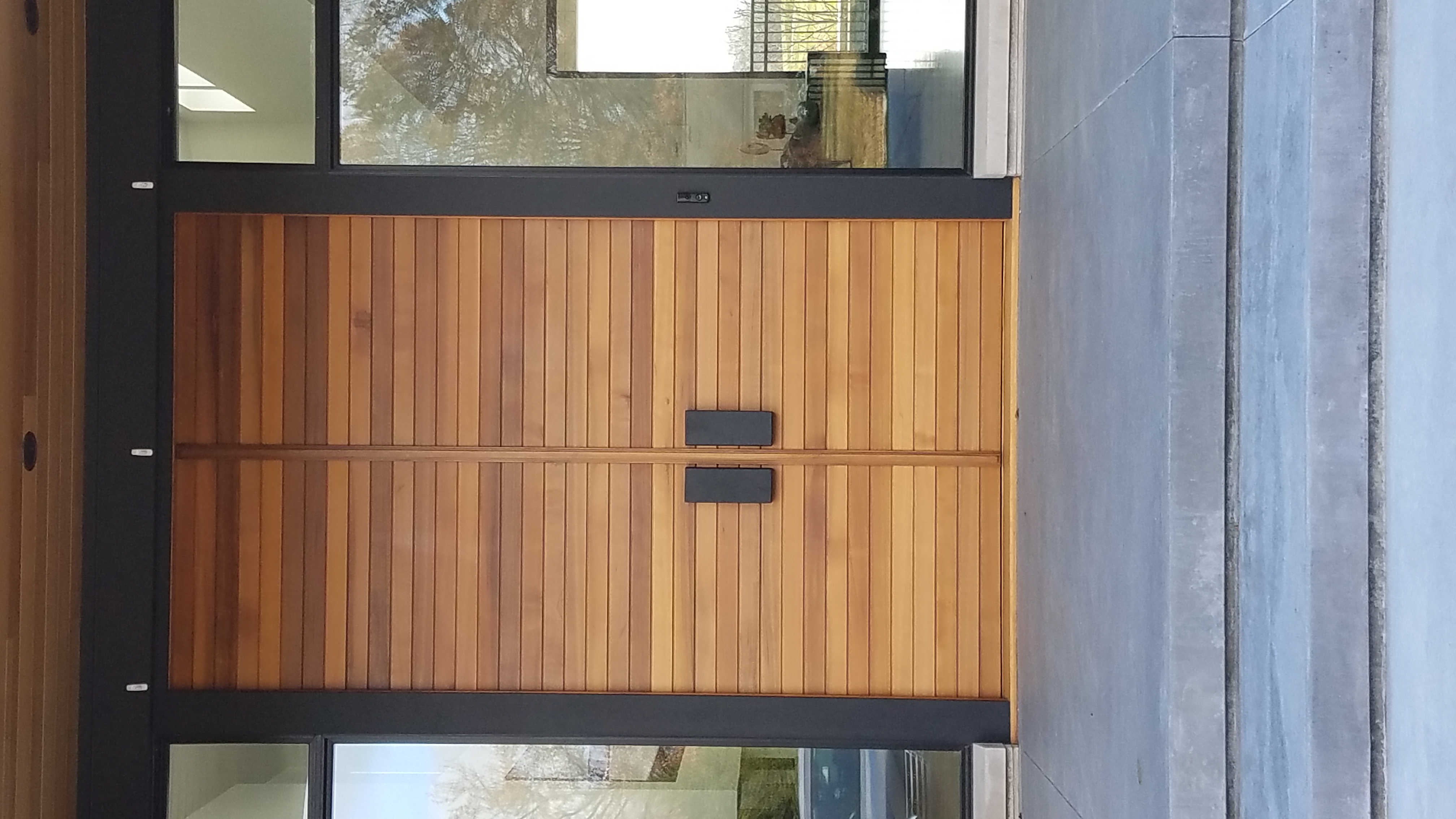

We first build an egg crate core, then skin it both sides with 1/4" exterior rated MDF or ply. We add blocking for latches, and edge band the vertical sides.
The cedar face parts were all shiplapped, and laid with a strong 1/32" gap between pcs. The were not nailed, but glued in place. Identical on both sided. These doors were about 10' tall, and 3" thick. Hung on Tectus hinges for the bit of adjustment they provide. We aded two lines of bulb type weather strip to the vertical sides and top, with bronze interlock at the sill.
