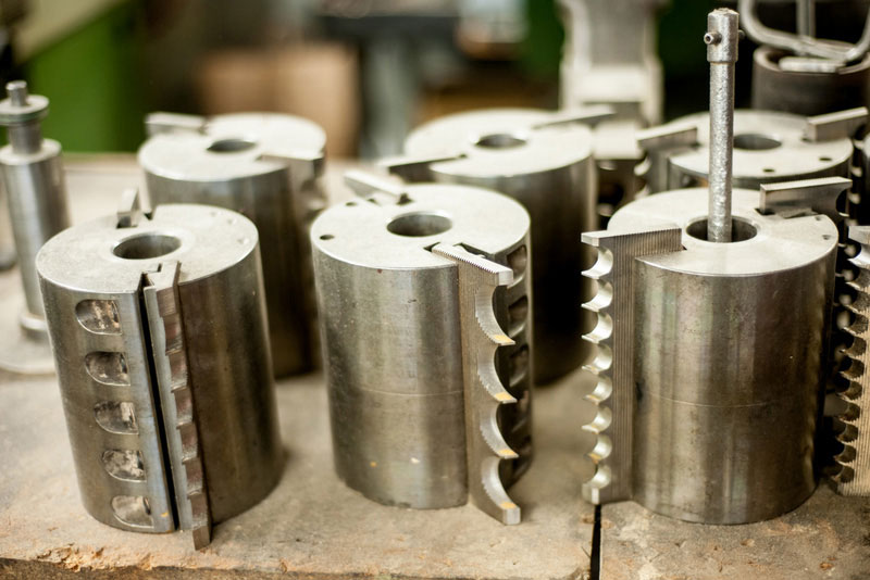

Hey Dave, Whitehill makes stock dowel cutters in many diameters for limiter heads. If they don't make stock what you're looking for, they certainly could in HSS for limiter heads but also they can tip the HSS knives in carbide for longer life if desired. Custom could be had in any number of their limiter blocks, but also for corrugated/serrated blocks.
Various Dowel Cutters
