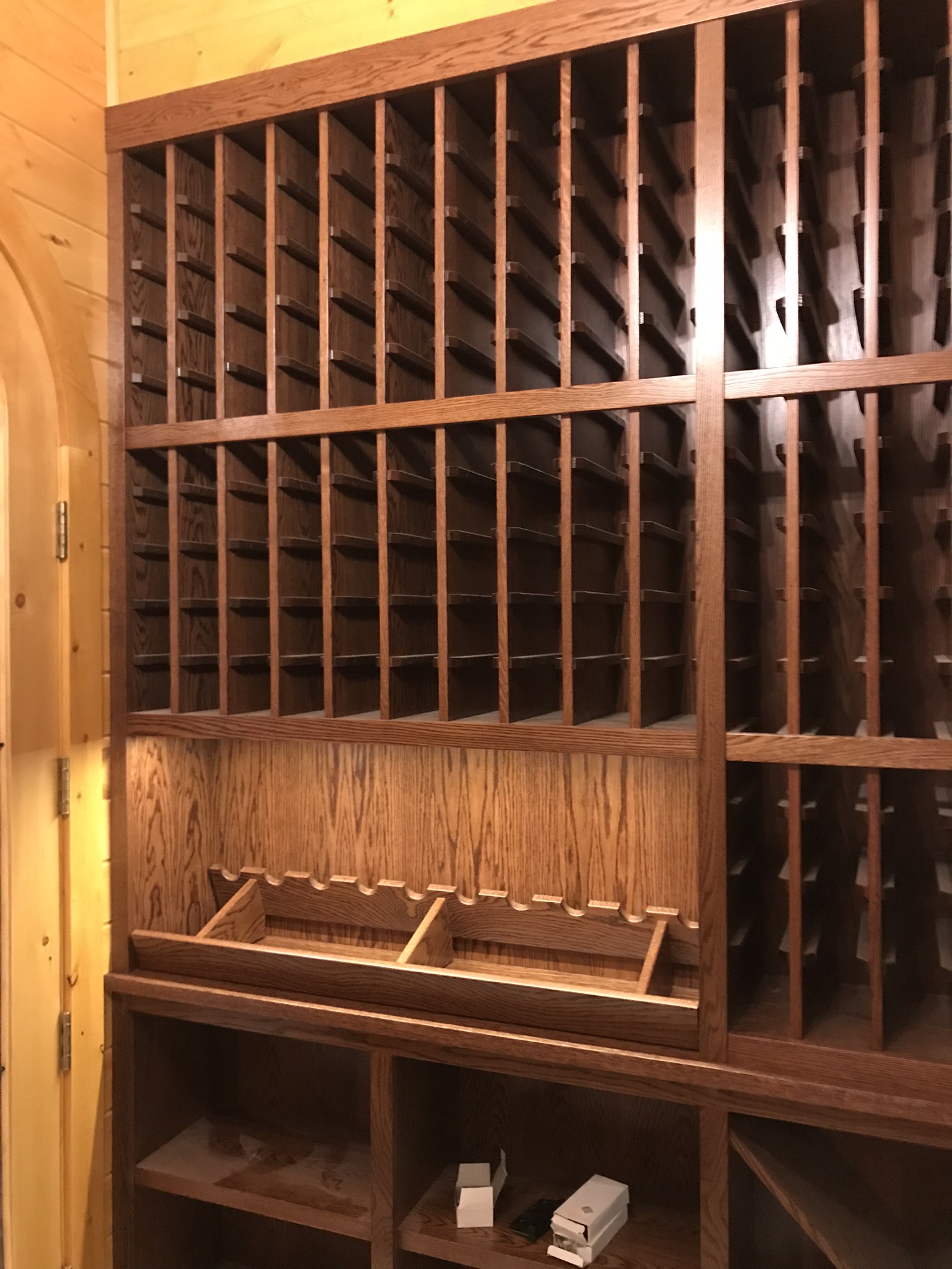

The picture shows one we did that was quick to make. Prefinished all the parts in oil polyurethane, then assembled. Red oak is the wood.

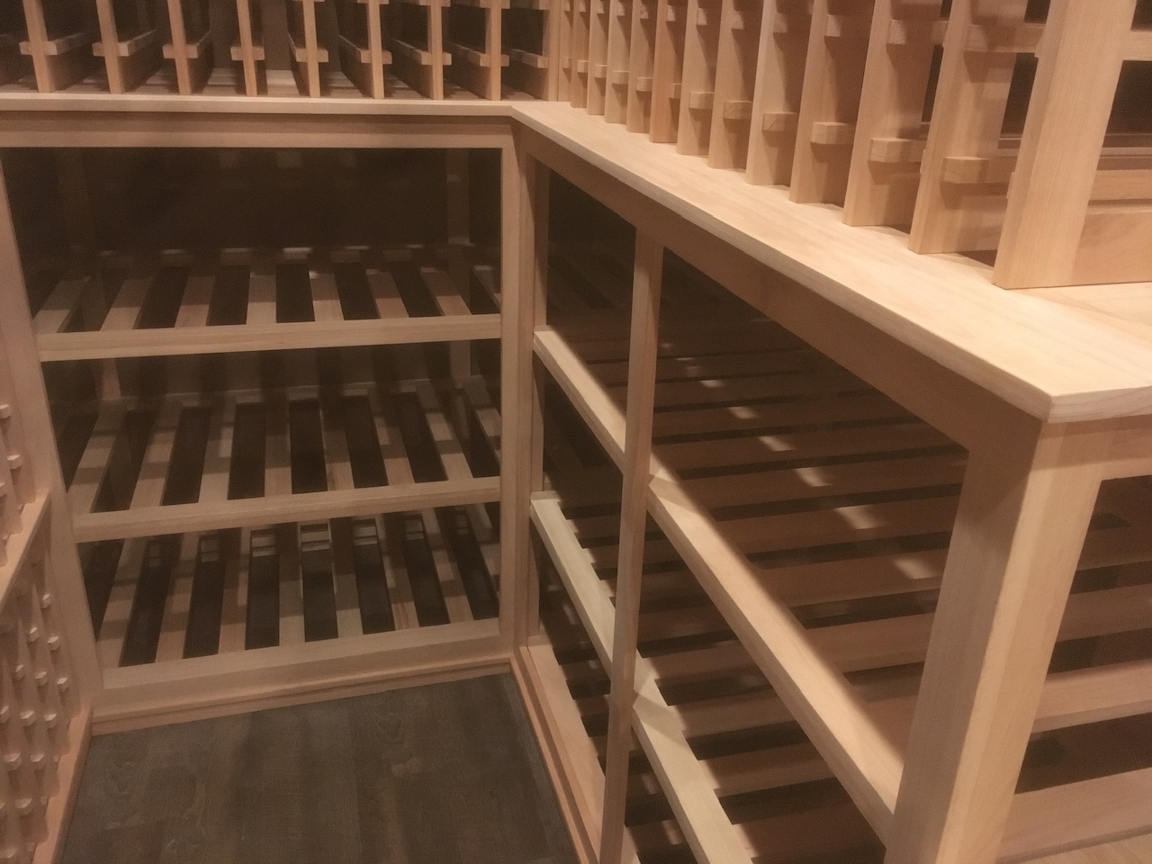

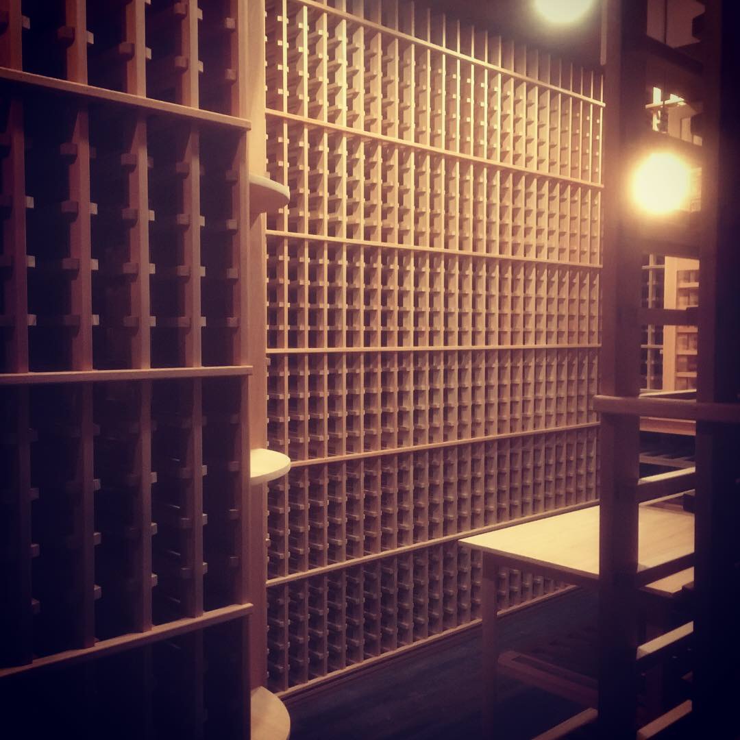

We used polpar for one with a stain and cherry for the other. 600+ bottle wine cellars with decanting station. The wood has no problem with whatever humidity control you have. End of story.
1/17/23       #26: Is there a more cost effective wood ...
Dave Edgerton  Member
Plus glue and 16 ga pin nails on the frames. There will never be an issue with humidity affecting the nails.

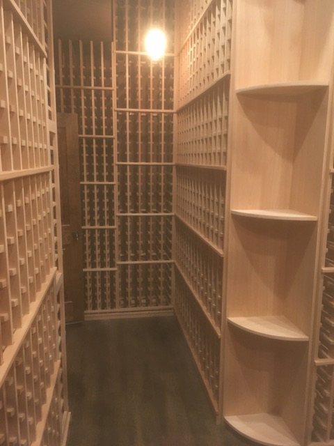

If you have a supplier in your area, check out Red Grandis. It’s a plantation grown species that is more affordable, very easy to work with and doesn’t have any issue effecting the wine.
this photo is my one and only true wine cellar. The contractor had another shop build the exact same layout using redwood (not commonly available in our area) and they pinned with 18 gauge. To maximize storage, some of the rows are double depth and flexed with the building techniques they used. After several bottles were broken trying to load the racks, they decided to tear it out and I was brought in to replace. My method included using glue on each joint and front and back horizontal pieces that had dados to keep everything aligned. I also made full height spacing jigs bc the height of the units compounded any slight variations of using a single spacer that was transferred to use for each opening.
Also, I underbid this job in material and time. Breaking the edges of each horizontal piece is fine when it’s a few hundred, but when it’s tens of thousands, slight miscalculations add up. I did not use any finish, but gave the client an option for using a formaldehyde free CV with the disclaimer that I wasn’t responsible if it effected the wine. Like any new project that’s outside your normal work, you just need to do more research and be prepared to pay a little “stupid tax”.

Dub
View higher quality, full size image (1080 X 1080)
2/3/23       #28: Is there a more cost effective wood ...
Dan Hahr Member
Very nice. What wood is that?
Dan
3/29/23       #29: Is there a more cost effective wood ...
Chippy1987 Member
Wow @Dub, that is some impressive work!
