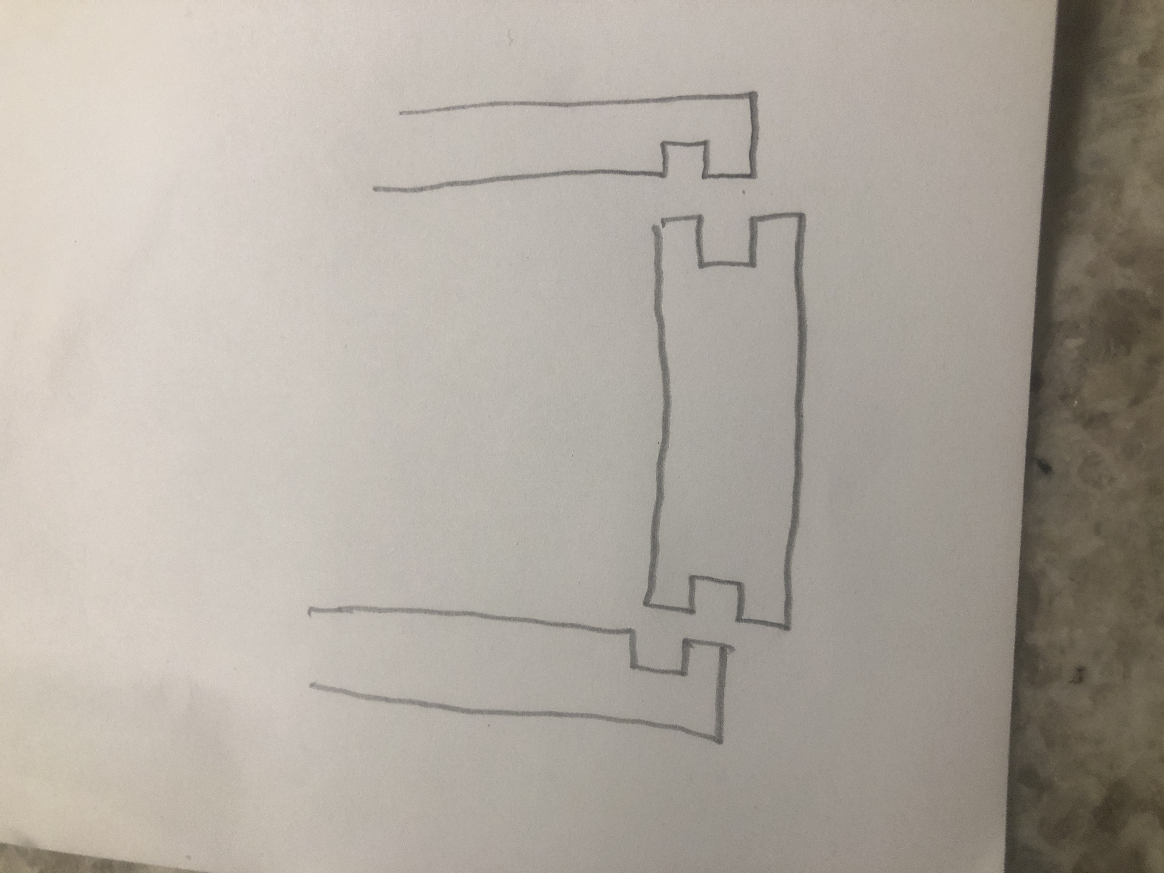

I've got a false beam job. These are 7"w x 11"t x 20' on a raked ceiling. Material is knotty baltic pine the lengths are 20'. They have a typical 3 14" crown covering the ceiling joint. The ceiling is 1 x 6 baltic pine v-board. My question is what joint would you recommend on the bottom of the beams? The pieces are long and heavy enough that they will have to be put up in three pieces. Therefore miter folding/lock miters are not an option. So that leaves either a flush butt joint or a set back butt joint. Also how much set back? I plan on fasten a few blocks inside to locate the bottom. This will be a glued joint no visible fasteners. There are (6) of these landing on a false ridge beam 9" x 15" x 32' and on a regular sheetrock wall.

Matt calnen
See picture

Matt,
I think you drew that incorrectly. It's typically done with a dado in the sides as drawn. The bottom is rabbeted on the upper face so it sits shy of the sides. You've done it proud.
My question was more about what you guys think about flush versus recessed bottoms from an aesthetic stand point.

Matt Calnen
In my neck of the woods, we call that a quirk corner. You can also take some off the top edge of the bottom to make the fillets equal. Just another way of doing it.

Matt,
That’s really interesting. “Quirk” is the UK term for the 1/4” reveal of the jamb when you case a door or window. It’s in a couple of my old UK joinery books Never heard it used in the Northeast. Where are you building quirk beams?

I would add a bead on the two lower long edges. A large bead at 1” or 1-1/4” would be appropriate for that material. Remember, when completed, the beams are to be solid, not hollow. Large beams were not decorative, but the lower edges were sometimes dressed up.
Depending upon thickness, the bead can be part of your two pieces or a third piece tongued into the two adjacent parts.
A chamfer would also be appropriate. Then you can figure out how to stop it.
Run all your parts on a shaper with a feeder, and shop fit and pre-assemble when and where appropriate. I like to supply frames to serve as full length blocking. Makes install go fast.

I came to the same idea earlier in the week.
I ended up beading the sides & routing a rabbet that removed everything but the bead & 1/16” groove. The bottom pops in and locates 1/32+ proud of the beads, so we can sand if necessary after install. The beads also help to protect the edges. Baltic pine is fragile.
I hadn’t done that method for about twenty years. I think it will look really good.
