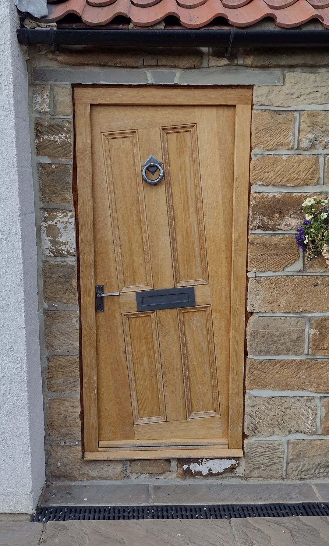

I read Dave's book and made my first entry door

That is too funny. No reason you couldn't do this, but as I look at this pic, my brain keeps saying "that's not right".

Looks like some places in Old Town Alexandria, VA.
"The old guys really knew their stuff"
Yeah, right.

Doing this with a little more intent, could be really neat.
(In the right setting...)

Pat - I suggest a more thorough reading. I feel you may have overlooked a few details.
What is really important is did you use a real mortise and tenon, or biscuits or loose tenons?
Otherwise, it is good to see your sense of humor is in fine working order.

My wife just walked in and said "geez, it looks like all the doors in my parents house !"
Her father's motto (or at least what we say it should have been) was "why use a little screw when a 16 penny nail will do !"

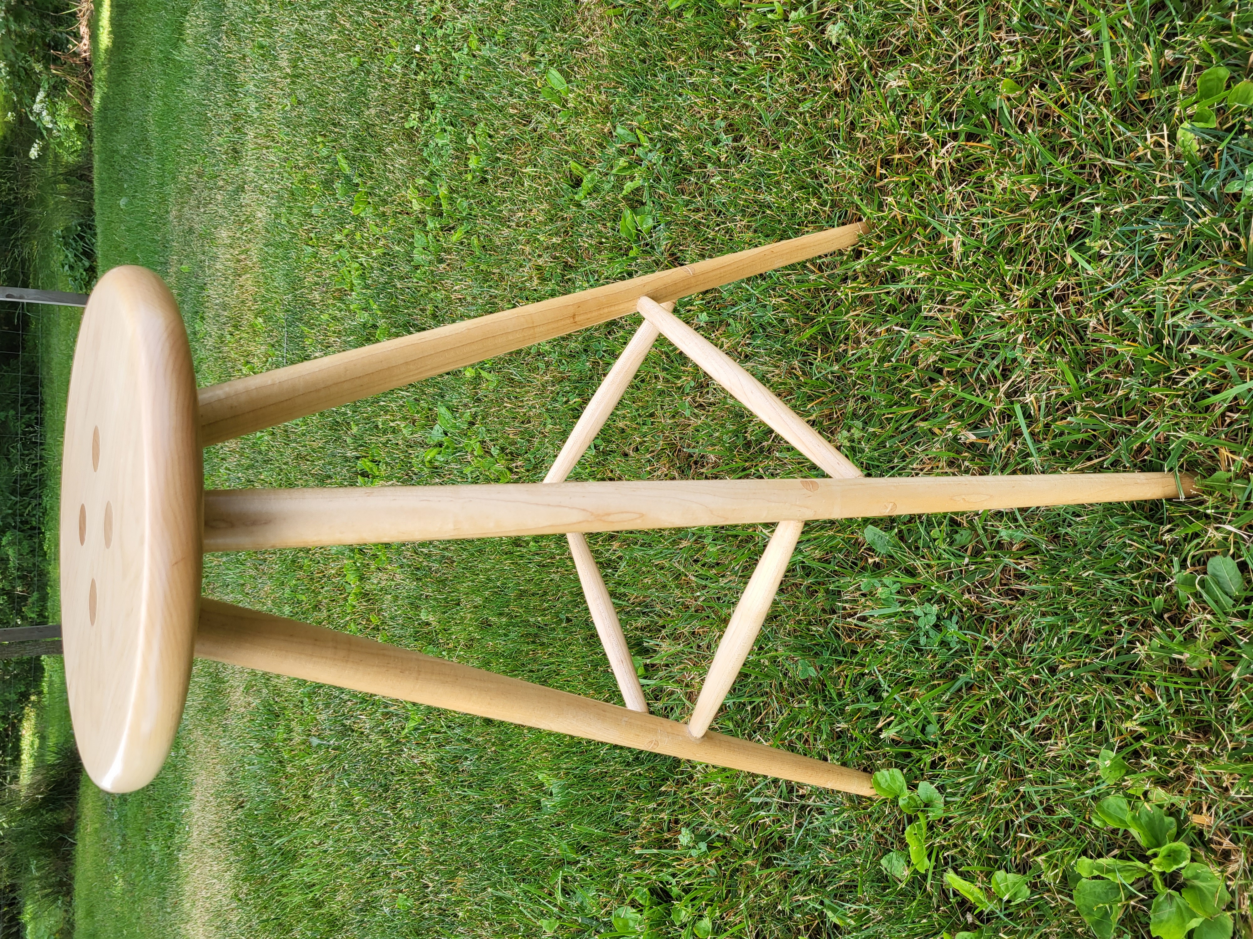

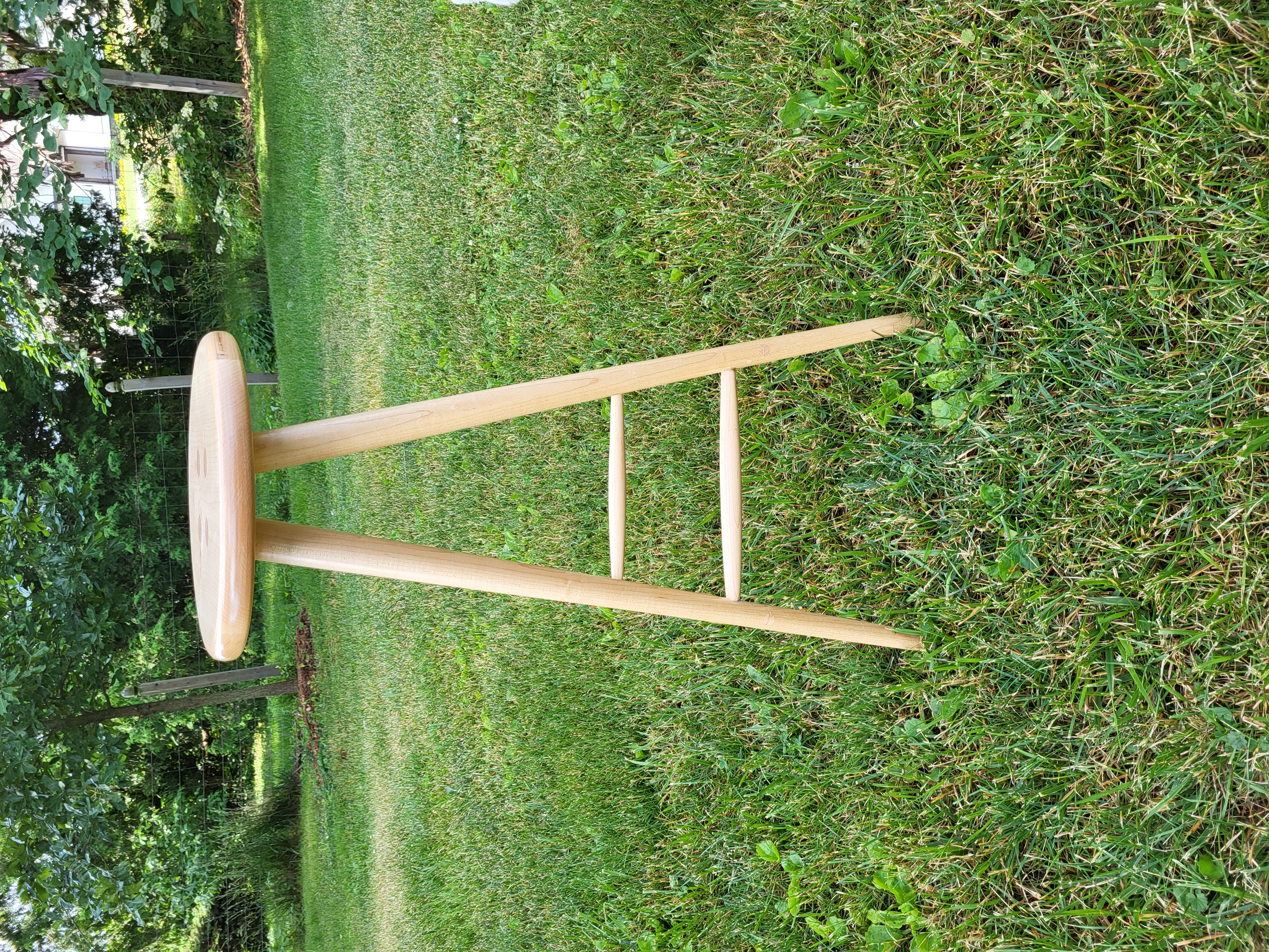

This is my latest project. I developed all the jigs and such to do some batch building.
It is a robust design, supports 300 lbs easily, but weighs only 5 pounds. One is a more traditionally rung layout, the other is a bit more playful. Hard Maple, or Sugar Maple, or Rock Maple, or White Maple, or…..
Now, I have to find a way to sell them.

What you did with the stretchers is interesting

The traditional rung layout requires two drilling patterns; two of one ‘direction,’and two the other ‘direction’. They are hard to keep straight which is what, both before, during and assembly. Get one wrong, and…..
So I was thinking - retirement offers such luxury- about making a design where all four legs have identical drilling layouts. Once I realized it could be done, I played with it a bit, allowing one rung to join the leg at 90 degrees, and hit other leg as it will. This gave it more of a whimsical look, or disorienting, according to my life partner/live in critic. But, I like it.
The photos are compressed on my IPad - the stools are much more graceful, at 30” tall, with a 12” seat diameter.

It looks great, FWIW I hear some younger guys have success selling their stuff on Etsy

Have you encountered any challenges or difficulties in assembling furniture with the traditional rung layout? It can be frustrating to keep track of which direction each drilling pattern should go. I can see how having all four legs with identical drilling layouts would simplify the process and reduce the chances of making mistakes. Have you found that the new design with the whimsical look makes it easier to assemble?

Yes, certainly easier to drill, and assemble.
The design is still evolving, and I am making all the jigs more robust and easier to set up.
