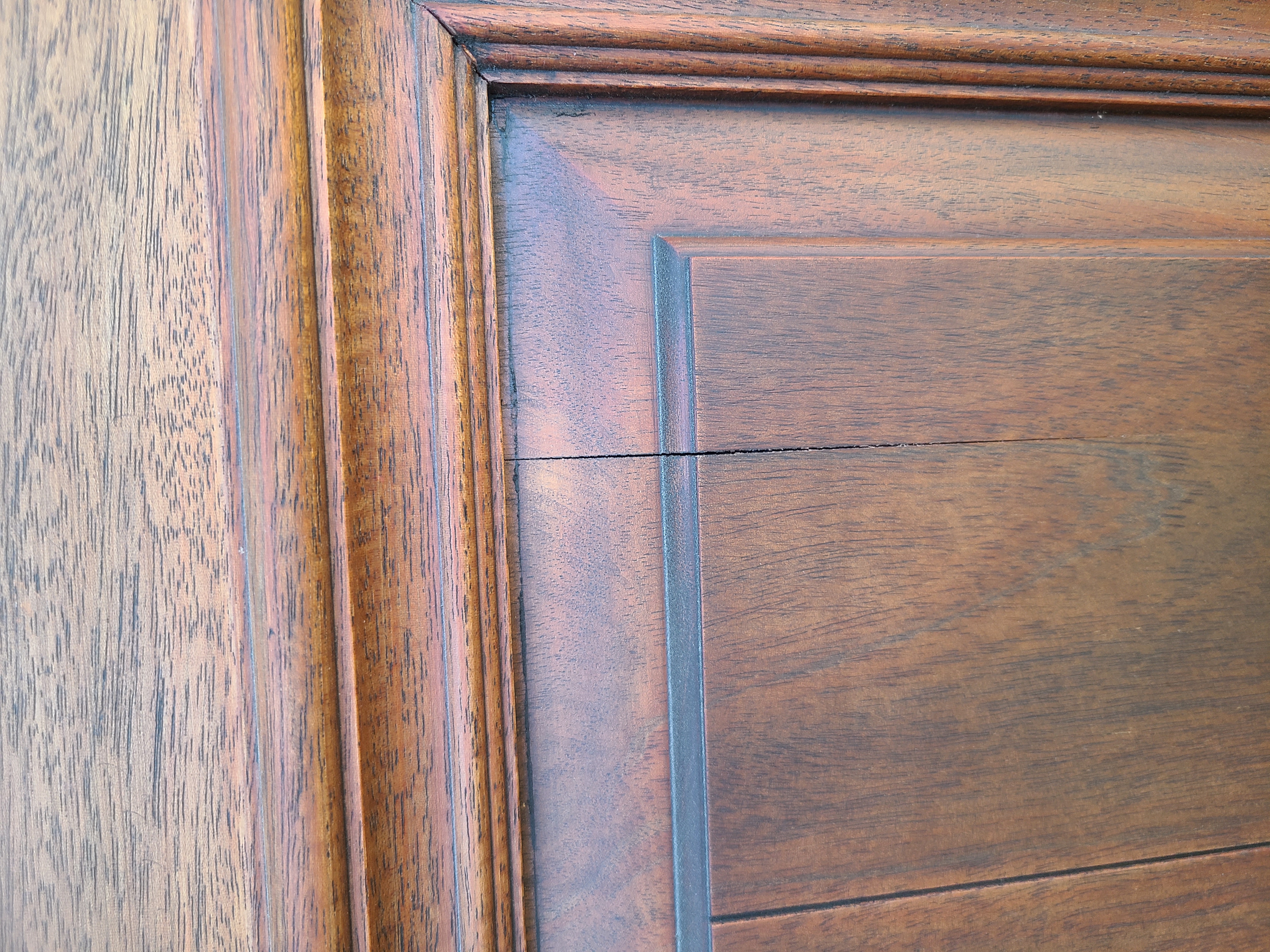

So there's been lots of discussion on this forum about cracked panels on exterior wood doors, and interesting ideas and methods to solve the problem. Apparently I need to pay closer attention. This is my first failure.
The question, then, becomes, has anyone had any success, or have a method, of fixing the cracks, aside from replacing the panel itself?
The door in question is 2-1/4" thick, with two 3/4" panels separated by rigid foam. The panels are held in by bolection moulding, so they can be removed if necessary. The panels are glued with TBII.
What I'm wondering about here is peoples successes or failures when it comes to field repair.
Thanks.

I don't think will get a repair that will be satisfactory over time. You could fill and paint in a great stain match but that glue joint is prone to failure. My opinion is to spend the time and effort removing and replace/repair the panel. Bummer I know but it would be worse to have to do it a third time.

1. There is no successful field repair other than replacement.
2. Titebond III glue is the worst glue ever foisted on the hapless woodworker.
3. 7 ply panels as detailed in my book "Small Shop Production of Custom Wood Doors" is the best and only solution.

Just a shot in the dark, but would it be possible to remove the panel, rip it with a thin kerf and reglue? a well-tuned bandsaw and a hand plane wouldn't remove much more than 3/32". Or maybe a thin kerf track saw?

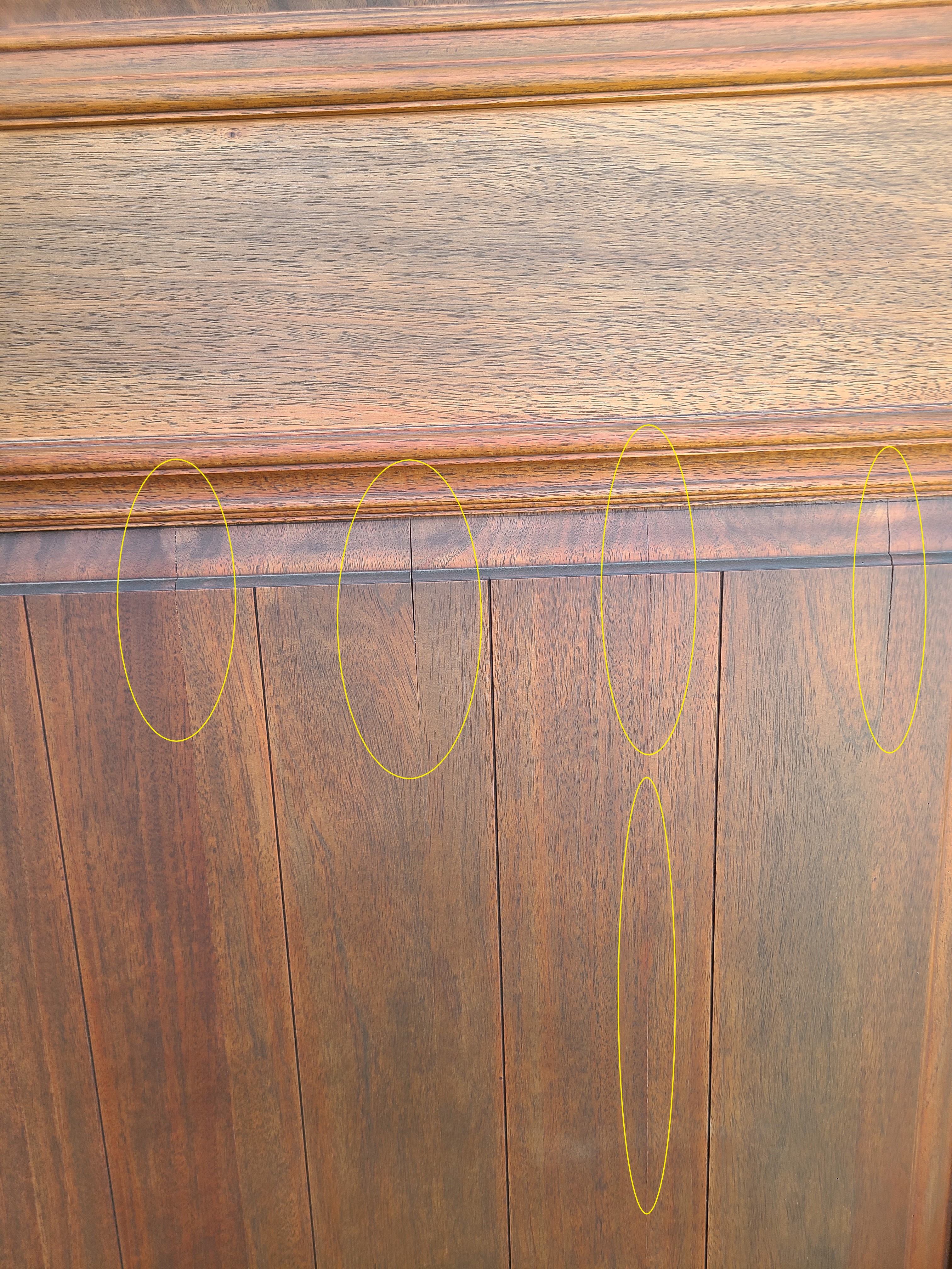

Unfortunately I don't think that will work. Further evidence points to a larger problem, which leads me to believe that I'm looking at a process error. Most likely the wrong glue.
I'm not of the opinion that all the glue joints on a panel suffering from weather stress should be failing at the same time. You would think a stressed out panel would fail at one joint and then be relatively stress free? This panel appears to be failing all over.
