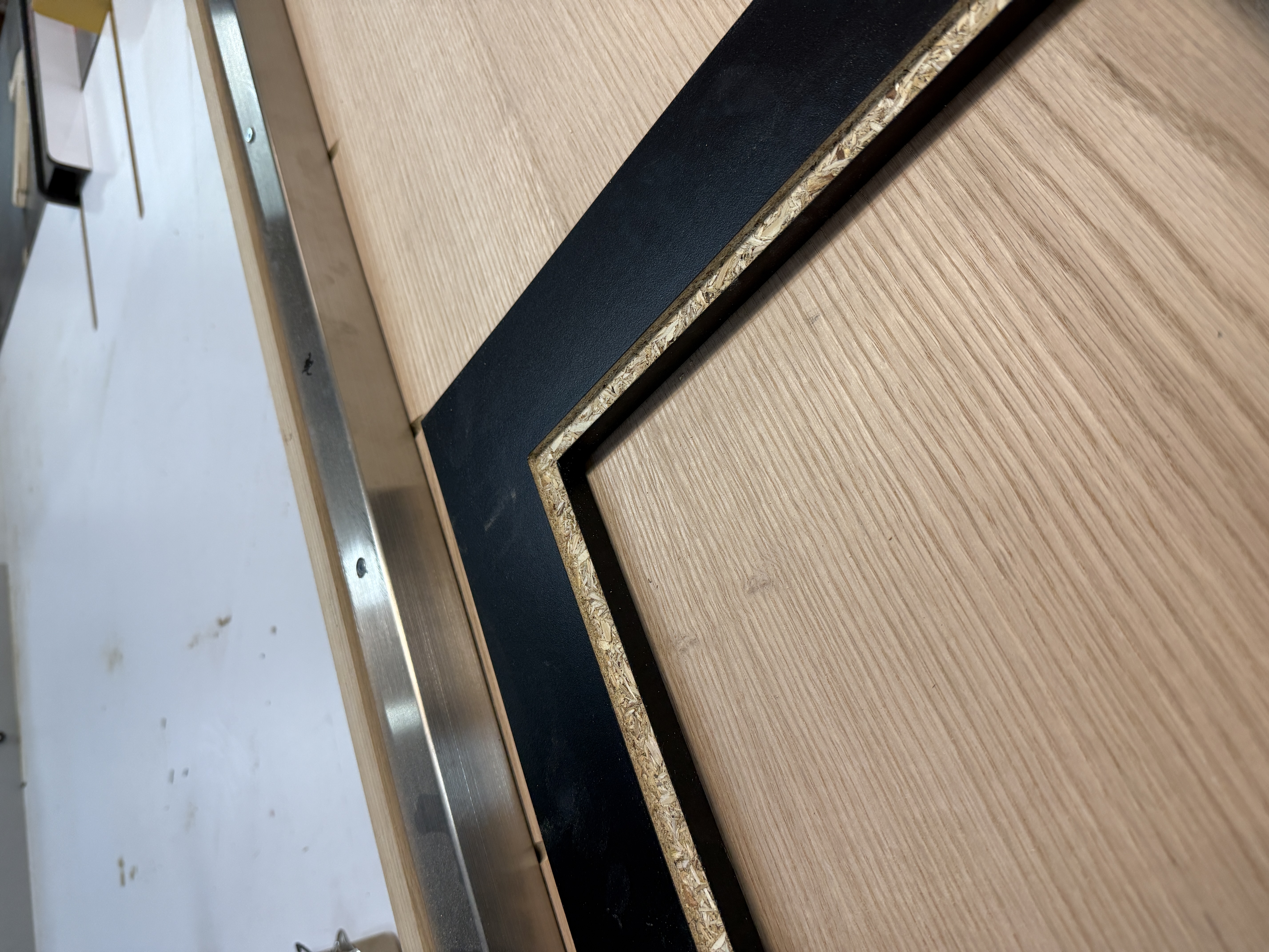

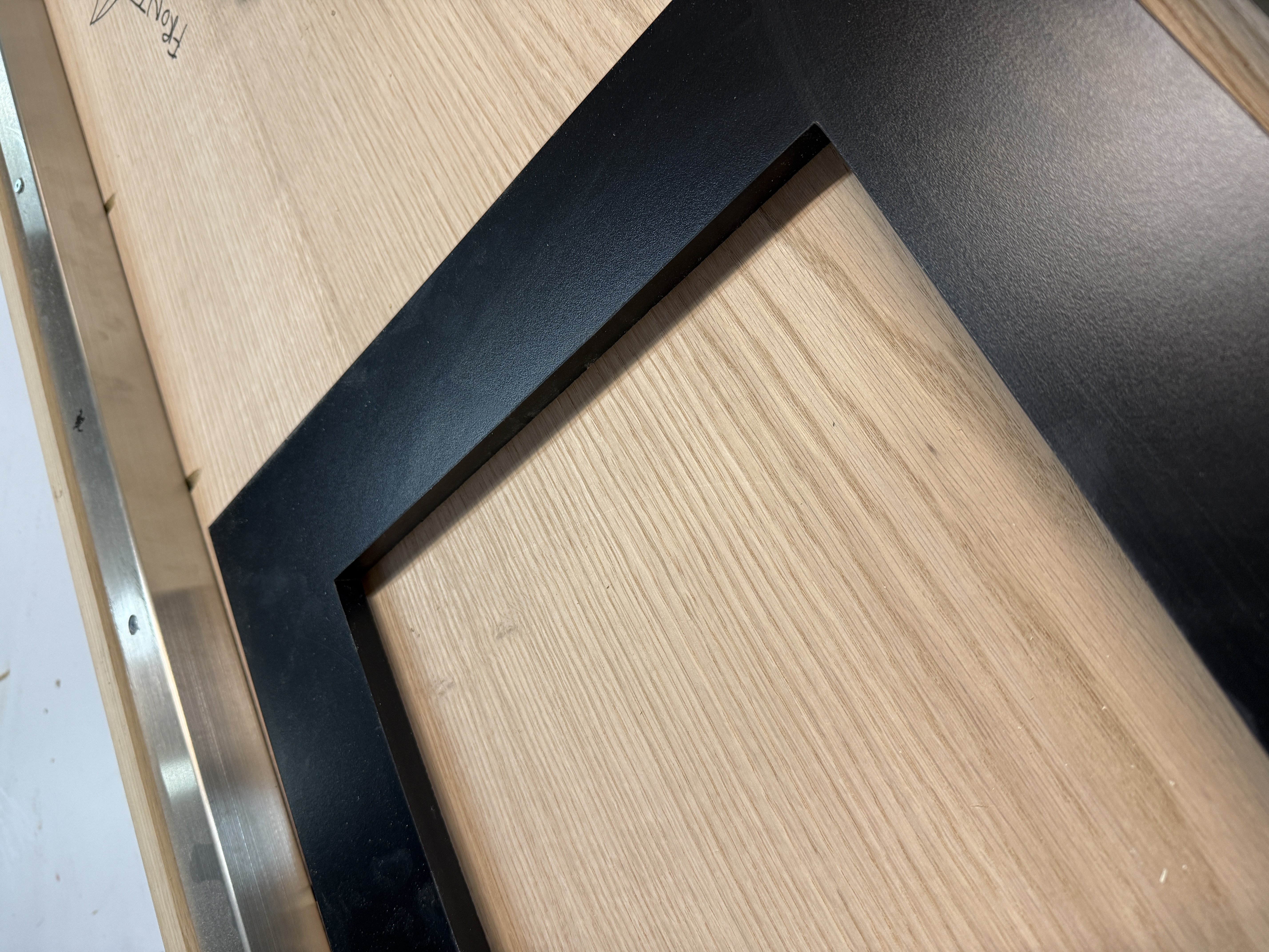

Does anyone here have any tips or tricks to reduce the amount of time it takes to hand band the inside edge of the "stiles & rails" of a laminate door cut for glass (see pics)?
Currently we have having to tape of the face and back, spray glue, measure each length, cut banding, add banding to edge, hand trim face and back, etc.
Any ideas to save time would be extremely helpful.
