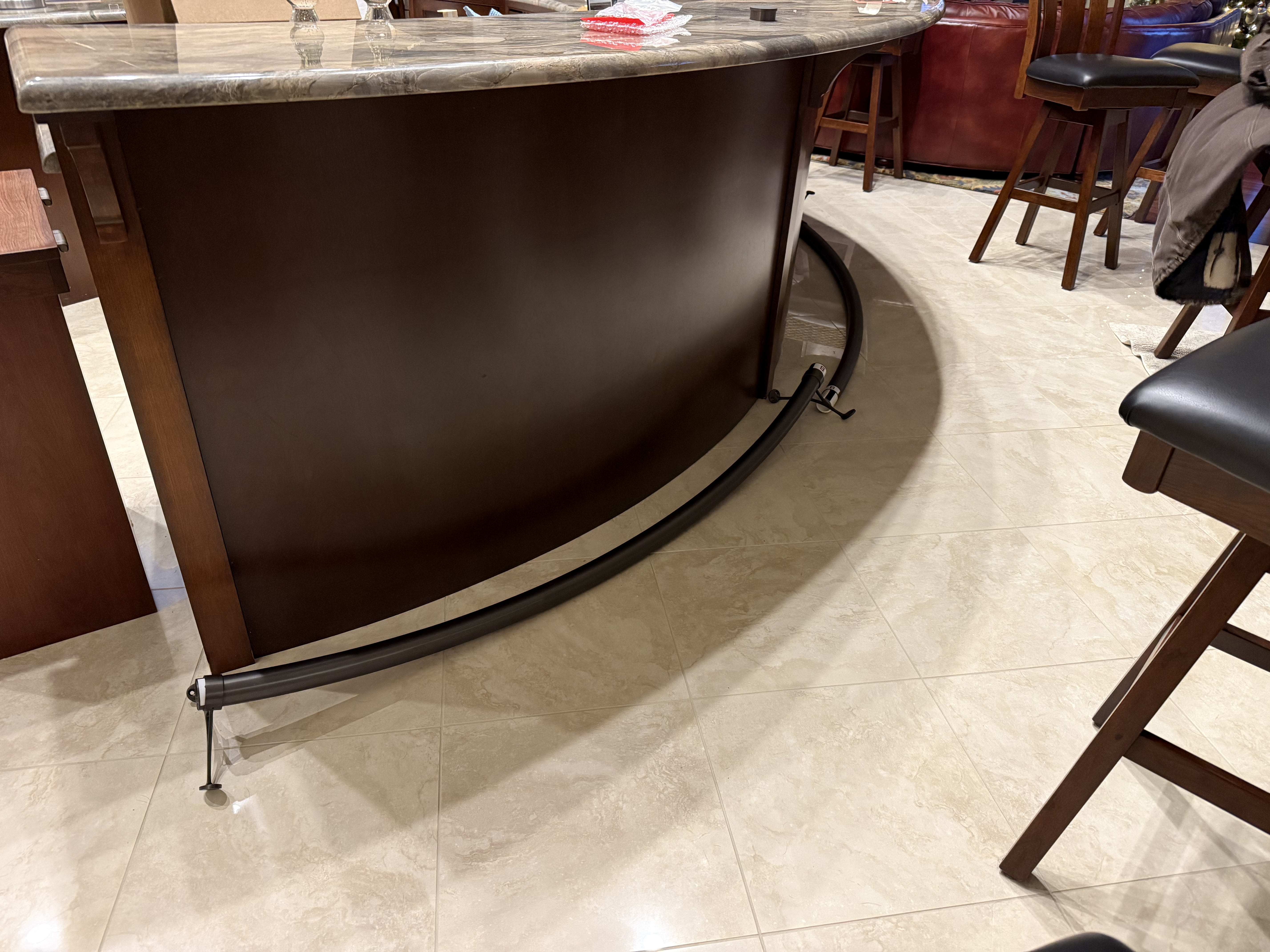

I went to a job the other day where a customer had a big radius wall in the kitchen and they had their countertops replaced. The countertop company I’m assuming used some type of laser device to measure the radius of this big wall, so the customer could order a curved foot rail to go around it.
Is there such a laser that will measure the radius of a wall, whether convex or concave?
Links?
Also, how would you use this device to be able to tell the overall length of the radius? Here’s a picture of the wall they bought the foot rail for.
I know how to find a radius by putting a level/straight edge against the wall and then finding the points lemgth/height of the chord, but I would think a laser would be much more accurate. I would assume there may be some markers they put on top of the wall and then snapped points along it to transfer the data into what the radius of the wall is and also figure the overall length of the wall as it goes around the curve.

It looks as if anyone is doing this, they are not sharing.
I have my doubts that it is possible, but then, I am far from comfortable with the digital side of things.

The Leica iCON iCS would probably do what you need.
https://shop.leica-geosystems.com/global/icon-trades/ics/overview
