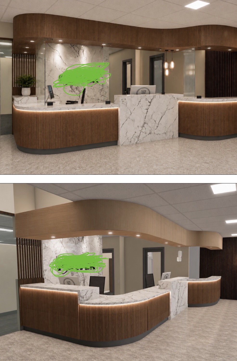

Hi All,
Looking for ideas on the best way to make this white oak veneered bulkhead.
Size is 15’ x 24’ overall, 20” high x 21” deep.
It’s suspended from web trusses above the grid ceiling so we are going to frame it with steel and wrap that with plywood for the veneer to glue onto.
Due to the overall size it might not be feasible to shop build it without having multiple seams which could be difficult to join together on-site.
One option is to use pre-finished paper backed veneer, contact cemented to substrate. Veneer sides first, then bottom. I recognize that getting good seams will be the tricky part- especially since the veneer will be prefinished and won’t be able to fill and sand joints- most likely just a wax filler.
Alternatively, perhaps the bulkhead bottom could be prefinished 3/4” veneered mdf, panels cnc cut to shape , joined with draw bolt connectors on-site and lifted and fastened to framing. Curved wall sections could be pre- formed in shop and set on top of the soffit bottom, joint sanded smooth then the side veneers applied.
Open to some brainstorming here. Thank you

I would want to make all the vertical panels in house to a finished state. Prefab the bulkhead framework in six sections with the vertical faces attached. Register with dominos, dowels, splines. Bolt sections together on site. I would then attach the horizontal light panels after installing the rest. Don't ask me how but you appear to have some access from the non public side.
Rift white oak can be forgiving for seams.

Hi Tom, thanks for response. Yes, after talking with others the consensus is to build as much in shop as possible and to avoid applying veneers on site if possible.
I think dividing it into sections and engineering locating dowels or dominoes and draw bolt connectors is the way to go.
