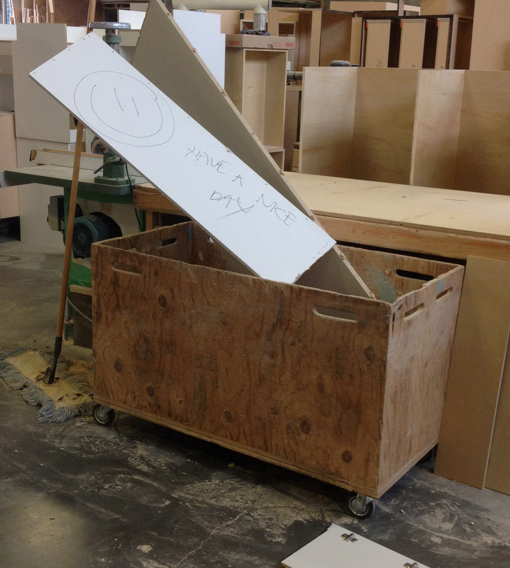

Who doesn't enjoy trash talk?
I am interested in any sort of cognition that anyone has ever had over woodworking garbage.
Anything you have done to condense it, recycle it, manage it, green it up.
Thanks :)
View higher quality, full size image (1024 X 1139)
