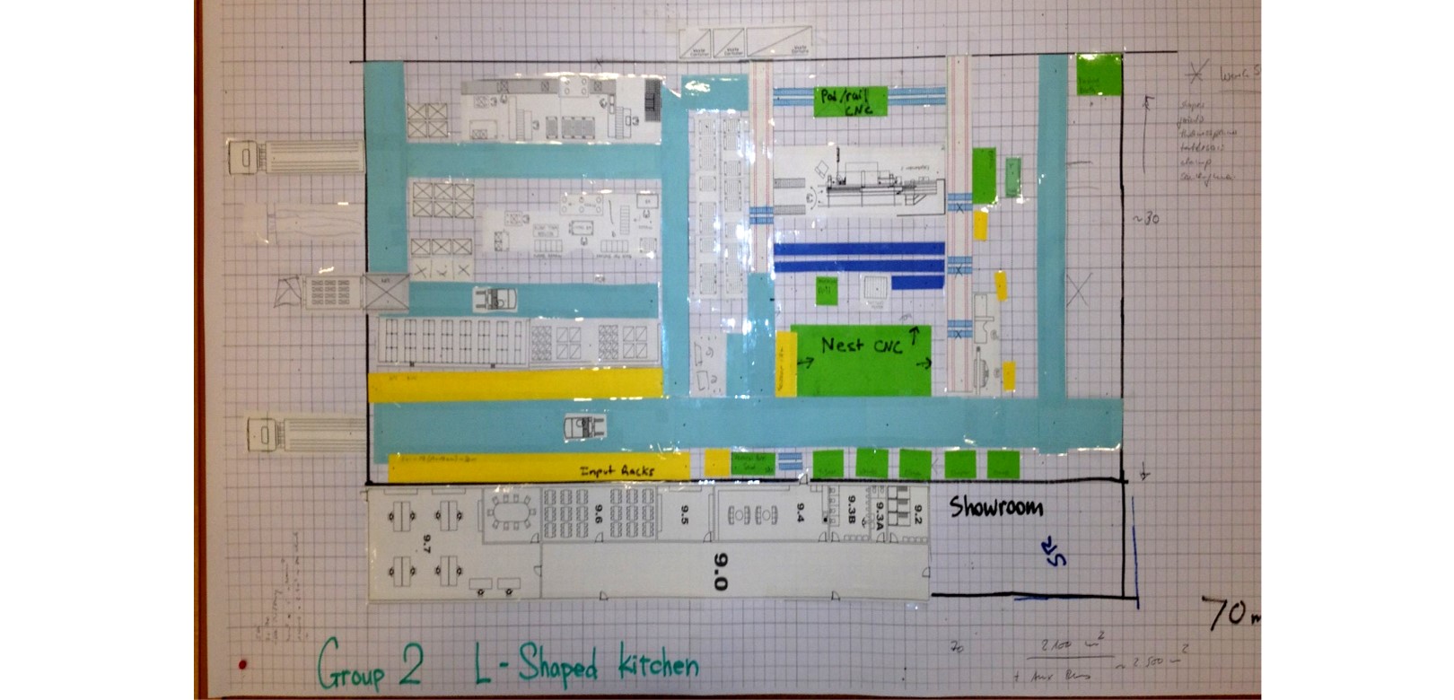

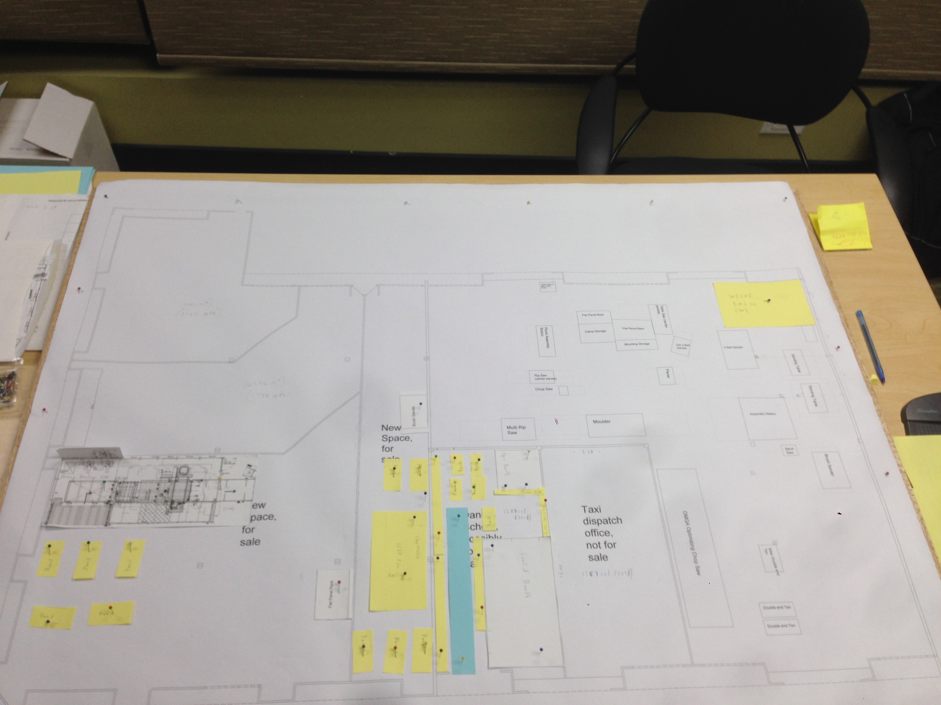

SB Member
The first picture is using the method described up. The second picture is another way we did it once, as i describe now.
We outlined it on paper and put the paper on corkboard, then we pinned the machine cutouts, and when we had a layout we liked, we taped it down. I have templates for all those machines and forklifts etc. you can shoot me an email for them.
View higher quality, full size image (1620 X 780)
