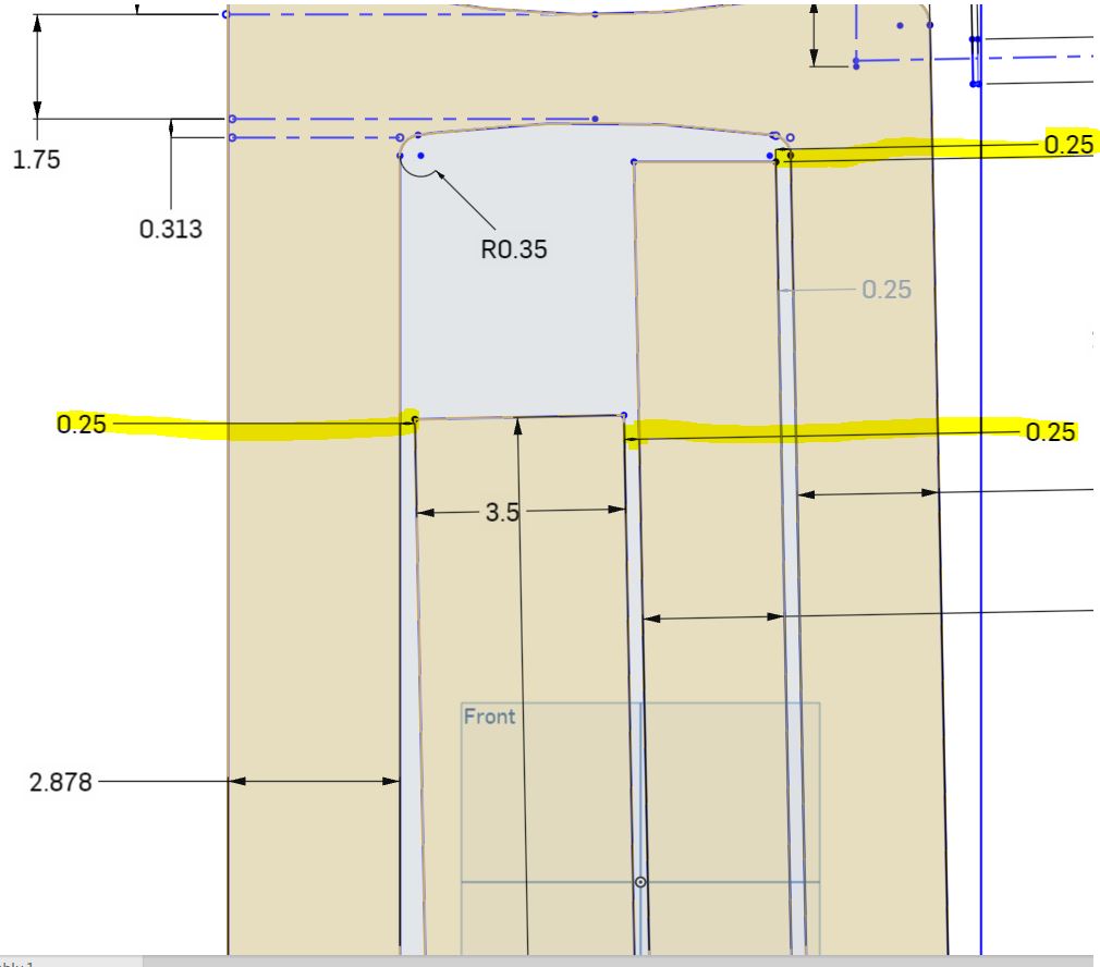

I don't understand why you included that drawing in this post - it adds nothing.

Frenchy, you need to get your mom to give you a hug or something. There is no reason to be snarky.
Miko was correct in posting that drawing. It shows the rest of us that he has given this some thought and basically describes what he is looking for.

Thanks for the responses so far. @Frenchy I was pressed for time & should have explained it a bit. I included the drawing just to give an idea of the types of questions I have. In that example I highlighted the cutting clearance I used, of .25" based off of the cutting width of the blade that was used to cut the last prototype- wasn't sure if it was ok to layout parts, that are to be cut, the way I did being so close together...

Frenchy
If that drawing is any indication, then due diligence is the least of his concerns.
